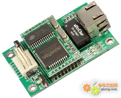

²úÆ·Ãû³Æ£º 485תÒÔÌ«Íø£¬´®¿ÚÁªÍøÄ£¿é
ÐÍ ºÅ£º C2000 E1M1
¸ÅÊö£º
 C2000 E1M1ÊǾßÓиßÐÔ¼Û±ÈÇÒÎȶ¨¿É¿¿µÄ´®¿ÚÉ豸ǶÈëʽÁªÍøÄ£¿é£¬ËüÌṩRS485ºÍTTL´®¿Úµ½TCP/IPÍøÂçºÍTCP/IPÍøÂçµ½RS485ºÍTTL´®¿ÚµÄÊý¾Ý͸Ã÷´«Ê䣬Ëü¿ÉÒÔʹÉ豸Á¢¼´¾ß±¸ÁªÈëTCP/IPÍøÂçµÄ¹¦ÄÜ¡£
 C2000 E1M1ÏòÉÏÌṩ10MÒÔÌ«Íø½Ó¿Ú£¬ÏòÏÂÌṩ1¸ö±ê×¼RS485ºÍTTL´®Ðпڣ¬Í¨Ñ¶²ÎÊý¿Éͨ¹ý¶àÖÖ·½Ê½ÉèÖá£C2000 E1M1 ¿É¹ã·ºÓ¦ÓÃÓÚPLC¿ØÖÆÓë¹ÜÀí¡¢ÃŽûÒ½ÁÆ¡¢Â¥Óî×Ô¿Ø¡¢¹¤Òµ×Ô¶¯»¯¡¢²âÁ¿ÒÇ±í¼°»·¾³¶¯Á¦¼à¿ØÏµÍ³¡¢ÐÅÏ¢¼Òµç¡¢LEDÐÅÏ¢ÏÔʾÉ豸ºÍCNC¹ÜÀíµÈ¡£
ÌØµã£º
¾ßÓÐTCP Server£¬TCP Client¡¢UDP¡¢ÐéÄâ´®¿Ú¡¢µã¶ÔµãÁ¬½ÓµÈÎåÖÖ²Ù×÷ģʽ£»
Óû§»ùÓÚÍøÂçµÄÈí¼þ£¬²»ÐèÒª×öÈκÎÐ޸ľͿÉÒÔÓëC2000 E1M1ͨѶ£»
ͨ¹ý°²×°ÎÒÃÇÃâ·ÑÌṩµÄÐéÄâ´®¿ÚÈí¼þ£¬Óû§»ùÓÚ´®¿ÚµÄÈí¼þ²»ÐèÒª×öÈκÎÐ޸ľͿÉÒÔÓëC2000 E1M1ͨѶ£»
¶ÔÓÚÐèÒª¿ª·¢Èí¼þµÄÓû§£¬ÎÒÃÇÃâ·ÑÌṩͨѶ¶¯Ì¬¿â¡¢ÉèÖö¯Ì¬¿â»òOCX¿Ø¼þ
ͨ¹ýä¯ÀÀÆ÷¡¢ÉèÖÃÈí¼þ»òÉèÖö¯Ì¬¿â½øÐвÎÊýÉèÖã»
µÍ¹¦ºÄÉè¼Æ£¬ÎÞÐèÉ¢ÈÈ×°ÖÃ
Ë«¿´ÃŹ·Éè¼Æ£¬Îȶ¨ÐÔ¸ß
¼¼Êõ²ÎÊý£º
ϵͳ
CPU       8-bit  MCU
RAM       32KB
Flash     32KB
LAN
ÒÔÌ«Íø    10Mpbs
´®¿Ú½Ó¿Ú
TTL/485   TXD £¬ RXD £¬ RTS £¬ CTS £¬ GND
´®¿ÚͨѶ²ÎÊý
У Ñé     None£¬Even£¬Odd£¬MARK£¬SPACE
Êý¾Ýλ    5£¬6£¬7£¬8
ֹͣλ    1£¬2
Á÷Á¿¿ØÖÆ  RTS/CTS£¬XON/XOFF
ËÙ ÂÊ     300 bps ÖÁ115200 bps
Èí¼þÌØµã
ЭÒé      ICMP£¬ARP£¬IP£¬TCP£¬UDP£¬DHCP£¬HTTP
²Ù×÷ģʽ  TCP Server£¬TCP Client£¬UDP£¬ÐéÄâ´®¿Ú£¬µã¶ÔµãÁ¬½Ó
ÉèÖà      C2000ÉèÖóÌÐò¡¢Webä¯ÀÀÆ÷¡¢ÉèÖö¯Ì¬¿â¡¢´®¿ÚÉèÖ㨿ÉÑ¡£©
ÌṩÈí¼þ  ÐéÄâ´®¿ÚÈí¼þ¡¢C2000ÉèÖóÌÐò¡¢´®¿Úµ÷ÊÔ¹¤¾ß¡¢ÍøÂç²âÊÔ³ÌÐò¡¢EDSocketServer.OCX¿Ø¼þ£¬EDSocketServer.DLL¶¯Ì¬¿â¡¢ÉèÖö¯Ì¬¿âÒÔ¼°VB¡¢VC¡¢BC¡¢DelphiµÄʾÀý´úÂë
Çý¶¯Ö§³Ö  Windows 98/ME/2000/XP/2003
µçÔ´ÐèÇó
µçÔ´¹æ¸ñ  5VDC £¬± 5%
µçÁ÷      ×î´óµçÁ÷СÓÚ80mA
»·¾³
²Ù×÷ÎÂ¶È  0¡æ~70¡æ£¬5~95%RH
´¢´æÎÂ¶È  -60¡æ~125¡æ£¬5~95%RH
ÆäËû
±£ÐÞ      1ÄêÖʱ£
