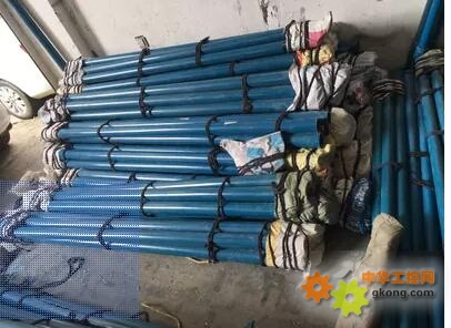

²âб¹ÜµÄÓÃ;
        PVC¸ß¾«¶È²âб¹Ü¿É¸ú¸÷ÖÖÉÌÒµ²âб̽ͷ½áºÏ£¬ÊµÊ©¼à²âµÌ°Ó¡¢±ßÆÂ¡¢»ù¿Ó¡¢»ù´¡¡¢×®¡¢Î§ÑߵȵÄÎȶ¨ÐÔ£¬²âб¹ÜÓë²âб¹Ü½ÓÍ·²ÉÓð¼Í¹²ÛÁ¬½Ó£¬²¢ÓÃ×Ô¹¥ÂÝË¿¹Ì¶¨¡£²âб¹ÜÄÚÓй©²âбÒÇ̽ͷ¶¨ÏòµÄ90°¼ä¸ôµÄµ¼²Û£¬ÒÔ±£Ö¤ÖØÁ¿Çá¡¢¼á¹Ì¡¢ÄÍ»·¾³¸¯Ê´ÒÔ¼°²âб¹Üµ¼²ÛÎÞŤÐý¡£
¡ï Ö÷Òª¼¼ÊõÖ¸±ê
¹æ¸ñ£¨mm£©£ºΦ 53 Φ 65 Φ 70 Φ 90
Íâ¾¶£¨mm£©£º  53    65    70    90
ÄÚ¾¶£¨mm£©£º  43    54    60    79
µ¼²Û¿í£¨mm£©£º 5    4.5    5     5
