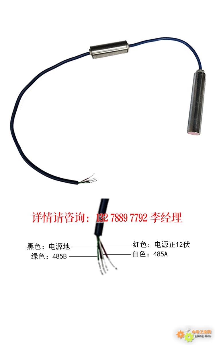

²úÆ·Ãû³Æ£º ¹ú±êmodbus485ͨѶЭÒé¿×϶ˮѹ¼Æ
ÐÍ ºÅ£º XY-SYJ
±¾ÉøÑ¹¼ÆÊ¹Óñê×¼485ÐźÅ,Ϊ×Ô¶¯»¯¹«Ë¾¡¢¼¯³É¹«Ë¾µÈÌṩÓÅÖÊÁ®¼Ûǰ¶Ë²úÆ·¡£
1 ¸ÅÊö
ÕñÏÒÊ½ÉøÑ¹¼ÆÓÃÓÚ¼à²âÑÒÍÁ¹¤³ÌºÍÆäËü»ìÄýÍÁ½¨ÖþÎïµÄÉøÍ¸Ë®Ñ¹Á¦£¬ÊÊÓÃÓÚ³¤ÆÚÂñÉèÔÚË®¹¤½¨ÖþÎï»òÆäËü½¨ÖþÎïÄÚ²¿¼°Æä»ù´¡£¬»ò°²×°ÔÚ²âѹ¹ÜÄÚ£¬²âÁ¿½á¹¹ÎïÄÚ²¿¼°»ù´¡µÄÉøÍ¸Ë®Ñ¹Á¦£¬²¢Í¬Ê±²âÁ¿ÂñÉèµãµÄζȡ£
1.1 ²âÁ¿Ô­Àí
ÕñÏÒÊ½ÉøÑ¹¼ÆÂñÉèÓÚ°ÓÌå»ò»ùÑÒÄÚ£¬ÉøÍ¸Ë®Ñ¹Á¦×Ô½øË®¿Ú¾­Í¸Ë®Ê¯×÷ÓÃÔÚÉøÑ¹¼ÆµÄµ¯ÐÔĤƬÉÏ£¬½«ÒýÆðµ¯ÐÔĤƬµÄ±äÐΣ¬²¢ÒýÆðÕñÏÒÓ¦Á¦µÄ±ä»¯£¬´Ó¶ø¸Ä±äÕñÏÒµÄÕñ¶¯ÆµÂÊ¡£µç´ÅÏßȦ¼¤ÕñÕñÏÒ²¢²âÁ¿ÆäÕñ¶¯ÆµÂÊ£¬ÆµÂÊÐźž­µçÀ´«ÊäÖÁ¶ÁÊý×°Ö㬼´¿É²â³öË®ºÉÔØµÄѹÁ¦Öµ£¬Í¬Ê±ÓÉÒÇÆ÷ÖеÄÈÈÃôµç×è¿Éͬ²½²â³öÂñÉèµãµÄζÈÖµ¡£
ÕñÏÒʽÒÇÆ÷µÄÁ¿²âÁ¿²ÉÓÃÆµÂÊÄ£ÊýFÀ´¶ÈÁ¿£¬Æä¶¨ÒåΪ£º
ʽÖÐfΪÕñÏÒʽÒÇÆ÷ÖиÖË¿µÄ×ÔÕñƵÂÊ¡£
2 °²×°ÂñÉè
2.1 ÑéÊÕÓë±£¹Ü
£¨1£©ÒÇÆ÷µ½´ïÊ©¹¤ÏÖ³¡ºó£¬Ó¦¿ªÏä¼ì²é¡£Óû§¿ªÏäÑéÊÕÒÇÆ÷ʱ£¬Ó¦Ïȼì²éÒÇÆ÷µÄÊýÁ¿£¨°üÀ¨ÒÇÆ÷¸½¼þ£©¼°¼ìÑéºÏ¸ñÖ¤Óë×°Ïäµ¥ÊÇ·ñÏà·û£»
£¨2£©¶ÔÓÚÏäÄÚÿ̨ÒÇÆ÷£¬ÏÈÓÃ100VÕ×Å·±í¼°ÍòÓÃ±í£¬·Ö±ð¼ì²é³£Î¾øÔµµç×è¼°ÏßȦµç×èÖµ£¬¾øÔµµç×è²»Ó¦µÍÓÚ50MΩ£»
£¨3£©ÒÇÆ÷´æ·Å»·¾³£¬Ó¦±£³Ö¸ÉÔïͨ·ç£¬°áÔËʱӦСÐÄÇá·Å£¬ÇмɾçÁÒÕ𶯣»
£¨4£©Èç¼ì²â·¢ÏÖ²»Õý³£¶ÁÊýµÄÒÇÆ÷£¬Çë·µ»Ø³§¼Ò£¬²»¿ÉÔÚÏÖ³¡´ò¿ªÒÇÆ÷¼ìÐÞ¡£
2 ÒÇÆ÷°²×°
A ÔÚÏÖ½½»ìÄýÍÁÄÚÂñÉè
ÔÚÏÖ½½»ìÄýÍÁÄÚÂñÉèÉøÑ¹¼Æ£¬Í¨³£ÂñÉèÔÚ²ÉÓ÷ֲ㽽עʩ¹¤Ê±µÄ»ìÄýÍÁ¿éÊ©¹¤·ìÉÏ£¬Ö÷ÒªÓÃÓÚ¼à²âÔÚ¿âË®×÷ÓÃÏ£¬ÑØ»ìÄýÍÁÊ©¹¤·ìµÄÉøÍ¸Ë®Ñ¹Á¦¡£
£¨1£©ÔÚÏȽ½×¢µÄ»ìÄýÍÁ¿é²ãÃæÉϵIJâµã´¦Ô¤ÁôÒ»¸öÖ±¾¶20cm¡¢Éî30cmµÄ¿×£»
£¨2£©ÔÚÉϲã»ìÄýÍÁ½½×¢Ç°£¬½«°ü¹ü·´ÂËÁϵÄÉøÑ¹¼Æ·ÅÈë¿×ÖУ¬¿×ÄÚÌîÂú±¥ºÍϸɳ£¬¿×¿Ú¼ÓÒ»¸Ç°å£¨ÈçͼËùʾ£©£»
