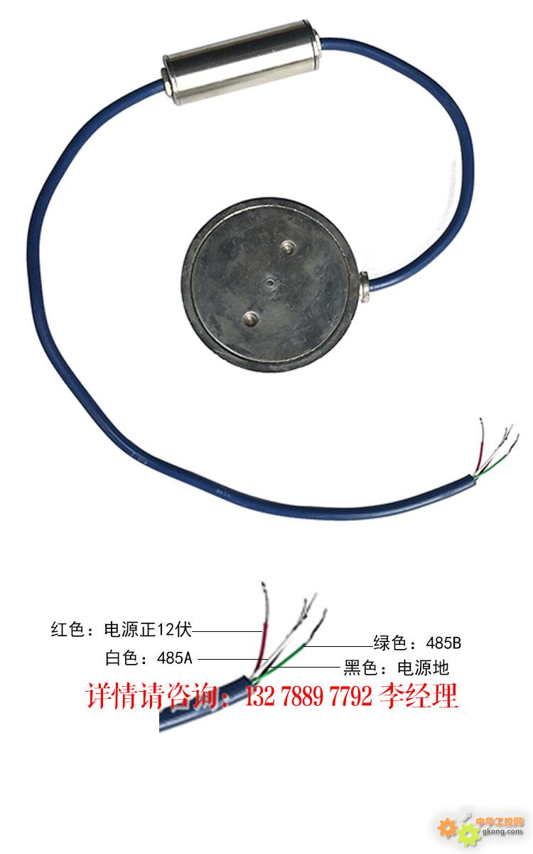

²úÆ·Ãû³Æ£º ¹ú±êmodbus485ÕñÏÒʽÍÁѹÁ¦ºÐ
ÐÍ ºÅ£º XY-TYLH
±¾ÍÁѹÁ¦ºÐʹÓñê×¼485ÐźÅ,Ϊ×Ô¶¯»¯¹«Ë¾¡¢¼¯³É¹«Ë¾µÈÌṩÓÅÖÊÁ®¼Ûǰ¶Ë²úÆ·¡£¹ã·ºÓ¦ÓÃÓÚ½¨Öþ¡¢Ìú·¡¢½»Í¨¡¢Ë®µç¡¢´ó°Ó¡¢ËíµÀµÈ¹¤³ÌÁìÓòµÄ»ù´¡¼°ÆäËüÍÁѹ¡¢Ë®Ñ¹µÄѹÁ¦²âÁ¿£¬³ä·ÖÁ˽ⱻ²âµãµÄѹÁ¦×´Ì¬¡£
Ò»¡¢¸ÅÊö
ÏÒʽѹÁ¦ºÐ¹ã·ºÓ¦ÓÃÓÚ½¨Öþ¡¢Ìú·¡¢½»Í¨¡¢Ë®µç¡¢´ó°Ó¡¢ËíµÀµÈ¹¤³ÌÁìÓòµÄ»ù´¡¼°ÆäËüÍÁѹ¡¢Ë®Ñ¹µÄѹÁ¦²âÁ¿£¬³ä·ÖÁ˽ⱻ²âµãµÄѹÁ¦×´Ì¬¡£
¶þ¡¢Ìصã
1. ²ÉÓÃÕñÏÒÀíÂÛÉè¼ÆÖÆÔ죬¾ßÓиßÁéÃô¶È¡¢¸ß¾«¶È¡¢¸ßÎȶ¨ÐÔµÄÓŵ㣬ÊÊÓÚ³¤ÆÚ¹Û²â¡£
2£®²ÉÓÃÈ«Êý×Ö¼ì²â¡£
3£®¾øÔµÐÔÄÜÁ¼ºÃ£¬·ÀË®ÄÍÓá£
4£® Óû§¿É¸ù¾Ý²»Í¬ÒªÇóÑ¡ÓÃÏàÓ¦ÐͺŵÄѹÁ¦ºÐ¡£
5£® ²ÉÓÃÂö³å¼¤Õñ·½Ê½¼¤Õñ£¬²âÊÔËٶȿ죬Ðźų¤¾àÀë´«Êä²»Ê§Õæ£¬¿¹¸ÉÈÅÄÜÁ¦Ç¿¡£
Èý¡¢Ö÷ÒªÐÔÄÜÖ¸±ê
¹æ¸ñ£º0.1¡¢0.2¡¢0.3¡¢0.4¡¢0.6¡¢0.8¡¢1¡¢2¡¢3¡¢4¡¢5¡¢6£¨Mpa£©
¼¼Êõ²ÎÊý  £º
1¡¢ Á¿ ³Ì£º0.1 ¡«6£¨Mpa£©
2¡¢ ÁéÃô¶È£º0.001Mpa
3¡¢ ʹÓû·¾³Î¶ȣº-10¡æ——©€70¡æ
4¡¢ ³¬Á¿³ÌÐÔÄÜ£º150%
5¡¢ ×ÛºÏÎó²î£º≤1.0 %FS
×¢£º³ß´ç¡¢ÐÔÄܲÎÊýΪ³£¹æ²úÆ·²ÎÊý£¬ÆäËû²ÎÊýÖ¸±ê¿É°´ÐèÇó¶©ÖÆ¡£
ËÄ¡¢°²×°ÓëʹÓÃ
£¨Ò»£©ÆÕͨÍÁѹÁ¦ºÐµÄʹÓÃÓë°²×°·½·¨
1¡¢    ¸ù¾Ý½á¹¹ÒªÇóÏȶ¨²âÊÔµãÓë²âÁ¦·½Ïò¡£
2¡¢  Ê¹Ñ¹Á¦ºÐÊÜÁ¦Ã棨¹âÃæ£©ÓëÊÜÁ¦·½Ïò´¹Ö±°²×°ºÃ¡£
×¢£º¢Ù.ѹÁ¦ºÐÖÜΧӦÓÃ30cm×óÓÒµÄϸɰ£¨ÀïÃæ²»ÄÜÓдó¿ÅÁ£Ó²Î°ü¹ü²¢Ñ¹Êµ¡£
¢Ú.ÍÁѹÁ¦ºÐµÄÊÜÑ¹ÃæÐëÃæ¶ÔÓû²âÁ¿µÄÍÁÌå¡£
¢Û.³ÐÊÜÍÁѹÁ¦ºÐµÄÍÁÃæÐëÑϸñÕûƽ£¬»ØÌîÍÁÁÏÓ¦ÓëÖÜΧÍÁÁÏÏàͬ£¨³ýÁËʯÁÏ£©
3¡¢½«µ¼ÏßÑØ½á¹¹ÌåÒý³ö£¬×îºÃ²ÉÓû¤Ì׹ܱ£»¤ºÃ¡£
4¡¢Á¬½ÓÒÇÆ÷¡£
¢Ù.½«Ñ¹Á¦ºÐÓëËùÅä½ÓµÄ²úÆ·Á¬½ÓºÃ¡££¨Çë²ÎÕÕËùÅä½Ó²úÆ·µÄ˵Ã÷Ê飩¡£
¢Ú.¼Ç¼ÏÂÁãµãÓ¦±ä³õÖµ²¢±£´æºÃ¼Ç¼×ÊÁÏ¡£
