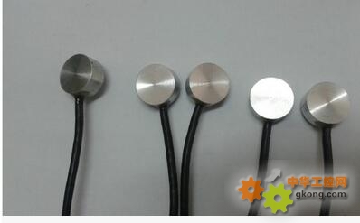

²úÆ·Ãû³Æ£º ΢ÐÍÍÁѹÁ¦ºÐ
ÐÍ ºÅ£º
΢ÐÍÍÁѹÁ¦ºÐ µç×èʽѹÁ¦ºÐ Ó¦±äʽÍÁѹÁ¦ºÐ ÍÁѹÁ¦ºÐ
²âÁ¿·¶Î§£º0.1¡¢0.2¡¢0.4¡¢0.6¡¢0.8¡¢1.0¡¢1.6¡¢2.5¡¢4.0¡¢6.0MPa£¨¿ÉÒÔ¶¨×ö£©
·Ö ±æ Á¦£º≤0.05%F.S
×ÛºÏÎó²î£º≤1.0%F.S
¹¤×÷ζȣº-25¡æ~+60¡æ
