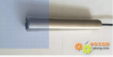

²úÆ·Ãû³Æ£º ÕñÏÒÊ½ÉøÑ¹¼Æ
ÐÍ ºÅ£º
 ¸ÖÏÒÊ½ÉøÑ¹¼Æ ¿×϶ˮѹ¼Æ ÉøÑ¹¼Æ
ÏÒʽ¿×ѹ¼Æ¹ã·ºÓ¦ÓÃÓ뽨Öþ¡¢Ìú·¡¢½»Í¨¡¢Ë®µç´ó¡¢°Ó¡¢ËíµÀµÈÍÁľ¹¤³ÌÁìÓò»ù´¡µÄ¿×϶ˮѹÁ¦µÄ²âÁ¿¡£¼à²â·ÀÉøÐ§¹û¡¢ÈưÓÉøÁ÷¡¢ÉøÂ©×´Ì¬¼°ÍÁÌåµÄ½þÈóÏß¡£
 Ìصã
1¡¢²ÉÓÃÕñÏÒʽÀíÂÛÉè¼ÆÖÆÔ죬²»Ðâ¸Ö²ÄÖÊ£¬¾ßÓиßÁéÃô¶È¡¢¸ß¾«¶È¡¢¸ßÎȶ¨ÐÔµÄÌØµã£¬ÊÊÓ¦ÓÚ³¤ÆÚ¹Û²â¡£
2¡¢²ÉÓÃÊý×ÖÐźÅÐźżì²â£¬Ðźų¤¾àÀë´«Êä²»Ê§Õæ£¬¿¹¸ÉÈÅÄÜÁ¦Ç¿¡£
3¡¢¾øÔµÐÔÄÜÁ¼ºÃ£¬·ÀË®ÄÍÓá£
4¡¢²ÉÓÃÂö³å¼¤Õñ·½Ê½£¬¼¤Õñ¡¢²âÊÔËٶȿ졣
¼¼Êõ²ÎÊý
a.Á¿³Ì£º0.1mPa £­4mPa(¿ÉÒÔ¶¨×ö£©
b.ÁéÃô¶È£º0.1Hz
c.ʹÓû·¾³Î¶ȣº£­20¡æ¡«80¡æ
°²×°ËµÃ÷
a) ÒÇÆ÷ÊÒÄÚ´¦Àí¡£ÒÇÆ÷¼ìÑéºÏ¸ñºó£¬È¡ÏÂ͸ˮʯ£¬ÔÚ¸ÖģƬÉÏͿһ²ã·ÀÐâÓÍ¡£°´ÐèÒª³¤¶È½ÓºÃµçÀ¡£
b) ½«Ñ¹Á¦¼Æ·ÅÈëË®ÖнþÅÝ2СʱÒÔÉÏ£¬Ê¹Æä³ä·Ö±¥ºÍ£¬Åųý͸ˮʯÖÐµÄÆøÅÝ¡£
c) Óñ¥ºÍϸɰ´ü½«²âÍ·°üºÃ£¬È·±£Ñ¹Á¦¼Æ½øË®¿Úͨ³©£¬²¢¼ÌÐø½þÈëË®ÖС£
1¡¢ÌîÖþ¹ý³ÌÖÐÂñÉè°²×°
£¨1£©µ±°ÓÌåÍÁÁÏÌîÖþ³¬¹ýÒÇÆ÷¸ß³Ì0.5mºó£¬Í£Ö¹ÌîÖþ¡£²âÁ¿²¢·Å³öÒÇÆ÷λÖã¬ÒÔÒÇÆ÷µãΪÖÐÐÄÈ˹¤ÍÚ³ö³¤×¿í×ÉîΪ1m×0.8m×0.5mµÄ¿Ó¡£
£¨2£©ÂñÉèÒÇÆ÷ʱ£¬ÔÚ¿Óµ×ÆÌÉèÒ»²ã10cmÖÐϸɰ£¬²¢½½Ë®Ê¹Æä±¥ºÍ£¬È»ºó½«×¼±¸ºÃ×°ÔÚɰ´üÖÐÒÇÆ÷·ÅÔÚɰµæ²ãÉÏ,ÒÇÆ÷µçÀÂÏßÈÆÒ»È¦ºó£¬ÏòÍâÒý³ö£¬ÔÙÔÚÒÇÆ÷ÉÏÆÌÉè10¡«15cmµÄÖÐϸɰ£¬½½Ë®Ê¹É°±¥ºÍ£¬È»ºóÔÚÆäÉÏ»ØÌîСÀùʯ£¬²¢·Ö²ãÈ˹¤º»Êµ¡£
£¨3£©µ±ÔÚÍÁÌåÖÐÂñÉèÉøÑ¹¼ÆÊ±£¬ÐèÒª²âÁ¿¸ºÑ¹¿×϶ˮѹÁ¦£¬Í¨³£²ÉÓøßÍ¨ÆøÐÍÌÕ´É͸ˮʯÀ´²âÁ¿£¬ÔÚÂñÉèʱ£¬ÆäÖÜΧ²»ÒªÓÃɰ´ü£¬¿ÉÖ±½ÓÓÃÕ³ÍÁ½øÐлØÌî¡£
£¨4£©µ±È˹¤º»ÊµÊ¹ÒÇÆ÷ÂñÉî´óÓÚ1.2mʱ£¬·½Ðí»úеÄëѹ¡£ËùÒÔÿ֧ÒÇÆ÷ÂñÉèλÖÃÉϲãÈ˹¤»ØÌîÒª±£Ö¤1.2m£¬¸ù¾Ý°ÓÌåÌîÍÁ²ãºñ£¬°²ÅÅÈ˹¤º»Êµ£¬ÒÔ±£Ö¤ÒÇÆ÷°²È«¡£
