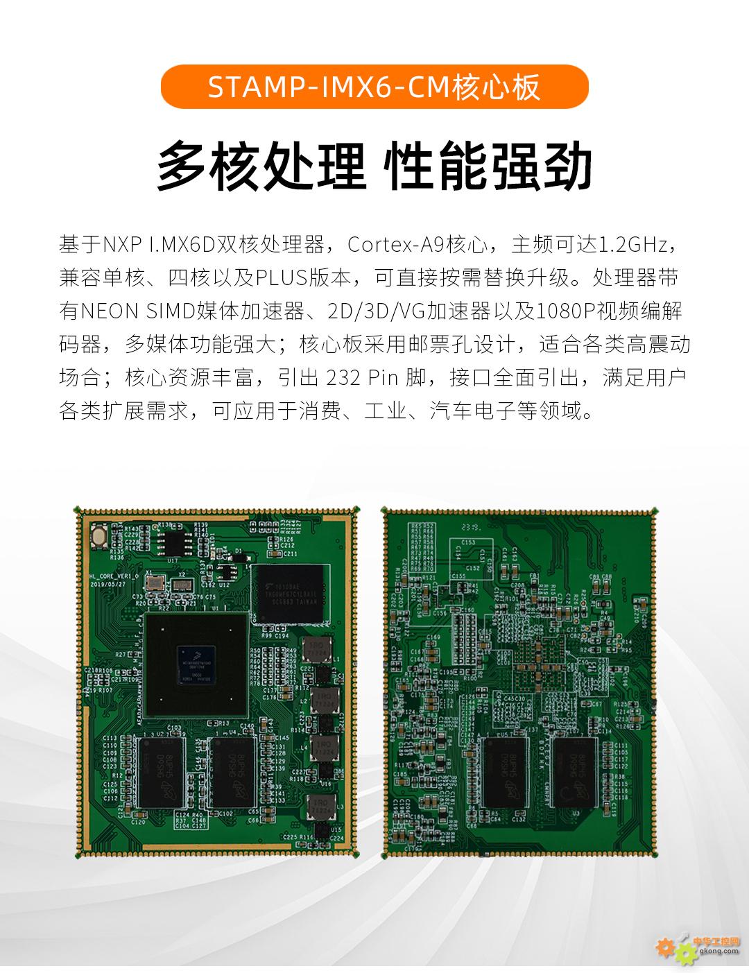

ÆôÑïSTAMP-IMX6-CMºËÐİåÓÊÆ±¿ÚÉè¼Æ£¬³É±¾¸üµÍ£¬ÊʺϸßÕ𶯹¤Òµ³¡¾°
STAMP-IMX6-CMºËÐİå»ùÓÚNXPI.MX6DË«ºË´¦ÀíÆ÷£¬Cortex-A9ºËÐÄ£¬Ö÷Ƶ¿É´ï1.2GHz£¬¼æÈݵ¥ºË¡¢ËĺËÒÔ¼°PLUS°æ±¾£¬¿ÉÖ±½Ó°´ÐèÌæ»»Éý¼¶¡£´¦ÀíÆ÷´øÓÐNEONSIMDýÌå¼ÓËÙÆ÷¡¢2D/3D/G¼ÓËÙÆ÷ÒÔ¼°1080PÊÓÆµ±à½âÂëÆ÷£¬¶àýÌ幦ÄÜÇ¿´ó£»ºËÐİå²ÉÓÃÓÊÆ±¿×Éè¼Æ£¬Êʺϸ÷Àà¸ßÕ𶯳¡ºÏ£»ºËÐÄ×ÊÔ´·á¸»£¬Òý³ö232Pin½Å£¬½Ó¿ÚÈ«ÃæÒý³ö£¬Âú×ãÓû§¸÷ÀàÀ©Õ¹ÐèÇ󣬿ÉÓ¦ÓøÉÏû·Ñ¡¢¹¤Òµ¡¢Æû³µµç×ÓµÈÁìÓò¡£
  • ²ÉÓà ARM® Cortex™-A9 Äںˣ¬Ö÷Ƶ¸ß´ï 1.2GHZ£¬¼æÈݵ¥ºË¡¢Ë«ºË¡¢Ëĺˣ»
  • ´ø 1MBL2 »º´æ£¬32KB Ö¸ÁîºÍÊý¾Ý»º´æ£¬NEON SIMD ýÌå¼ÓËÙÆ÷£»
  • ´ø 2D/3D/VG ¼ÓËÙÆ÷£¬1080P µÄ h.264 ÊÓÆµÓ²¼þ±à½âÂ룬֧³ÖË« 720P ÊÓÆµ±àÂ룻
  • 1x 20 λ²¢ÐУ¬MIPI-CSI2 (4 ͨµÀ)£¬Ö§³ÖÈý·ͬʱÊäÈëÉãÏñÍ·½Ó¿Ú£»
  • 1 ¸ö¼¯³É PHY µÄ usb OTG£¬Ò»¸ö¼¯³É PHY µÄ USB HOST£¬2 ¸ö HOST USB HSIC£»
  • ¼¯³É 2 · CAN£¬Ã¿Â·¿É´ï 1Mbps£¬Ö§³Ö CAN2.0 ЭÒ飻
  • ¶à´ï 3 ¸ö SD/MMC 4.4£¬1 ¸ö SDXC£»
  • 3 ¸ö UART£¬3 ¸ö I2C£¬4 ¸ö PWM£»
  • ¼¯³É EIM ½Ó¿Ú£¬1 ͨµÀ PCIe2.0 ½Ó¿Ú£»
  • ¸ß¿É¿¿Òýµ¼£¬¼ÓÃÜÒýÇæ£¬Ëæ»úÊýÉú³ÉÆ÷ºÍ´Û¸Ä¼ì²â¡£
²úÆ·²ÎÊý
  • CPU
    • NXP i.MX6Dual£¬ARM® Cortex™-A9 Äںˣ¬Ö÷Ƶ¸ß´ï 1.2GHz, ¼æÈݵ¥ºË¡¢Ë«ºË¡¢ËĺË
  • RAM
    •2GB DDR £¨Óû§¿É¸ù¾ÝÐèÇóÑ¡Ôñ 256MB/512MB/1GB µÈÅäÖã©
  • FLASH
    •16GB EMMC£¨Óû§¿É¸ù¾ÝÐèÇóÑ¡Ôñ 4GB/8GB µÈÅäÖã©
  • ÏÔʾ½Ó¿Ú
    • CSI&DSI ½Ó¿Ú
    • 2 · LVDS ½Ó¿Ú£¬Ã¿Â·×î¸ßÖ§³Ö 1920x1200 ·Ö±æÂÊ
    • HDMI ½Ó¿Ú£¬Ö§³Ö HDMI 1.4 ½Ó¿Ú¹æ·¶
  • UART½Ó¿Ú
    • 3 · RS232 ´®¿Ú
  • USB½Ó¿Ú
    • 1 · USB ¸ßËÙ OTG
    • 4 · USB HOST£¬ÆäÖÐ 1 ·½ÓÈë MIN_PCIE ½Ó¿Ú
  • PWM½Ó¿Ú
    • Ö§³Ö 4 · PWM ½Ó¿Ú
  • I2C½Ó¿Ú
    • 3 · I2C ½Ó¿Ú
  • SPI½Ó¿Ú
    • 5 · SPI ½Ó¿Ú
  • SDIO½Ó¿Ú
    • SDIO ½Ó¿Ú
  • PCI-e½Ó¿Ú
    • 1 · PCI-e2.0 ½Ó¿Ú
  • I2S½Ó¿Ú
    • I2S ½Ó¿ÚÖ§³Ö 3 ·Êý×ÖÓïÒôÊäÈë
  • CAMERA
    • MIPI CSI ½Ó¿Ú
  • GPIO½Ó¿Ú
    •Ô¤Áô²¿·Ö GPIO ½Ó¿Ú
  • ÊäÈëµçѹ
    •+5V µçѹÊäÈë
  • ³ß´ç
    •69.6mm*56.8mm
  • ½Ó²å¼þ
    •ÓÊÆ±¿ÚÁ¬½Ó·½Ê½
  • Òý½Å¼ä¾à
    •1.066mm
  • º¸Å̳ߴç
    •2.032mm*0.863mm /1.778mm*0.863mm
  • Òý½ÅÊýÁ¿
    •Òý³ö 232Pin ½Å£¬Âú×ã¸÷ÀàÀ©Õ¹ÐèÇó
  • ¹¤ÒÕ
    •²ÉÓà 8 ²ã³Á½ð PCB ¹¤ÒÕ
  • °å²Ä
    •¸ß TG PCB °å²Ä
  • ¹¤×÷ζÈ
    •-20¡æ ~ +70¡æ£¨¿É¸ù¾ÝÓû§ÐèÇó¶¨ÖÆÊ¹Óù¤Òµ¼¶Î¿íÆ÷¼þ£©
  • ¹¤×÷ʪ¶È
    •5%µ½ 95%£¬·ÇÄý½á
