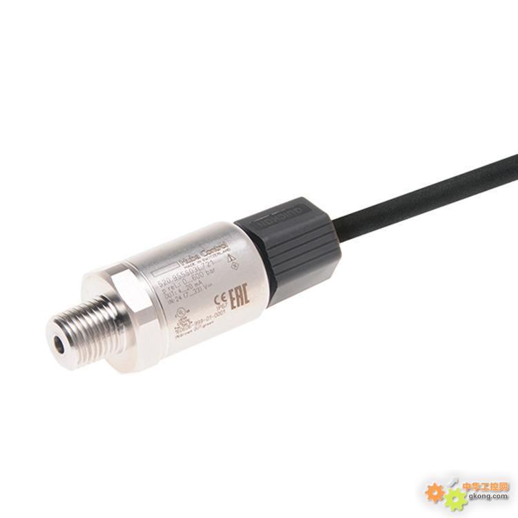

½ô´ÕÐÍ511OEMѹÁ¦±äËÍÆ÷¿ÉÂú×ã»úеӦÁ¦£¬EMCÌØÐԺͲÙ×÷°²È«ÐÔ·½ÃæµÄÒªÇó£¬ÌرðÊÊÓÃÓÚÒªÇó¿Á¿ÌµÄ¹¤ÒµÓ¦Ó᣸ô«¸ÐÆ÷»ùÓÚHuba Control¿ª·¢µÄÌմɼ¼Êõ£¬ÒÑʹÓÃÁËÊý°ÙÍòÄ꣬ÒÑÓÐ20¶àÄêµÄÀúÊ·¡£½áºÏµÄ¼¯³Éµç×ÓÉè¼Æ£¬511ϵÁпÉÔÚÓÐζȷ¶Î§ÄÚÌṩ¸ß¾«¶È¡£ÊÊÓÃÓÚ¾ßÓеÄСÐÍϵÁÐÖÁ¸ßÈÝÁ¿Ó¦Óá£
²úÆ·ÌØµãÈçÏ£º
1.ѹÁ¦·¶Î§£ºÏà¶ÔѹÁ¦-1¡«600bar£¬¾øÑ¹0…25bar.
2.¹ýÔØÑ¹Á¦
3.0×ÂúÁ¿³Ì£¨ÔÚÁ¿³ÌΪ-1¡«4bar£©2.5×ÂúÁ¿³Ì£¨ÔÚÁ¿³ÌΪ6¡«400bar£©2.0×ÂúÁ¿³Ì£¨ÔÚÁ¿³ÌΪ600bar£©
3. .ÆÆÁÑѹÁ¦3.0×ÂúÁ¿³Ì£¨ÔÚÁ¿³ÌΪ-1¡«4bar£©2.5×ÂúÁ¿³Ì£¨ÔÚÁ¿³ÌΪ6¡«400bar£©2.0×ÂúÁ¿³Ì£¨ÔÚÁ¿³ÌΪ600bar£©
4.·À»¤µÈ¼¶£ºip67
5.Íâ¿Ç²ÄÖÊ£º²»Ðâ¸Ö1.4305£¨aisi 303£©
6.ζȷ¶Î§£º-15¡æ¡«£«125¡æ
7.Ó¦ÓÃζÈ(ÃÜ·âÇé¿öϵĽéÖÊζÈ)
fpm -15¡«125¡ænbr -25¡«85¡æfpm£¨spec£©-40¡«150¡æ
8.µçѹ8.0¡«33vdc£¬Êä³ö4-20ma
8.ÓÅÔ½µÄµç´Å¼æÈÝ£¨emc£©
9.ÃÜ·â²ÄÖÊ£º Ñ¡Ïî²ÄÁÏfpm£¬nbr£¬»òÆäËü¿Í»§ÒªÇó
10.ÖØÁ¿£ºÄÚÂÝÎÆ85¿Ë£¬ÍâÂÝÎÆ95¿Ë
11.µçÔ´·´Ïà±£»¤£¬¾²µç±£»¤500vdc
12.¾«¶È£º¾«¶È ÏßÐÔ£¬³ÙÖÍ£¬ºÍÖØ¸´ÐԵĺͱ0.3% fs
13.¹ý½éÖÊֹͣϵͳ£¨±¬ÆÆË¨£©
ѹÁ¦·¶Î§
-1 ... 9 bar / 0 ... 2.5 - 1000 bar
²úÁ¿ 0 ... 5 V£¬1 ... 6 V£¬0 ... 10 V£¬
±ÈÂÊʽ¡£10 ... 90£¥£¬4 ... 20 mA
׼ȷÐÔ µäÐÍÖµ<0.3£¥FS
µçÆøÁ¬½Ó µçÀ¿ìËÙ½ÓÍ·£¬Metri Pack£¬²åÍ·DIN 175301-803-A»òC£¬M12x1
½ÊºÏÁ¬½Ó£¬²åÍ·RAST 2.5
ѹÁ¦Á¬½Ó ÄÚÂÝÎÆ»òÍâÂÝÎÆ
½ô´Õ¶ø¼á¹ÌµÄÉè¼Æ
ÎÞÃܷ⺸½Ó£¬ÎÞµ¯ÐÔÌåÃÜ·â
¸ßÁ¬½ÓÆ÷ÖÖÀà
ʡʱ£¬¼òµ¥µÄ¿Í»§¶ËµçÀ°²×°£¬µçÀ¿ìËÙ°²×°
