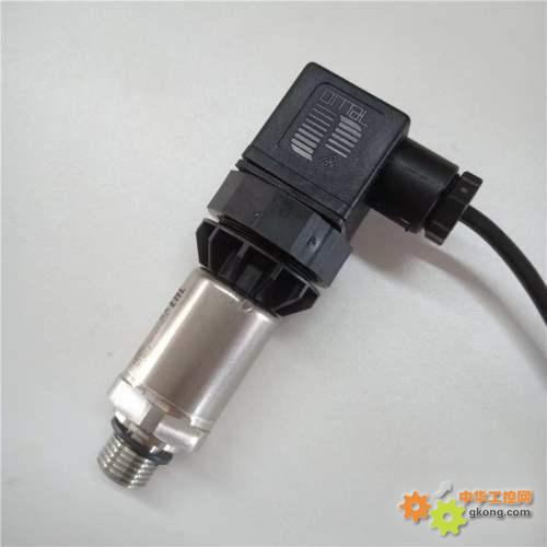

²úÆ·Ãû³Æ£º huba¸»°Í´«¸ÐÆ÷520.943S043401
ÐÍ ºÅ£º 520.943S043401
²úÆ·ÌØµãÈçÏ£º
1.ѹÁ¦·¶Î§£ºÏà¶ÔѹÁ¦-1¡«600bar£¬¾øÑ¹0…25bar.
2.¹ýÔØÑ¹Á¦
3.0×ÂúÁ¿³Ì£¨ÔÚÁ¿³ÌΪ-1¡«4bar£©2.5×ÂúÁ¿³Ì£¨ÔÚÁ¿³ÌΪ6¡«400bar£©2.0×ÂúÁ¿³Ì£¨ÔÚÁ¿³ÌΪ600bar£©
3. .ÆÆÁÑѹÁ¦3.0×ÂúÁ¿³Ì£¨ÔÚÁ¿³ÌΪ-1¡«4bar£©2.5×ÂúÁ¿³Ì£¨ÔÚÁ¿³ÌΪ6¡«400bar£©2.0×ÂúÁ¿³Ì£¨ÔÚÁ¿³ÌΪ600bar£©
4.·À»¤µÈ¼¶£ºip67
5.Íâ¿Ç²ÄÖÊ£º²»Ðâ¸Ö1.4305£¨aisi 303£©
6.ζȷ¶Î§£º-15¡æ¡«£«125¡æ
7.Ó¦ÓÃζÈ(ÃÜ·âÇé¿öϵĽéÖÊζÈ)
fpm -15¡«125¡ænbr -25¡«85¡æfpm£¨spec£©-40¡«150¡æ
8.µçѹ8.0¡«33vdc£¬Êä³ö4-20ma
8.ÓÅÔ½µÄµç´Å¼æÈÝ£¨emc£©
9.ÃÜ·â²ÄÖÊ£º Ñ¡Ïî²ÄÁÏfpm£¬nbr£¬»òÆäËü¿Í»§ÒªÇó
10.ÖØÁ¿£ºÄÚÂÝÎÆ85¿Ë£¬ÍâÂÝÎÆ95¿Ë
11.µçÔ´·´Ïà±£»¤£¬¾²µç±£»¤500vdc
12.¾«¶È£º¾«¶È ÏßÐÔ£¬³ÙÖÍ£¬ºÍÖØ¸´ÐԵĺͱ0.3% fs
13.¹ý½éÖÊֹͣϵͳ£¨±¬ÆÆË¨£©
ѹÁ¦·¶Î§
-1 ... 9 bar / 0 ... 2.5 - 1000 bar
²úÁ¿ 0 ... 5 V£¬1 ... 6 V£¬0 ... 10 V£¬
±ÈÂÊʽ¡£10 ... 90£¥£¬4 ... 20 mA
׼ȷÐÔ µäÐÍÖµ<0.3£¥FS
µçÆøÁ¬½Ó µçÀ¿ìËÙ½ÓÍ·£¬Metri Pack£¬²åÍ·DIN 175301-803-A»òC£¬M12x1
½ÊºÏÁ¬½Ó£¬²åÍ·RAST 2.5
ѹÁ¦Á¬½Ó ÄÚÂÝÎÆ»òÍâÂÝÎÆ
½ô´Õ¶ø¼á¹ÌµÄÉè¼Æ
ÎÞÃܷ⺸½Ó£¬ÎÞµ¯ÐÔÌåÃÜ·â
¸ßÁ¬½ÓÆ÷ÖÖÀà
ʡʱ£¬¼òµ¥µÄ¿Í»§¶ËµçÀ°²×°£¬µçÀ¿ìËÙ°²×°
huba¸»°Í´«¸ÐÆ÷520.943S043401¼¼Êõ²ÎÊý
¹ýÔØÑ¹Á¦ £º2~3±¶ÂúÁ¿³Ì£»
ÆÆ»µÑ¹Á¦ £º2~3±¶ÂúÁ¿³Ì£»
ѹÁ¦Á¬½Ó £ºÍâÂÝÎÆG1/4 ºó²¿Ãܷ⣨din3852/e£©£»
Êä³ö/µçÔ´£º4-20mA/8-33DCV(2Ïß)£»
µçÆøÁ¬½Ó £ºµçÀÂ1.5Ã×»òºÕ˹Âü½ÓÍ· (·À»¤µÈ¼¶ip67),
¹¤×÷ζȠ£º-15°c ~80°c
½Ó´¥½éÖʲÄÁÏ£º²»Ðâ¸Ö£»
ÃÜ·â²ÄÁÏ £º·úÏð½º(fpm)¡¢¶¡ÇèÏð½º(nbr)¡¢ÌØÊâ·úÏð½º(fpm)
¿ÇÌå²ÄÁÏ £º²»Ðâ¸Ö£»
¸ºÔØÆµÂÊ £º< 50hz
ÖØ Á¿ £ºÄÚÂÝÎÆ85g£¬ÍâÂÝÎÆ95g£»
ÍâÐγߴ砣º22.8×77mm£»
