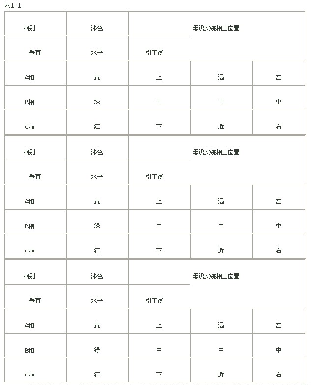

4.母排位置相序对应关系:
![](/Editor/UploadFiles/learns02/201041111718378.jpg)
