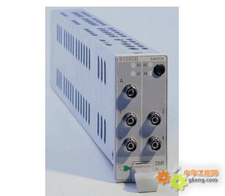

产品名称: Agilent 81594B 模块
型  号: 81594B
Agilent 81594B  模块
Key Features & Specifications
Key performance specifications:
·         Insertion Loss < 1.5dB
·         Guaranteed lifetime > 10 Mio. cycles
·         PDL < 0.05dB for single-mode option
·         Highest repeatablity specified over 10.000 random switch cycles: 0.02dB
Description
The plug-in module for Agilent's Lightwave Solution Platform 8163B, 8164B, 8166B is ideal for flexible system configuration in applications such as transceiver/receiver test with small foot-print or multiple passive component test with complex cascade. The Agilent modular design of the optical switch features a 2x2 matrix in both SMF and MMF with low insertion loss and highly repeatable switch routing in <10 ms switching time.
Routing of various optical sources such as laser in various wavelenght range and routing of various optical receiver such as power sensor, oscilloscope, BERT.
Features:
Benefits:
·         Using one test setup for testing DUTs in all transmission bands.
·         Minimize test uncertainties, maximize power budget enables higher production yield an highly competitive product specifications
·         Minimize test times - maximize production throughput.
·         Minimal influence on transmitted signal.
