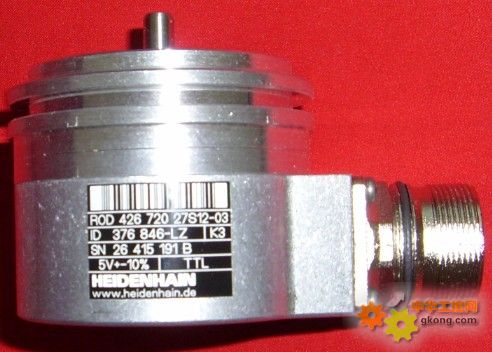

产品名称: 海德汉编码器(heidenhain)
型  号: ROD 426 720
价  格:
ROD 426
Incremental rotary encoder with integral bearing
for separate shaft coupling
Line count:             720
Output signal:          TTL
Max. scanning frequency:300.00 kHz
Power supply:           5V+-10%
Flange version:         synchro flange Øa 58mm,
                        centering collar 50mm,
                        bolt circle Ø42mm, 3 x M4
Shaft:                  solid shaft, diameter
                        6mm, length 9.5mm
Degree of protection:   IP 64 (EN 60529)
Operating temperature:  -40/+100 °C
Electrical connection:  flange socket, male 12-pin
Pin configuration:      D294999
Connecting direction:   radial
special
characteristics,
rotational encoders:    none
