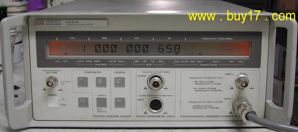

HP5347A ΢²¨ÆµÂʼÆ
΢²¨ÆµÂʼÆ
³§¼Ò£ºÃÀ¹ú»ÝÆÕ (144x325x456mm£¬9.1kg)
  • ƵÂʲâÁ¿·¶Î§ 10 Hz to 20 GHz
  • ¾ßÓй¦Âʼƹ¦ÄÜ
  • ½»Ö±Á÷¹©µç¾ù¿ÉʹÓ㬻¹¿ÉʹÓÃµç³Ø¹©µç
ƵÂʼÆÐÔÄÜ
ÊäÈëͨµÀ1
  • ƵÂÊ·¶Î§: 500 MHz to 20 GHz
  • ÁéÃô¶È£º
    500 MHz - 12.4 GHz: -32 dBm(-35 dBm typical)
    12.4 GHz - 20.0GHz: -27 dBm(-32 dBm typical)
  • ×î´óÊäÈë: +7 dBm
  • ¶¯Ì¬µçƽ: +25 dBm, peak
  • ñîºÏ£º½»Á÷(AC)
  • SWR
    500 MHz - 12.4 GHz: <2:1 typical
    12.4 GHz - 20.0GHz: <3:1 typical
  • ·Ö±çÂÊ: 1 Hz or 10 kHz, selectable
  • ɨÃèʱ¼ä
     ·Ö±æÁ¦ = 1 Hz ²»´óÓÚ 125 ms
     ·Ö±æÁ¦ = 10 kHz ²»´óÓÚ 60 ms
  • ×î´óÆ«²î
    20 MHz p-p, Automatic mode
    60 MHz p-p, Manual mode (via HP-IB only)
  • Maximum FM Rate: 10 MHz
  • AM Tolerance: Any modulation index provided the minimum signal level is not less than the sensitivity specification.
ÊäÈëͨµÀ2
  • ƵÂÊ·¶Î§: 10 Hz - 525 MHz
  • ÁéÃô¶È: 25 mV rms (15 mV rms typical)
  • ×迹: 1 M¦¸ nominal shunted by <70 pF (10 Hz to 80 MHz) or 50¦¸ nomimnal (10 MHz to 525 MHz)
  • ×î´óÊäÈ룺+10dBm(50¦¸ÊäÈë),1Vrms(1M¦¸ÊäÈë)
  • ñîºÏ£º½»Á÷(AC)
  • ·Ö±çÂÊ: 1 Hz »ò 10 kHz
¹¦ÂʼÆÐÔÄÜ
  • ƵÂÊ·¶Î§: 10 MHz - 26.5 GHz ÒÀÕÕ´«¸ÐÆ÷Ö¸±ê
  • ¹¦ÂÊ·¶Î§: -70 dBm to +20 dBm (100 pW to 100 mW) ÒÀÕÕ´«¸ÐÆ÷Ö¸±ê
  • ¶¯Ì¬·¶Î§: 50 dB in 10 dB steps
  • ÏÔʾµ¥Î»£ºWatts,dBm
  • ·Ö±çÂÊ: ¶ÔÊýģʽ 0.01 dB ; ÏßÐÔģʽÂúµµµÄ 0.1%
  • Accuracy Instrumentation: ¡À0.02 dB or ¡À0.5%
  • Zero Set (digital settability of zero): ¡À0.5% of full scale on most sensitive range.
  • ¹¦ÂÊ´«¸ÐÆ÷£ºHP8481A£¬HP8481D£¬HP8484A£¬HP8485A.
