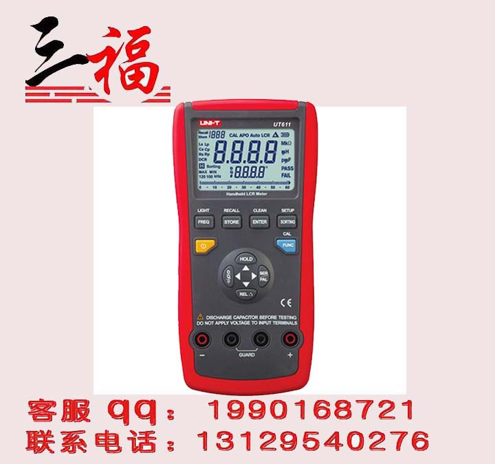

UNI-TÓÅÀûµÂUT611 LCR Êý×ÖµçÇűí
²úÆ·¼ò½é
UT610ϵÁÐÊÇÐÔÄÜÎȶ¨¡¢°²È«¿É¿¿µÄÊÖ³Öʽ×Ô¶¯Á¿³Ì LCRÊý×ÖµçÇÅ±í¡£ÊDzâÁ¿µç¸Ð¡¢µçÈÝ¡¢µç×èµÄרҵÒÇ±í£¬¾ßÓй¦ºÄµÍ¡¢²âÁ¿¾«¶È¸ß¡¢ËÙ¶È¿ìµÈÌØµã¡£´®²¢²âÁ¿Ä£Ê½Ñ¡Ôñ£¬²âÁ¿ÔªÆ÷¼þÆ·ÖÊÒòÊý¡¢ËðºÄ¡¢Ïàλ½Ç¡¢µÈЧµç×è²âÁ¿ºÍÖ±Á÷µç×è²âÁ¿£¬µç¸Ð¡¢µçÈÝ¡¢µç×è½»Á÷ģʽÏÂÆäÄܹ»Ìṩ¶à´ï5ÖÖ²âÁ¿ÆµÂÊ£¬¸üÄÜÂú×ãʵ¼ÊÐèÒª¡£ÊÊÓÃÓÚʵÑéÊÒ¡¢Éú²úÏß¡¢Î¬ÐÞµãºÍ½ÌѧµÈ¶à·½ÃæµÄµç¸Ð¡¢µçÈÝ¡¢µç×èµÄ²âÁ¿ºÍɸѡ£¬Êǹã´óÓû§Î¬ÐÞÓõÄÀíÏ빤¾ß¡£
 undefined
¼¼ÊõÖ¸±ê
»ù±¾¹¦ÄÜ Á¿³Ì ×î¸ß¾«¶È
ÐͺŠ  UT611
µç¸Ð (H) 600uH¡«200H ±(0.5%+5)
µçÈÝ (F) 600pF¡«10mF ±(0.5%+5)
µç×è (Ω) 60Ω¡«20MΩ ±(0.5%+5)
²âÊÔÆµÂÊ (Hz) 100Hz/120Hz/1KHz/10KHz
²âÊÔµçѹ 0.5Vrms
²âÊÔ²ÎÊý L/C/R/DCR/Q/D/θ/ESR
ÌØÊ⹦ÄÜ
×î´óÏÔʾ   6000
D/Q×î´óÏÔʾ   6000
D/Q·Ö±æÂÊ 0.001
×Ô¶¯Á¿³Ì
ʵʱÏÔʾ²âÊÔÆµÂÊ
²âÁ¿Ä£Ê½ ´®Áª/²¢Áª
×Ô¶¯¹Ø»ú
µÍµçѹÏÔʾ ≤6.8V
Êý×Ö±£³Ö
Ïà¶Ô²âÁ¿
Êý¾Ý´æ´¢   1000
LCD ±³¹â
Ä£ÄâÌõ   31¶Î
ɸѡ¹¦ÄÜ
У׼¹¦ÄÜ
Êä³ö×迹 120Ω
LCR×Ô¶¯Ê¶±ð²âÁ¿
Ò»°ãÌØÕ÷
µçÔ´ 9Vµç³Ø(6F22) »ò USB¹©µç
LCD³ß´ç 40 X 63mm
»úÉíÑÕÉ« ºìÉ« +  »ÒÉ«
»úÉíÖØÁ¿ 374g
»úÉí³ß´ç 96 X 193 X 47mm
±ê×¼Åä¼þ µç³Ø¡¢SMD²âÊÔǯ¡¢USBÊý¾ÝÏß¡¢×ª½Ó²å×ù
±ê×¼°ü×° ²ÊºÐ¡¢ËµÃ÷Êé¡¢±£ÐÞ¿¨
±ê×¼°ü×°ÊýÁ¿ 24̨
±ê×¼°ü×°³ß´ç 610mm X 450mm X 355mm
±ê×¼°ü×°ÏäÃ«ÖØ 22.3Kg
¿ÉÑ¡Åä¼þ
USBµçÔ´ÊÊÅäÆ÷£¨ÊÕ·Ñ£©
