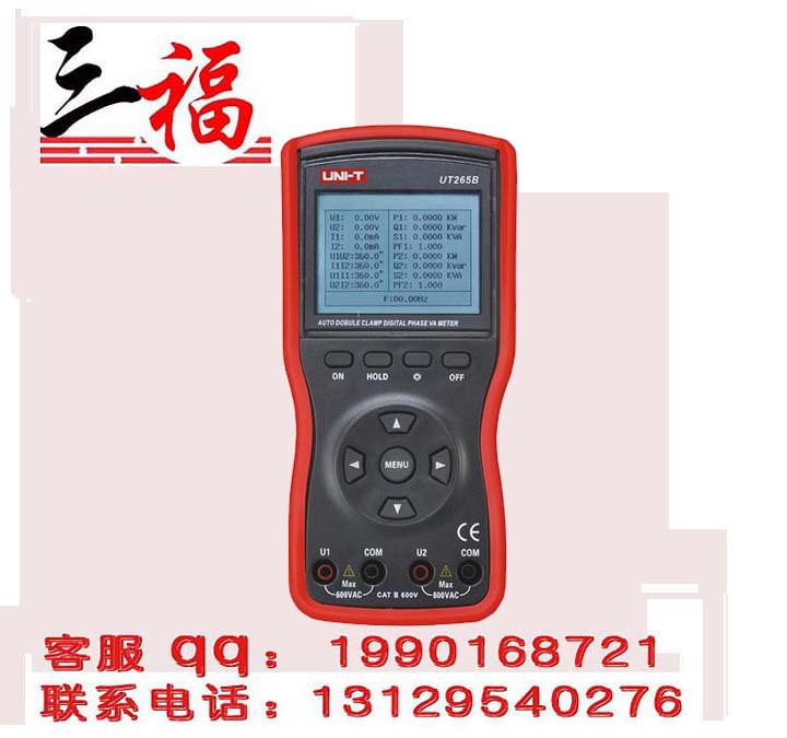

²úÆ·Ãû³Æ£º ÓÅÀûUT265BÖÇÄÜ˫ǯÊý×ÖÏàλ·ü°²±í
ÐÍ ºÅ£º UT265B
UNITÓÅÀûµÂUT265B ÖÇÄÜ˫ǯÊý×ÖÏàλ·ü°²±í
²úÆ·¼ò½é
UT265BÖÇÄÜÐÍ˫ǯÊý×ÖÏàλ·ü°²±íÑ¡ÓÃ×îÐÂÐͲÄÁÏÉè¼ÆÖÆ×÷Íâ¿ÇÄ£¾ß£¬ÅäÓеķÀÕñ¡¢·À»¬¡¢¸ß¾øÔµ»¤Ì×£¬²ÉÓÃ240dots×160dots LCDÏÔʾÆ÷£¬ËùÓвÎÊýͬÆÁÏÔʾ£¬Ò»Ä¿ÁËÈ»£¬¾¡ÏÔ¾«ÃÀºÀ»ªÍâ¹Û¡£ÊÊÓÃÓÚµçÁ¦¡¢Ê¯»¯¡¢Ò±½ð¡¢Ìú·¡¢¹¤¿óÆóÒµ¡¢¿ÆÑÐԺУ¡¢¼ÆÁ¿²¿Ãŵȡ£ÓÈÆäÊÊÓÃÓÚµçÄܼƷÑϵͳ¼°¼Ìµç±£»¤ÏµÍ³£¬Æä¹©µçÓªÏú²¿ÃŵĵçÄܼÆÁ¿¡¢Óõç¼ì²é¡¢µçÁ¦»ü²é£¬Éú¼¼²¿ÃŵÄ×°±í½Óµç ¡¢¼Ìµç±£»¤¡¢²î¶¯¼ì²â¡¢Æô¶¯ÊÔÑé¡¢±äµç¼ìÐÞ£¬»òµçÁ¦ÊµÑµ¡¢Êý×ÖÏàλ·ü°²±íµÈ£¬¼¼ÄܱÈÎäµÈ¡£
 undefined
¼¼ÊõÖ¸±ê
»ù±¾¹¦ÄÜ Á¿³Ì »ù±¾¾«¶È
ÐͺŠ  UT265B
½»Á÷µçÁ÷ (A) 0.0mA¡«20.0A ±(1.5%+3)
½»Á÷µçѹ (V) 0.00V¡«600V ±(1.5%+3)
ƵÂÊ (Hz) 45HZ¡«65HZ ±(2%+3)
Óй¦¹¦ÂÊ (W) 0.0W¡«12kW ±(3%+3)
ÊÓÔÚ¹¦ÂÊ     (VA) 0.0VA¡«12kVA ±(3%+3)
ÎÞ¹¦¹¦ÂÊ (VAr) 0.0VAR¡«12kVAR ±(3%+3)
¹¦ÂÊÒòËØ -1¡«+1 ±0.03
Ïàλ½Ç(°) 0.0°¡«360° ±1°
ÌØÊ⹦ÄÜ
ÏÔʾģʽ LCD£º240dots×160dots
ǯ¿Ú³ß´ç ¼âСÐεçÁ÷ǯ£º7.5mm×13mm    (Ñ¡ÐÍ)£¬Ô²¿ÚÐεçÁ÷ǯ£º35mm×40mm  (Ñ¡ÐÍ)
×Ô¶¯Á¿³Ì
RS-232Êý¾Ý´«Êä
Êý¾Ý´æ´¢   1500×é
LCD ±³¹â
Êý×Ö±£³Ö
ÊäÈë×迹 ≥2MΩ
×Ô¶¯¹Ø»ú 15·ÖÖÓ
µÍµçѹÏÔʾ
¼ì²âËÙÂÊ Ô¼2Ãë/´Î
Ò»°ãÌØÕ÷
µçÔ´ 1.5V¼îÐÔ¸Éµç³Ø(5#£©X 6
»úÉíÑÕÉ« ºìÉ« + »ÒÉ«
»úÉíÖØÁ¿ 550g
»úÉí³ß´ç 196mm X 92mm X 54mm
±ê×¼Åä¼þ µç³Ø¡¢µçÁ÷ǯ2°Ñ¡¢²âÊÔÏß4Ìõ¡¢¹¤¾ßÏä
±ê×¼°ü×° ²ÊºÐ¡¢ËµÃ÷Êé¡¢±£ÐÞ¿¨
±ê×¼°ü×°ÊýÁ¿ 6 ̨
±ê×¼°ü×°³ß´ç 530mm X 380mm X 395mm
±ê×¼°ü×°ÏäÃ«ÖØ 17Kg
