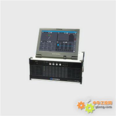

²úÆ·Ãû³Æ£º ÈÕ±¾¹²ºÍÓ¦Á¦²âÊÔÒÇEDX-5000AÔ­×°½ø¿Ú
ÐÍ ºÅ£º EDX-5000A
²úÆ·ÏêÇé
ÐͺÅÃû³Æ
EDX-5000A-64-HE: »úеӲÅÌ£¨HDD£©
EDX-5000A-64-SE: ¹Ì̬ӲÅÌ£¨SSD£©
ÊÊÓ÷ŴóÆ÷¿¨
CVM-41A, CDV-40B(-F), DPM-42B£¨-F£©, DPM-42B-£¨I -F£©, CTA-40A, CFV-40A, CCA-40A£¨-F£©, CDV-44AS, CDA-44AS, CDA-45AS, AD-40AS£¨-F£©
²âÁ¿Í¨µÀÊý
×î¶à64ͨµÀ(°²×°8ÕÅCDV-40B)
Ä£ÄâÊäÈë
ÏêϸÇë²Î¿¼¸÷·Å´óÆ÷¿¨µÄ¹æ¸ñ
Êý×ÖÊäÈë/Êä³ö
ÊäÈë/Êä³öµãÊý : ×î¶à 8µã
ÊäÈë/Êä³öÉ趨 : É趨ÿbitµÄÊý×ÖÊäÈë/Êý×ÖÊä³ö/Ò£¿ØÊäÈ루COMΪ¹²Óã©
¡ùÒ£¿ØÊäÈë: ¿É¿ªÊ¼/Í£Ö¹²âÁ¿, Ö´ÐÐBALµÈ
ÊäÈëÐÎʽ : ¾øÔµÐÍ, TTLµçƽÊäÈë
ÊäÈëµçѹ : ×î´ó DC 5V
¾øÔµ·¨ : Êý×Ö¸ôÀëÆ÷
Êä³öÐÎʽ : ¾øÔµÐÍ, ¼¯µç¼«¿ªÂ·ÐÍÊä³ö
£¨ÄÚ²¿´ø10kΩÉÏÀ­µç×裩
Êä³öµçѹ : DC 5V
Êä³öµçÁ÷ : £¨Ã¿1µã£©×î´ó 25mA
ÒôÉùÊäÈë
1ͨµÀ£¨²É¼¯Ê±¿É¼Ç¼ÓïÒô±¸Íü¼£©
ʹÓÃÒ£¿Øµ¥ÔªRCU-42A£¨Ñ¡¹ºÅä¼þ£©
²ÉÑù
²ÉÑùƵÂÊ : 1-2-5ϵÁÐ
1Hz¡«200kHz£¨×î¶à32CHµÄÊý¾Ý²É¼¯Ê±£©
1Hz¡«100 kHz£¨×î¶à64CHµÄÊý¾Ý²É¼¯Ê±£©
1Hz¡«50kHz£¨×î¶à80CHµÄÊý¾Ý²É¼¯Ê±£©
1Hz¡«10kHz£¨ÊµÊ±´¦ÀíÓÐЧʱ£©
2nϵÁÐ
2Hz¡«131.072kHz£¨×î¶à32CHµÄÊý¾Ý²É¼¯Ê±£©
2Hz¡«65.536kHz£¨×î¶à64CHµÄÊý¾Ý²É¼¯Ê±£©
2Hz¡«32.768kHz£¨×î¶à80CHµÄÊý¾Ý²É¼¯Ê±£©
2Hz¡«8.192kHz£¨ÊµÊ±´¦ÀíÓÐЧʱ£©
¡ùADÊý¾ÝÐÎʽ: 16 bits Ä£Ê½Ê±
¡ù24 bits Ä£Ê½Ê±, ±äΪÉÏÊöͨµÀÊýµÄÒ»°ë¡£
¼Ç¼ýÌå(ÄÚÖÃÓ²ÅÌ)
»úеӲÅÌ£¨HDD£©ÈÝÁ¿300GB»òÒÔÉÏ
¹Ì̬ӲÅÌ£¨SSD£©ÈÝÁ¿30GB»òÒÔÉÏ
ÏÔʾ
ÏÔʾͨµÀ״̬LED£¨¿ÉÉ趨ÿ¸öͨµÀµÄÊäÈë¹ýÔØµçƽ£©
REC, BUSY, BATTERY, POWER LED
12.1Ó¢´ç´¥ÆÁÒº¾§ÏÔʾÆ÷
²Ù×÷¼ü
Ö÷»úÓкʹ¥ÆÁһֵݴ¼ü£¨REC, STOP, BAL., OPT.£©
Ò²¿Éͨ¹ýÍâ²å¼üÅ̺ÍÊó±ê²Ù×÷
Íⲿ¿ØÖƽÓÍ·
CONT.IN, CONT.OUT£¨Ô¶³Ì, Í¬²½ÔËÐÐÓã©
ÍⲿÊäÈë/Êä³ö½ÓÍ·
Íⲿ´¥·¢: TRG IN,TRG OUT
ÍⲿʱÖÓ: CLK IN, CLK OUT£¨¿Éͨ¹ýÈκηÖÖܱÈÊä³ö£©
Íⲿ™CÆ÷½Ó¿Ú
¼üÅÌ I/F: USB
Êó±ê I/F: USB
ÍⲿÏÔʾÆ÷ I/F: VGA½ÓÍ·£¨ÏÔʾÓà15Õ룩
USB I/F: USB2.0£¨Ç°Ãæ3¸ö¶Ë¿Ú£©, »òUSB3.0£¨±³Ãæ2¶Ë¿Ú£©
LAN I/F: 100/1000BASE-T
¡ù¿É¹©¸øµçÁ÷ԼΪ100mA
µçÔ´
AC100¡«240V, DC10¡«30V£¨AC/DC Á½Óã©,
ÄÚÖÃ˲¼äÍ£µçÓÃµç³Ø
ÏûºÄµçÁ÷
Ô¼1.8A £¨AC100V, °²×°8ÕÅCDV-40Bʱ£©
ʹÓÃζÈʪ¶È·¶Î§
0¡«40¡æ, 20¡«80%RH£¨ÎÞ½á¶ÏÖÏó£©
±£´æÎ¶ȷ¶Î§
-20¡æ¡«60¡æ
ÄÍÕñÐÔ
[EDX-5000A-64-HE, EDX-5000A-64-SE]
49.0m/s2£¨5G£©, 5¡«55Hz£¨·Ç¹¤×÷ʱ£©
29.4m/s2£¨3G£©, 5¡«55Hz£¨¹¤×÷ʱ£©
[EDX-5000A-64-HE]
9.8m/s2£¨1G£©, 10¡«200Hz£¨¹¤×÷ʱ£©
[EDX-5000A-64-SE]
19.6m/s2£¨2G£©, 10¡«200Hz£¨¹¤×÷ʱ£©
Äͳå»÷ÐÔ
196.1m/s2£¨20G£©, 11ms
ÍâÐγߴç
365£¨W£©×159£¨H£©×300£¨D£©mm ²»º¬Í¹Æð²¿·Ö
ÖØÁ¿
¼s11.5 kg£¨½öÖ÷»ú£©
¿ÉÑ¡¹¦ÄÜ
²É¼¯CANÊý¾Ý(ÊäÈëͨµÀÊý: ×î´ó512ͨµÀ)
²É¼¯GPSÊý¾Ý(Óвɼ¯¹ì¼£Êý¾Ý¡¢Í¬²½Ê±¿ÌµÄ¹¦ÄÜ)
Áª»ú¿ØÖÆ
ÓÃDCS-100A¿ØÖÆ
