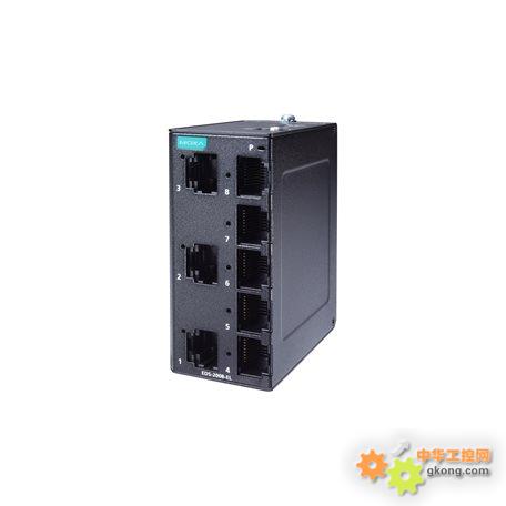

²úÆ·Ãû³Æ£º ̨Íåmoxa EDS-2008-EL 8 ¶Ë¿Ú·ÇÍø¹ÜÐͽ»»»»ú
ÐÍ ºÅ£º EDS-2008-EL
ÒÔÌ«Íø½Ó¿Ú
½»»»ÌØÐÔ
  • ´¦ÀíÀàÐÍ
    ´æ´¢×ª·¢
  • MAC µØÖ·±í´óС
    8 K
  • Êý¾Ý°ü»º³åÇø´óС
    4 Mb
DIP ¿ª¹ØÅäÖÃ
  • ÒÔÌ«Íø½Ó¿Ú
    QoS£¬¹ã²¥·ç±©±£»¤ (BSP)
µçÔ´²ÎÊý
  • Á¬½Ó
    1 ¸ö¿É²ðж 2 ´¥µã½ÓÏß¶Ë×Ó
  • ÊäÈëµçÁ÷
    EDS-2008-EL£º0.067A @ 24 VDC
    EDS-2008-EL-M-ST/EDS-2008-EL-M-SC£º0.105A @ 24 VDC
  • ÊäÈëµçѹ
    12/24/48 VDC
  • ¹¤×÷µçѹ
    9.6 ÖÁ 60 VDC
  • ¹ýÔØµçÁ÷±£»¤
    Ö§³Ö
  • ·´½Ó±£»¤
    Ö§³Ö
»úÐµÌØÐÔ
  • °²×°
    µ¼¹ìʽ°²×°£¬±Ú¹Òʽ°²×°£¨´ø¿ÉÑ¡Ì×¼þ£©
  • ÖØÁ¿
    163 g (0.36 lb)
  • Íâ¿Ç
    ½ðÊô
  • ³ß´ç
    EDS-2008-EL£º36 x 81 x 65 mm£¨1.4 x 3.19 x 2.56 Ó¢´ç£©
    EDS-2008-EL-M-ST£º36 x 81 x 70.9 mm£¨1.4 x 3.19 x 2.79 Ó¢´ç£©
    EDS-2008-EL-M-SC£º36 x 81 x 67.9 mm£¨1.4 x 3.19 x 2.67 Ó¢´ç£©
¹¤×÷»·¾³
  • Ïà¶Ôʪ¶È
    5 ÖÁ 95%£¨·ÇÀäÄý£©
  • ¹¤×÷ζÈ
    EDS-2008-EL/EDS-2008-EL-M-SC/EDS-2008-EL-M-ST£º-10 ÖÁ 60°C£¨14 ÖÁ 140°F£©
    EDS-2008-EL-T/EDS-2008-EL-M-SC-T/EDS-2008-EL-M-ST-T£º -40 ÖÁ 75°C£¨-40 ÖÁ 167°F£©
  • ´æ´¢Î¶ȣ¨º¬°ü×°£©
    -40 ÖÁ 85°C£¨-40 ÖÁ 185°F£©
°²¹æÈÏÖ¤
  • °²È«
    UL 61010-2-201¡¢EN 62368-1 (LVD)
  • EMC
    EN 55032/35
  • EMI
    CISPR 22£¬32£¬FCC Part 15B Class A
  • EMS
    IEC 61000-4-2 ESD£º½Ó´¥£º6 kV£»¿ÕÆø£º8 kV
    IEC 61000-4-3 RS£º80 MHz ÖÁ 1 GHz£º20 V/m
    IEC 61000-4-4 EFT£ºµçÔ´£º2 kV£»Ðźţº2 kV
    IEC 61000-4-5 Surge£ºµçÔ´£º2 kV£»Ðźţº2 kV
    IEC 61000-4-6 CS£º10 V
    IEC 61000-4-8 PFMF
  • ³å»÷
    IEC 60068-2-27
  • Õñ¶¯
    IEC 60068-2-6
  • ×ÔÓÉÂäÌå
    IEC 60068-2-32
MTBF
  • ʱ¼ä
    3,472,660 Сʱ
  • ±ê×¼
    Telcordia (Bellcore)£¬GB
±£ÐÞ
  • ±£ÐÞÆÚÏÞ5 Äê
