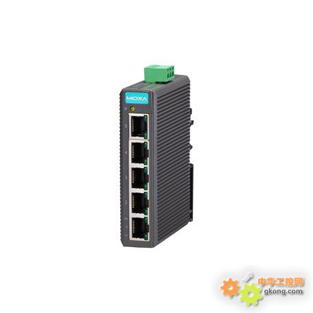

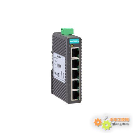

²úÆ·Ãû³Æ£º EDS-205 ϵÁÐ 5 ¶Ë¿Ú·ÇÍø¹ÜÐͽ»»»»ú
ÐÍ ºÅ£º EDS-205
ÒÔÌ«Íø½Ó¿Ú
  • ±ê×¼
    IEEE 802.3£¬ÓÃÓÚ 10BaseT
    IEEE 802.3u£¬ÓÃÓÚ 100BaseT(X) ºÍ 100BaseFX
    IEEE 802.3x£¬ÓÃÓÚÁ÷Á¿¿ØÖÆ
  • 10/100BaseT(X) ¶Ë¿Ú£¨RJ45 ½ÓÍ·£©
    È«/°ëË«¹¤Ä£Ê½
    ×Ô¶¯ MDI/MDI-X Á¬½Ó
    ËÙÂÊ×ÔÊÊÓ¦
½»»»ÌØÐÔ
  • ´¦ÀíÀàÐÍ
    ´æ´¢×ª·¢
  • MAC µØÖ·±í´óС
    1 K
  • Êý¾Ý°ü»º³åÇø´óС
    512 kb
µçÔ´²ÎÊý
  • ÊäÈëµçѹ
    24 VDC
  • ÊäÈëµçÁ÷
    0.11 A @ 24 VDC
  • ¹¤×÷µçѹ
    12 ÖÁ 48 VDC
  • Á¬½Ó
    1 ¸ö¿É²ðж 3 ´¥µã½ÓÏß¶Ë×Ó
  • ¹ýÔØµçÁ÷±£»¤
    1.1 A @ 24 VDC
  • ·´½Ó±£»¤
    Ö§³Ö
»úÐµÌØÐÔ
  • Íâ¿Ç
    ËÜÁÏ
  • IP µÈ¼¶
    IP30
  • ³ß´ç
    24.9 x 100 x 86.5 mm£¨0.98 x 3.94 x 3.41 Ó¢´ç£©
  • ÖØÁ¿
    135 g (0.30 lb)
  • °²×°
    µ¼¹ìʽ°²×°
¹¤×÷»·¾³
  • ¹¤×÷ζÈ
    -10 ÖÁ 60°C£¨14 ÖÁ 140°F£©
  • ´æ´¢Î¶ȣ¨º¬°ü×°£©
    -40 ÖÁ 85°C£¨-40 ÖÁ 185°F£©
  • Ïà¶Ôʪ¶È
    5 ÖÁ 95%£¨·ÇÀäÄý£©
°²¹æÈÏÖ¤
  • °²È«
    EN 60950-1£¬UL 508
  • EMC
    EN 55032/24
  • EMI
    CISPR 32£¬FCC Part 15B Class A
  • EMS
    IEC 61000-4-2 ESD£º½Ó´¥£º4 kV£»¿ÕÆø£º8 kV
    IEC 61000-4-3 RS£º80 MHz ÖÁ 1 GHz£º3 V/m
    IEC 61000-4-4 EFT£ºµçÔ´£º1 kV£»Ðźţº0.5 kV
    IEC 61000-4-5 Surge£ºµçÔ´£º1 kV£»Ðźţº1 kV
    IEC 61000-4-6 CS£º3 V
    IEC 61000-4-8 PFMF
  • ³å»÷
    IEC 60068-2-27
  • Õñ¶¯
    IEC 60068-2-6
  • ×ÔÓÉÂäÌå
    IEC 60068-2-31
MTBF
  • ʱ¼ä
    3,915,945 Сʱ
  • ±ê×¼
    Telcordia (Bellcore)£¬GB
±£ÐÞ
  • ±£ÐÞÆÚÏÞ
    5 Äê
