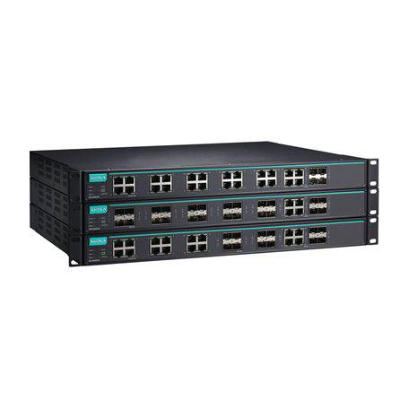

²úÆ·Ãû³Æ£º IKS-G6824AϵÁÐÒÔÌ«Íø½»»»»ú
ÐÍ ºÅ£º
̨ÍåMOXA IKS-G6824AϵÁÐÒÔÌ«Íø½»»»»úÈ«ÐÂÔ­×°ÏÖ»õ
IKS-G6824A-20GSFP-4GTXSFP-HV-HV
 IKS-G6824A-20GSFP-4GTXSFP-HV-HV-T
 IKS-G6824A-4GTXSFP-HV-HV
 IKS-G6824A-4GTXSFP-HV-HV-T
IKS-G6824A-8GSFP-4GTXSFP-HV-HV
 IKS-G6824A-8GSFP-4GTXSFP-HV-HV-T
  • ±¨¾¯¹¦ÄÜͨµÀ
    ´¿µç×èÐÔ¸ºÔØ£º2 A @ 30 VDC
  • Êý×ÖÊäÈë
    +13 ÖÁ +30 V ±íʾ״̬ 1
    -30 ÖÁ +1 V ±íʾ״̬ 0
    ÊäÈëµçÁ÷£º8 mA
ÒÔÌ«Íø½Ó¿Ú
  • 10/100/1000BaseT(X) ¶Ë¿Ú£¨RJ45 ½ÓÍ·£©
    IKS-G6824A-4GTXSFP-HV-HV ϵÁУº20
    IKS-G6824A-8GSFP-4GTXSFP-HV-HV ϵÁУº12
  • 100/1000BaseSFP ¶Ë¿Ú
    IKS-G6824A-8GSFP-4GTXSFP-HV-HV ϵÁУº8
    IKS-G6824A-20GSFP-4GTXSFP-HV-HV ϵÁУº20
  • Combo ¶Ë¿Ú£¨10/100/1000BaseT(X) »ò 100/1000BaseSFP+£©
    4
  • ±ê×¼
    IEEE 802.1D-2004£¬ÓÃÓÚÉú³ÉÊ÷ЭÒé (STP)
    IEEE 802.1p£¬ÓÃÓÚ·þÎñµÈ¼¶
    IEEE 802.1Q£¬ÓÃÓÚ VLAN ±ê¼Ç
    IEEE 802.1s£¬ÓÃÓÚ¶àÉú³ÉÊ÷ЭÒé (MSTP)
    IEEE 802.1w£¬ÓÃÓÚ¿ìËÙÉú³ÉÊ÷ЭÒé (RSTP)
    IEEE 802.1X£¬ÓÃÓÚÊÚȨÈÏÖ¤
    IEEE 802.3£¬ÓÃÓÚ 10BaseT
    IEEE 802.3ab£¬ÓÃÓÚ 1000BaseT(X)
    IEEE 802.3ad£¬ÓÃÓÚ LACP ¶Ë¿Ú¾ÛºÏ
    IEEE 802.3u£¬ÓÃÓÚ 100BaseT(X) ºÍ 100BaseFX
    IEEE 802.3x£¬ÓÃÓÚÁ÷Á¿¿ØÖÆ
    IEEE 802.3z£¬ÓÃÓÚ 1000BaseSX/LX/LHX/ZX
ÒÔÌ«ÍøÈí¼þÌØÐÔ
  • ¹ÜÀí
    ARP¡¢Back Pressure Flow Control£¨±³Ñ¹Á÷Á¿¿ØÖÆ£©¡¢BOOTP¡¢DDM¡¢DHCP Option 66/67/82¡¢DHCP Server/Client¡¢IPv4¡¢LLDP¡¢Port Mirror£¨¶Ë¿Ú¾µÏñ£©¡¢RMON¡¢SNMP Inform¡¢SNMPv1/v2c/v3¡¢Syslog¡¢Telnet¡¢TFTP¡¢SMTP¡¢RARP¡¢Flow control£¨Á÷Á¿¿ØÖÆ£©
  • ¹ýÂË
    802.1Q¡¢GMRP¡¢GVRP¡¢IGMP v1/v2/v3¡¢QinQ VLAN
  • ×鲥·ÓÉ
    DVMRP¡¢PIM-DM¡¢PIM-SM¡¢PIM-SSM
  • ÈßÓàЭÒé
    Á´Â·¾ÛºÏ¡¢MSTP¡¢RSTP¡¢Turbo Chain¡¢Turbo Ring v1/v2¡¢V-ON
  • ·ÓÉÈßÓà
    VRRP
  • °²È«
    ·ÃÎÊ¿ØÖÆÁÐ±í¡¢¹ã²¥·ç±©±£»¤¡¢HTTPS/SSL¡¢MAB ÊÚȨÈÏÖ¤¡¢Sticky MAC¡¢NTP ÊÚȨÈÏÖ¤¡¢¶Ë¿ÚËø¶¨¡¢RADIUS¡¢SSH¡¢TACACS+
  • ¶Ôʱ·þÎñ
    NTP Server/Client¡¢SNTP
  • µ¥²¥Â·ÓÉ
    OSPF£¬RIPV1/V2£¬¾²Ì¬Â·ÓÉ
  • ¹¤ÒµÐ­Òé
    EtherNet/IP, Modbus TCP, PROFINET
  • MIB
    Bridge MIB, Ethernet-like MIB, MIB-II, P-BRIDGE MIB, Q-BRIDGE MIB, RMON MIB Groups 1, 2, 3, 9, RSTP MIB
½»»»ÌØÐÔ
  • DRAM
    128 MB
  • ÉÁ´æ
    16 MB
  • IGMP ·Ö×é
    4096
  • ¾ÞÐÍÖ¡´óС
    9.6 KB
  • MAC µØÖ·±í´óС
    16 K
  • VLAN ÊýÁ¿
    256
  • Êý¾Ý°ü»º³åÇø´óС
    12 Mb
  • VLAN ID ·¶Î§
    VID 1 ÖÁ 4094
  • ÓÅÏȼ¶¶ÓÁÐ
    8
USB ½Ó¿Ú
  • ´æ´¢¶Ë¿Ú
    USB Type A
´®¿Ú½çÃæ
  • Console ¶Ë¿Ú
    USB ´®¿Ú console£¨Type B ½ÓÍ·£©
µçÔ´²ÎÊý
  • ÊäÈëµçѹ
    110 ÖÁ 220 VAC£¬ÈßÓàË«µçÔ´ÊäÈë
  • ¹¤×÷µçѹ
    85 ÖÁ 264 VAC
  • ¹ýÔØµçÁ÷±£»¤
    Ö§³Ö
  • ·´½Ó±£»¤
    Ö§³Ö
  • ÊäÈëµçÁ÷
    0.67/0.38 A @ 110/220 VAC
»úÐµÌØÐÔ
  • IP µÈ¼¶
    IP30
  • ³ß´ç
    440 x 44 x 386.9 mm£¨17.32 x 1.73 x 15.23 Ó¢´ç£©
  • ÖØÁ¿
    5100 g (11.25 lb)
  • °²×°
    »ú¼Üʽ°²×°
¹¤×÷»·¾³
  • ¹¤×÷ζÈ
    ±ê×¼Ðͺţº-10 ÖÁ 60°C£¨14 ÖÁ 140°F£©
    ¿íÎÂÐͺţº-40 ÖÁ 75°C£¨-40 ÖÁ 167°F£©
  • ´æ´¢Î¶ȣ¨º¬°ü×°£©
  • Ïà¶Ôʪ¶È
    5 ÖÁ 95%£¨·ÇÀäÄý£©
°²¹æÈÏÖ¤
  • °²È«
    EN 60950-1£¬UL 60950-1
  • EMC
    EN 55032/24
  • EMI
    CISPR 32£¬FCC Part 15B Class A
  • EMS
    IEC 61000-4-2 ESD£º½Ó´¥£º4 kV£»¿ÕÆø£º8 kV
    IEC 61000-4-3 RS£º80 MHz ÖÁ 1 GHz£º10 V/m
    IEC 61000-4-4 EFT£ºµçÔ´£º2 kV£»Ðźţº1 kV
    IEC 61000-4-5 Surge£ºµçÔ´£º2 kV£»Ðźţº1 kV
    IEC 61000-4-6 CS£º10 V
    IEC 61000-4-8 PFMF
  • ¹ìµÀ½»Í¨
    EN 50121-4
  • ×ÔÓÉÂäÌå
    IEC 60068-2-32
  • ³å»÷
    IEC 60068-2-27
  • Õñ¶¯
    IEC 60068-2-6
MTBF
  • ʱ¼ä
    460,854 Сʱ
  • ±ê×¼
    Telcordia (Bellcore)£¬GB
±£ÐÞ
  • ±£ÐÞÆÚÏÞ
    5 Äê
