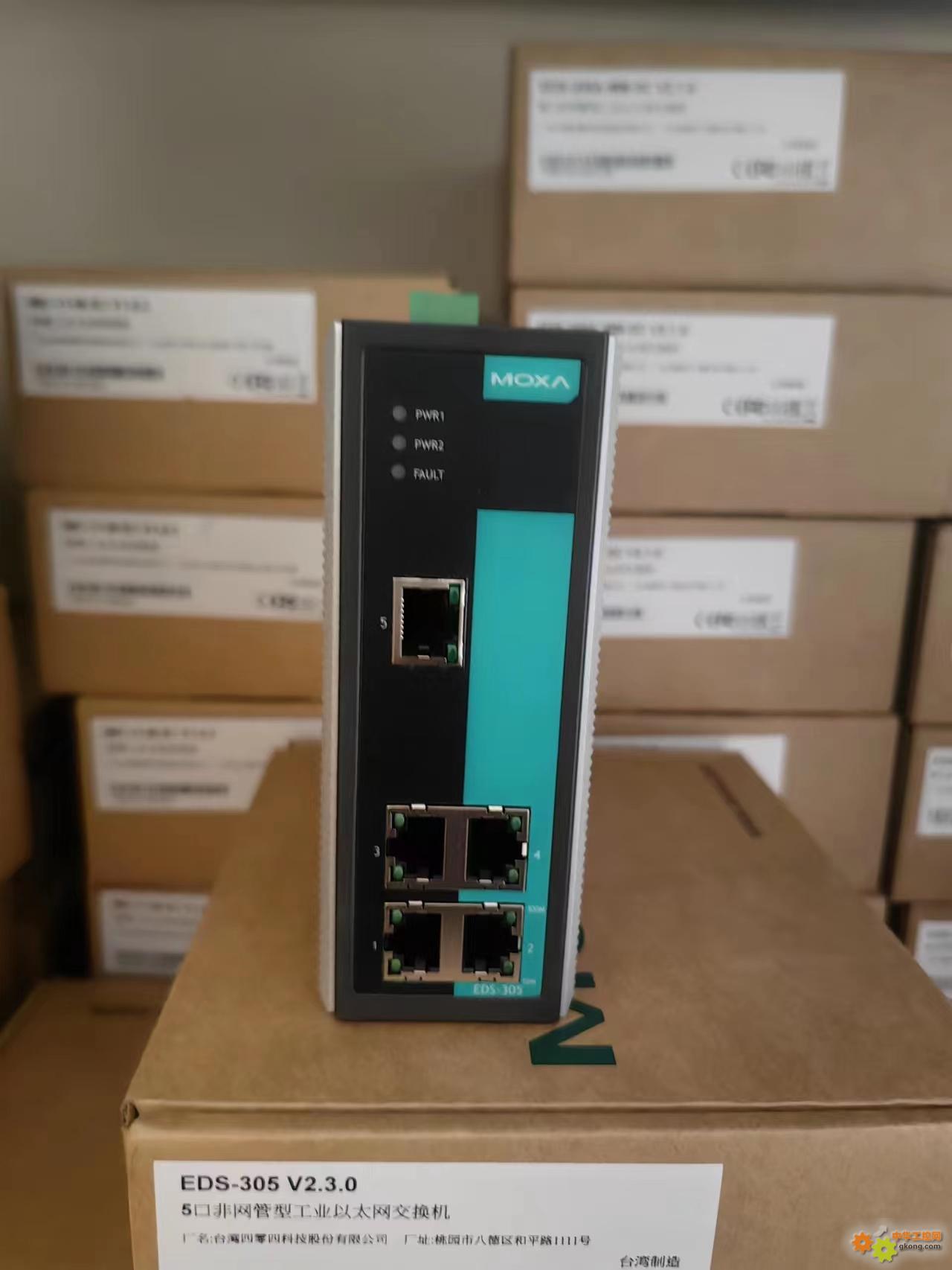

Öлª¹¤¿ØÍø ¡ú ¹¤¿Ø²úÆ· ¡ú EDS-305 ϵÁÐ 5 ¶Ë¿Ú·ÇÍø¹ÜÐͽ»»»»ú
²úÆ·Ãû³Æ£º EDS-305 ϵÁÐ 5 ¶Ë¿Ú·ÇÍø¹ÜÐͽ»»»»ú
ÐÍ ºÅ£º EDS-305
ÊäÈë/Êä³ö½Ó¿Ú
  • ±¨¾¯¹¦ÄÜͨµÀ
    ´¿µç×èÐÔ¸ºÔØ£º1 A @ 24 VDC
ÒÔÌ«Íø½Ó¿Ú
  • 10/100BaseT(X) ¶Ë¿Ú£¨RJ45 ½ÓÍ·£©
    EDS-305/305-T£º5
    EDS-305-M-SC/M-ST/S-SC ϵÁУ¬EDS-305-S-SC-80£º4
    ËùÓÐÐͺžùÖ§³Ö£º
    ËÙÂÊ×ÔÊÊÓ¦
    È«/°ëË«¹¤Ä£Ê½
    ×Ô¶¯ MDI/MDI-X Á¬½Ó
  • 100BaseFX ¶Ë¿Ú£¨¶àÄ£ SC ½ÓÍ·£©
    EDS-305-M-SC ϵÁУº1
  • 100BaseFX ¶Ë¿Ú£¨¶àÄ£ ST ½ÓÍ·£©
    EDS-305-M-ST ϵÁУº1
  • 100BaseFX ¶Ë¿Ú£¨µ¥Ä£ SC ½ÓÍ·£©
    EDS-305-S-SC£º1
    EDS-305-S-SC-T£º1
  • 100BaseFX ¶Ë¿Ú£¨µ¥Ä£ SC ½ÓÍ·£¬80 km£©
    EDS-305-S-SC-80£º1
  • ±ê×¼
    IEEE 802.3£¬ÓÃÓÚ 10BaseT
    IEEE 802.3u£¬ÓÃÓÚ 100BaseT(X) ºÍ 100BaseFX
    IEEE 802.3x£¬ÓÃÓÚÁ÷Á¿¿ØÖÆ
  • ¹âÏË
    ÔĶÁ¸ü¶à
DIP ¿ª¹ØÅäÖÃ
  • ÒÔÌ«Íø½Ó¿Ú
    ¶Ë¿ÚÖжϱ¨¾¯
½»»»ÌØÐÔ
  • MAC µØÖ·±í´óС
    1 K
  • Êý¾Ý°ü»º³åÇø´óС
    384 K
  • ´¦ÀíÀàÐÍ
    ´æ´¢×ª·¢
µçÔ´²ÎÊý
  • ÊäÈëµçÁ÷
    EDS-305/305-T£º0.11 A @ 24 VDC
    EDS-305-M/S ϵÁУº0.15 A @ 24 VDC
  • Á¬½Ó
    1 ¸ö¿É²ðж 6 ´¥µã½ÓÏß¶Ë×Ó
  • ¹¤×÷µçѹ
    12 ÖÁ 48 VDC
  • ÊäÈëµçѹ
    24 VDC£¬ÈßÓàË«µçÔ´ÊäÈë
  • ·´½Ó±£»¤
    Ö§³Ö
  • ¹ýÔØµçÁ÷±£»¤
    Ö§³Ö
»úÐµÌØÐÔ
  • Íâ¿Ç
    ½ðÊô
  • IP µÈ¼¶
    IP30
  • ³ß´ç
    53.6 x 135 x 105 mm£¨2.11 x 5.31 x 4.13 Ó¢´ç£©
  • ÖØÁ¿
    790 g (1.75 lb)
  • °²×°
    µ¼¹ìʽ°²×°£¬±Ú¹Òʽ°²×°£¨´ø¿ÉÑ¡Ì×¼þ£©
¹¤×÷»·¾³
  • ¹¤×÷ζÈ
    ±ê×¼Ðͺţº0 ÖÁ 60°C£¨32 ÖÁ 140°F£©
    ¿íÎÂÐͺţº-40 ÖÁ 75°C£¨-40 ÖÁ 167°F£©
  • ´æ´¢Î¶ȣ¨º¬°ü×°£©
    -40 ÖÁ 85°C£¨-40 ÖÁ 185°F£©
  • Ïà¶Ôʪ¶È
    5 ÖÁ 95%£¨·ÇÀäÄý£©
°²¹æÈÏÖ¤
  • EMI
    CISPR 32£¬FCC Part 15B Class A
  • º£ÊÂ
    DNV-GL
  • EMC
    EN 55032/24
  • Õñ¶¯
    IEC 60068-2-6
  • EMS
    IEC 61000-4-2 ESD£º½Ó´¥£º6 kV£»¿ÕÆø£º8 kV
    IEC 61000-4-3 RS£º80 MHz ÖÁ 1 MHz£º20 V/m
    IEC 61000-4-4 EFT£ºµçÔ´£º2 kV£»Ðźţº1 kV
    IEC 61000-4-5 Surge£ºµçÔ´£º2 kV£»Ðźţº2 kV
    IEC 61000-4-6 CS£º3 V
    IEC 61000-4-8 PFMF
  • °²È«
    UL 508¡¢UL 60950-1£¬CSA C22.2 ±àºÅ 60950-1
  • ³å»÷
    IEC 60068-2-27
  • ×ÔÓÉÂäÌå
    IEC 60068-2-32
MTBF
  • ʱ¼ä
    422,742 Сʱ
  • ±ê×¼
    MIL-HDBK-217F
±£ÐÞ
  • ±£ÐÞÆÚÏÞ
    5 Äê
