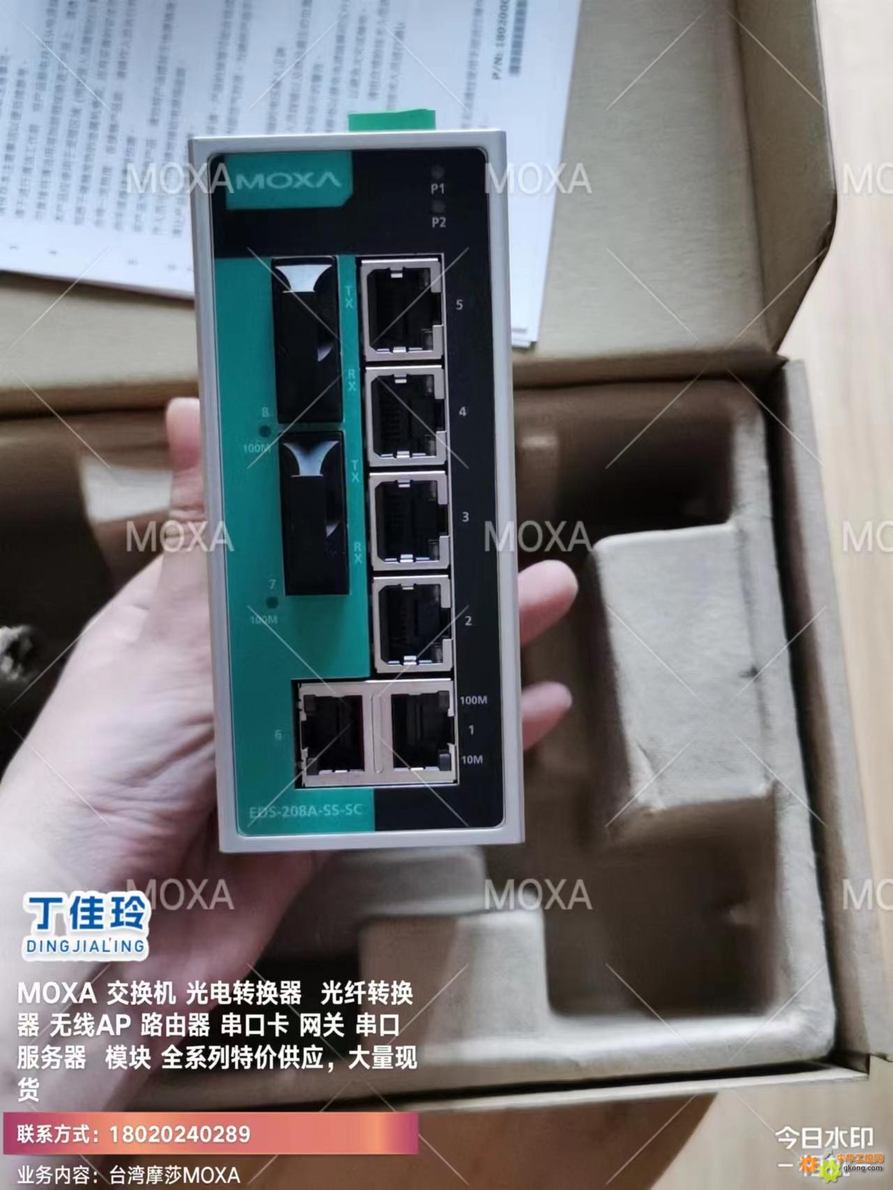

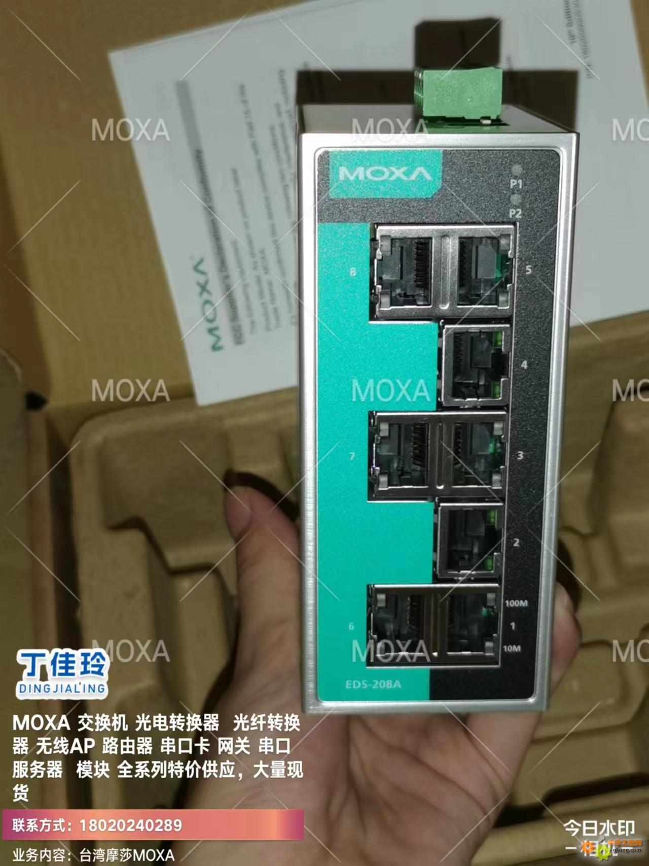

²úÆ·Ãû³Æ£º EDS-208A ϵÁÐ 8 ¶Ë¿Ú·ÇÍø¹ÜÐÍÒÔÌ«Íø½»»»»ú
ÐÍ ºÅ£º EDS-208A
ÒÔÌ«Íø½Ó¿Ú
  • 10/100BaseT(X) ¶Ë¿Ú£¨RJ45 ½ÓÍ·£©
    EDS-208A/208A-T£º8
    EDS-208A-M-SC/M-ST/S-SC ϵÁУº7
    EDS-208A-MM-SC/MM-ST/SS-SC ϵÁУº6
    ËùÓÐÐͺžùÖ§³Ö£º
    ËÙÂÊ×ÔÊÊÓ¦
    È«/°ëË«¹¤Ä£Ê½
    ×Ô¶¯ MDI/MDI-X Á¬½Ó
  • 100BaseFX ¶Ë¿Ú£¨¶àÄ£ SC ½ÓÍ·£©
    EDS-208A-M-SC ϵÁУº1
    EDS-208A-MM-SC ϵÁУº2
  • 100BaseFX ¶Ë¿Ú£¨¶àÄ£ ST ½ÓÍ·£©
    EDS-208A-M-ST ϵÁУº1
    EDS-208A-MM-ST ϵÁУº2
  • 100BaseFX ¶Ë¿Ú£¨µ¥Ä£ SC ½ÓÍ·£©
    EDS-208A-S-SC ϵÁУº1
    EDS-208A-SS-SC ϵÁУº2
  • ±ê×¼
    IEEE 802.3£¬ÓÃÓÚ 10BaseT
    IEEE 802.3u£¬ÓÃÓÚ 100BaseT(X) ºÍ 100BaseFX
    IEEE 802.3x£¬ÓÃÓÚÁ÷Á¿¿ØÖÆ
  • ¹âÏË
½»»»ÌØÐÔ
  • MAC µØÖ·±í´óС
    2 K
  • Êý¾Ý°ü»º³åÇø´óС
    768 kb
  • ´¦ÀíÀàÐÍ
    ´æ´¢×ª·¢
µçÔ´²ÎÊý
  • Á¬½Ó
    1 ¸ö¿É²ðж 4 ´¥µã½ÓÏß¶Ë×Ó
  • ÊäÈëµçÁ÷
    EDS-208A/208A-T£¬EDS-208A-M-SC/M-ST/S-SC ϵÁУº0.11 A @ 24 VDC
    EDS-208A-MM-SC/MM-ST/SS-SC ϵÁУº0.15 A @ 24 VDC
  • ÊäÈëµçѹ
    12/24/48 VDC£¬ÈßÓàË«µçÔ´ÊäÈë
  • ¹¤×÷µçѹ
    9.6 ÖÁ 60 VDC
  • ¹ýÔØµçÁ÷±£»¤
    Ö§³Ö
  • ·´½Ó±£»¤
    Ö§³Ö
DIP ¿ª¹ØÅäÖÃ
  • ÒÔÌ«Íø½Ó¿Ú
    ¹ã²¥·ç±©±£»¤
»úÐµÌØÐÔ
  • Íâ¿Ç
    ÂÁ
  • IP µÈ¼¶
    IP30
  • ³ß´ç
    50 x 114 x 70 mm£¨1.96 x 4.49 x 2.76 Ó¢´ç£©
  • ÖØÁ¿
    275 g (0.61 lb)
  • °²×°
    µ¼¹ìʽ°²×°£¬±Ú¹Òʽ°²×°£¨´ø¿ÉÑ¡Ì×¼þ£©
¹¤×÷»·¾³
  • ¹¤×÷ζÈ
    ±ê×¼Ðͺţº-10 ÖÁ 60°C£¨14 ÖÁ 140°F£©
    ¿íÎÂÐͺţº-40 ÖÁ 75°C£¨-40 ÖÁ 167°F£©
  • ´æ´¢Î¶ȣ¨º¬°ü×°£©
    -40 ÖÁ 85°C£¨-40 ÖÁ 185°F£©
  • Ïà¶Ôʪ¶È
    5 ÖÁ 95%£¨·ÇÀäÄý£©
°²¹æÈÏÖ¤
  • EMC
    EN 55032/24
  • EMI
    CISPR 32£¬FCC Part 15B Class A
  • EMS
    IEC 61000-4-2 ESD£º½Ó´¥£º6 kV£»¿ÕÆø£º8 kV
    IEC 61000-4-3 RS£º80 MHz ÖÁ 1 GHz£º10 V/m
    IEC 61000-4-4 EFT£ºµçÔ´£º2 kV£»Ðźţº1 kV
    IEC 61000-4-5 Surge£ºµçÔ´£º2 kV£»Ðźţº2 kV
    IEC 61000-4-6 CS£º10 V
    IEC 61000-4-8 PFMF
  • º£ÊÂ
    ABS¡¢DNV-GL¡¢LR¡¢NK
  • ¹ìµÀ½»Í¨
    EN 50121-4
  • °²È«
    UL 508
  • ³å»÷
    IEC 60068-2-27
  • ½»Í¨¿ØÖÆ
    NEMA TS2
  • Õñ¶¯
    IEC 60068-2-6
  • ×ÔÓÉÂäÌå
    IEC 60068-2-31
MTBF
  • ʱ¼ä
    2,701,531 Сʱ
  • ±ê×¼
    Telcordia (Bellcore)£¬GB
±£ÐÞ
  • ±£ÐÞÆÚÏÞ
    5 Äê
