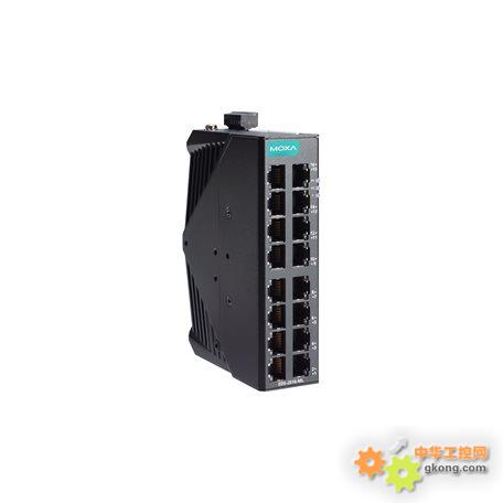

²úÆ·Ãû³Æ£º EDS-2016-ML ϵÁÐ 16 ¶Ë¿Ú·ÇÍø¹ÜÐͽ»»»»ú
ÐÍ ºÅ£º EDS-2016-ML
ÒÔÌ«Íø½Ó¿Ú
  • 10/100BaseT(X) ¶Ë¿Ú£¨RJ45 ½ÓÍ·£©
    EDS-2016-ML£º16
    EDS-2016-ML-T£º16
    EDS-2016-ML-MM-SC£º14
    EDS-2016-ML-MM-SC-T£º14
    EDS-2016-ML-MM-ST£º14
    EDS-2016-ML-MM-ST-T£º14
    EDS-2016-ML-SS-SC£º14
    EDS-2016-ML-SS-SC-T£º14
    ËÙÂÊ×ÔÊÊÓ¦
    È«/°ëË«¹¤Ä£Ê½
    ×Ô¶¯ MDI/MDI-X Á¬½Ó
  • 100BaseFX ¶Ë¿Ú£¨¶àÄ£ SC ½ÓÍ·£©
    EDS-2016-ML-MM-SC£º2
    EDS-2016-ML-MM-SC-T£º2
  • 100BaseFX ¶Ë¿Ú£¨¶àÄ£ ST ½ÓÍ·£©
    EDS-2016-ML-MM-ST£º2
    EDS-2016-ML-MM-ST-T£º2
  • 100BaseFX ¶Ë¿Ú£¨µ¥Ä£ SC ½ÓÍ·£©
    EDS-2016-ML-SS-SC£º2
    EDS-2016-ML-SS-SC-T£º2
  • ±ê×¼
    IEEE 802.3£¬ÓÃÓÚ 10BaseT
    IEEE 802.3u£¬ÓÃÓÚ 100BaseT(X)
    IEEE 802.3x£¬ÓÃÓÚÁ÷Á¿¿ØÖÆ
    IEEE 802.1p£¬ÓÃÓÚ·þÎñµÈ¼¶
  • ¹âÏË
    DIP ¿ª¹ØÅäÖÃ
  • ÒÔÌ«Íø½Ó¿Ú
    QoS£¬¹ã²¥·ç±©±£»¤£¬¶Ë¿ÚÖжϱ¨¾¯
ÊäÈë/Êä³ö½Ó¿Ú
  • ±¨¾¯¹¦ÄÜͨµÀ
    ´¿µç×èÐÔ¸ºÔØ£º1 A @ 24 VDC
½»»»ÌØÐÔ
  • MAC µØÖ·±í´óС
    8 K
  • Êý¾Ý°ü»º³åÇø´óС
    2 Mb
  • ´¦ÀíÀàÐÍ
    ´æ´¢×ª·¢
µçÔ´²ÎÊý
  • Á¬½Ó
    1 ¸ö¿É²ðж 6 ´¥µã½ÓÏß¶Ë×Ó
  • ÊäÈëµçÁ÷
    EDS-2016-ML£º0.108 A @ 24 VDC
    EDS-2016-ML-SS-SC£º0.204 A @ 24 VDC
    EDS-2016-ML-MM-SC£º0.192 A @ 24 VDC
    EDS-2016-ML-MM-ST£º0.204 A @ 24 VDC
  • ÊäÈëµçѹ
    12/24/48 VDC£¬ÈßÓàË«µçÔ´ÊäÈë
  • ¹¤×÷µçѹ
    9.6 ÖÁ 60 VDC
  • ¹ýÔØµçÁ÷±£»¤
    Ö§³Ö
  • ·´½Ó±£»¤
    Ö§³Ö
»úÐµÌØÐÔ
  • Íâ¿Ç
    ½ðÊô
  • IP µÈ¼¶
    IP30
  • ³ß´ç
    EDS-2016-ML£º36 x 135 x 95 mm£¨1.41 x 5.31 x 3.74 Ó¢´ç£©
    EDS-2016-ML-MM-SC£º58 x 135 x 95 mm£¨2.28 x 5.31 x 3.74 Ó¢´ç£©
  • ÖØÁ¿
    ·Ç¹âÏËÐͺţº486 g (1.07 lb)
    ¹âÏËÐͺţº648 g (1.43 lb)
  • °²×°
    µ¼¹ìʽ°²×°£¬±Ú¹Òʽ°²×°£¨´ø¿ÉÑ¡Ì×¼þ£©
¹¤×÷»·¾³
  • ¹¤×÷ζÈ
    EDS-2016-ML£º-10 ÖÁ 60°C£¨14 ÖÁ 140°F£©
    EDS-2016-ML-T£º-40 ÖÁ 75°C£¨-40 ÖÁ 167°F£©
  • ´æ´¢Î¶ȣ¨º¬°ü×°£©
    -40 ÖÁ 85°C£¨-40 ÖÁ 185°F£©
  • Ïà¶Ôʪ¶È
    5 ÖÁ 95%£¨·ÇÀäÄý£©
°²¹æÈÏÖ¤
  • °²È«
    UL 61010-2-201¡¢EN 62368-1(LVD)
  • EMC
    EN 55032/35
  • EMI
    CISPR 32£¬FCC Part 15B Class A
  • EMS
    IEC 61000-4-2 ESD£º½Ó´¥£º6 kV£»¿ÕÆø£º8 kV
    IEC 61000-4-3 RS£º80 MHz ÖÁ 1 MHz£º20 V/m
    IEC 61000-4-4 EFT£ºµçÔ´£º2 kV£»Ðźţº2 kV
    IEC 61000-4-5 Surge£ºµçÔ´£º2 kV£»Ðźţº2 kV
    IEC 61000-4-6 CS£º10 V
    IEC 61000-4-8 PFMF
  • ¹ìµÀ½»Í¨
    EN 50121-4
  • Õñ¶¯
    IEC 60068-2-6
  • ³å»÷
    IEC 60068-2-27
  • ×ÔÓÉÂäÌå
    IEC 60068-2-32
MTBF
  • ʱ¼ä
    2,070,826 Сʱ
  • ±ê×¼
    Telcordia (Bellcore)£¬GB
±£ÐÞ
  • ±£ÐÞÆÚÏÞ
    5 Äê
