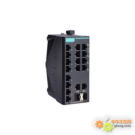

²úÆ·Ãû³Æ£º EDS-2018-ML ϵÁÐ 16+2G ¶Ë¿ÚǧÕ×·ÇÍø¹ÜÐͽ»»»»ú
ÐÍ ºÅ£º EDS-2018-ML
ÒÔÌ«Íø½Ó¿Ú
  • 10/100BaseT(X) ¶Ë¿Ú£¨RJ45 ½ÓÍ·£©
    16
    ×Ô¶¯ MDI/MDI-X Á¬½Ó
    È«/°ëË«¹¤Ä£Ê½
    ËÙÂÊ×ÔÊÊÓ¦
  • Combo ¶Ë¿Ú£¨10/100/1000BaseT(X) »ò 100/1000BaseSFP+£©
    2
    ËÙÂÊ×ÔÊÊÓ¦
    ×Ô¶¯ MDI/MDI-X Á¬½Ó
    È«/°ëË«¹¤Ä£Ê½
  • ±ê×¼
    IEEE 802.3£¬ÓÃÓÚ 10BaseT
    IEEE 802.3u£¬ÓÃÓÚ 100BaseT(X)
    IEEE 802.3ab£¬ÓÃÓÚ 1000BaseT(X)
    IEEE 802.3z£¬ÓÃÓÚ 1000BaseX
    IEEE 802.3x£¬ÓÃÓÚÁ÷Á¿¿ØÖÆ
    IEEE 802.1p£¬ÓÃÓÚ·þÎñµÈ¼¶
½»»»ÌØÐÔ
  • MAC µØÖ·±í´óС
    8 K
  • Êý¾Ý°ü»º³åÇø´óС
    4 Mb
  • ´¦ÀíÀàÐÍ
    ´æ´¢×ª·¢
DIP ¿ª¹ØÅäÖÃ
  • ÒÔÌ«Íø½Ó¿Ú
    QoS£¬¹ã²¥·ç±©±£»¤£¬¶Ë¿ÚÖжϱ¨¾¯
µçÔ´²ÎÊý
  • Á¬½Ó
    1 ¸ö¿É²ðж 6 ´¥µã½ÓÏß¶Ë×Ó
  • ÊäÈëµçÁ÷
    0.277 A @ 24 VDC
  • ÊäÈëµçѹ
    12/24/48 VDC£¬ÈßÓàË«µçÔ´ÊäÈë
  • ¹¤×÷µçѹ
    9.6 ÖÁ 60 VDC
  • ¹ýÔØµçÁ÷±£»¤
    Ö§³Ö
  • ·´½Ó±£»¤
    Ö§³Ö
»úÐµÌØÐÔ
  • Íâ¿Ç
    ½ðÊô
  • IP µÈ¼¶
    IP30
  • ³ß´ç
    58 x 135 x 95 mm£¨2.28 x 5.31 x 3.74 Ó¢´ç£©
  • ÖØÁ¿
    683 g (1.51 lb)
  • °²×°
    µ¼¹ìʽ°²×°£¬±Ú¹Òʽ°²×°£¨´ø¿ÉÑ¡Ì×¼þ£©
¹¤×÷»·¾³
  • ¹¤×÷ζÈ
    EDS-2018-ML-2GTXSFP£º-10 ÖÁ 60°C£¨14 ÖÁ 140°F£©
    EDS-2018-ML-2GTXSFP-T£º-40 ÖÁ 75°C£¨-40 ÖÁ 167°F£©
  • ´æ´¢Î¶ȣ¨º¬°ü×°£©
    -40 ÖÁ 85°C£¨-40 ÖÁ 185°F£©
  • Ïà¶Ôʪ¶È
    5 ÖÁ 95%£¨·ÇÀäÄý£©
°²¹æÈÏÖ¤
  • °²È«
    UL 61010-2-201¡¢EN 62368-1(LVD)
  • EMC
    EN 55032/35
  • EMI
    CISPR 32£¬FCC Part 15B Class A
  • EMS
    IEC 61000-4-2 ESD£º½Ó´¥£º6 kV£»¿ÕÆø£º8 kV
    IEC 61000-4-3 RS£º80 MHz ÖÁ 1 MHz£º20 V/m
    IEC 61000-4-4 EFT£ºµçÔ´£º2 kV£»Ðźţº2 kV
    IEC 61000-4-5 Surge£ºµçÔ´£º2 kV£»Ðźţº2 kV
    IEC 61000-4-6 CS£º10 V
    IEC 61000-4-8 PFMF
  • ¹ìµÀ½»Í¨
    EN 50121-4
  • Õñ¶¯
    IEC 60068-2-6
  • ³å»÷
    IEC 60068-2-27
  • ×ÔÓÉÂäÌå
    IEC 60068-2-32
MTBF
  • ʱ¼ä
    1,776,132 Сʱ
  • ±ê×¼
    Telcordia (Bellcore)£¬GB
±£ÐÞ
±£ÐÞÆÚÏÞ5Äê
Äê
