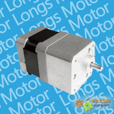

产品名称: 步进齿轮箱电机---42BYGH
型  号: 42BYGH
Electrical Specifications:(技术参数)
Model
Step
angel
Motor Length
L(mm)
Rate Voltage
(V)
Rate Current
(A)
Phase Resistance
(Ω)
Phase Inductance
(mH)
Holding
Torque
(N.m)
Lead Wire
(No.)
Rotor Inertia
(g.C㎡)
Detent Torque
(g.㎝)
Motor Weight
42BYGH3404-27AG30
1.8
        34
12
0.4
30
37
0.26
4
34
200
0.25
42BYGH0412-07AG30
1.8
40
3.6
1.2
3
3.2
0.26
4
54
220
0.3
42BYGH4604-AG30
1.8
48
12
0.4
30
0.45
6
68
280
0.4
