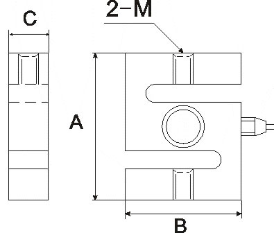

ZRN602ϵÁÐÓ¦±äʽÀ­Ñ¹Á¦´«¸ÐÆ÷£¬²ÉÓÃSÐ͵¯ÐÔÔª¼þ½á¹¹£¬¾ßÓÐÓÅÁ¼µÄ×ÔÈ»ÏßÐÔ£¬Æä¾«¶È¸ß£¬¿¹Æ«ÔزàÏòÄÜÁ¦Ç¿£¬¶Ô³ÆÐԺ㬿ÉÀ­Ñ¹Á½Ó㬲ÉÓü¤¹âº¸½ÓÃܷ⣬¸ÄÉÆÁË´«¸ÐÆ÷µÄ·À³±ÄÜÁ¦¡£Ó¦ÓÃÓÚµõ¹´³Æ¡¢ÅäÁϳӡ¢Æ¤´ø³Æ¡¢µç×Ó°õ³ÆÖУ¬ÒÔ¼°¸÷ÖÖ¹¤ÒµÏµÍ³ÖÐ×öÁ¦µÄ·ÖÎöºÍ²âÁ¿¡£
ÐÔÄÜÖ¸±ê
Ö÷Òª¼¼ÊõÖ¸±ê
´«¸ÐÆ÷
±äËÍÆ÷
³ÐÔØ·½Ê½
À­Ê½¡¢Ñ¹Ê½¡¢À­Ñ¹Ò»Ìå¡¢
Êä³öÁéÃô¶È
2¡À0.01 mv/v
4¡«20mA ¡¢0¡«5VDC¡¢1-5VDC
׼ȷ¶È
¡À0.02%FS¡¢¡À0.03%FS¡¢¡À0.05%FS
£¨ÏßÐÔ+Öͺó+ÖØ¸´ÐÔ£©
¡À0.03%FS¡¢0.05%FS¡¢0.1%FS
£¨ÏßÐÔ+Öͺó+ÖØ¸´ÐÔ£©
Èä±ä
¡À0.03%FS/30min
ζȶÔÁãµãÓ°Ïì
¡À0.03%FS/¡æ
¡À0.03 FS/¡æ
ζȶÔÁ¿³ÌÓ°Ïì
¡À0.02%FS/¡æ
¡À0.02%FS/¡æ
Êä³öµç×è
350¡À3¦¸
¡Ü9K¦¸
¾øÔµµç×è
¡Ý3000 M¦¸
¡Ý1000 M¦¸
¹©Çŵçѹ
9¡«15 VDC
10¡«36 VDC
ÔÊÐíζȷ¶Î§
£­30¡«£«70¡æ/£«85¡æ
£­30¡«£«70¡æ/£«85 ¡æ
ÔÊÐí¹ý¸ººÉ
150%FS
150%FS
·À»¤µÈ¼¶
IP67
IP67
Á¿³ÌÓë°²×°ÍâÐͳߴç¶ÔÕÕ±í
¡¡Á¿³Ì\³ß´ç
B
A
C
M
5~50
51
64
12.7
8¡Á1.25
100~700
51
76
19.1
12¡Á1.75
1000~1500
51
76
25.4
12¡Á1.75
2000~5000
76.2
108
25.4
20¡Á2.5
7500~10000
127
178
51
30¡Á3.5
20000
140
188
60
36¡Á3
