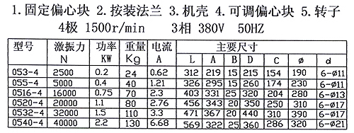

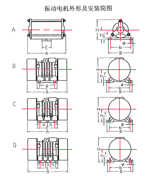

Õñ¶¯Ô´ÈýÏàÒì²½µç¶¯»ú¼¼Êõ²ÎÊý¼°Ö÷Òª³ß´ç |
¾øÔµµÈ¼¶:B ·À»¤µÈ¼¶:IP55 µçѹ:380V ÏàÊý:3Ïà ¼¤ÕñÁ¦µ÷½Ú·¶Î§:0-×î´ó ¶¨¶î:Á¬Ðø |
| ÐͺŠ|
Õñ´Î |
¼¤ÕñÁ¦ |
¹¦ÂÊ |
µçÁ÷ |
ÖØÁ¿ |
ͼºÅ |
A |
B |
H |
h |
a |
b |
E |
F |
r/min |
N |
Kw |
A |
Kg |
mm |
mm |
mm |
mm |
mm |
mm |
mm |
mm |
mm |
| ZDS-0.6-2 |
2800 |
650 |
0.05 |
0.2 |
4 |
A |
168 |
120 |
97 |
46 |
100 |
9 |
40 |
8 |
| ZDS-1.5-2 |
2860 |
1500 |
0.1 |
0.3 |
12 |
B |
255 |
160 |
156 |
80 |
40 |
130 |
11 |
100 |
15 |
| ZDS-2-2 |
2860 |
2000 |
0.15 |
0.5 |
12 |
B |
255 |
160 |
156 |
80 |
40 |
130 |
11 |
100 |
15 |
| ZDS-5-2 |
2860 |
5000 |
0.37 |
1.1 |
24 |
B |
285 |
185 |
190 |
90 |
120 |
150 |
13 |
150 |
30 |
| ZDS-10-2 |
2860 |
10000 |
0.75 |
1.96 |
36 |
B |
425 |
210 |
226 |
110 |
130 |
170 |
17 |
170 |
25 |
| ZDS-20-2 |
2860 |
20000 |
1.5 |
3 |
80 |
B |
480 |
320 |
285 |
135 |
190 |
260 |
25 |
250 |
30 |
| ZDS-30-2 |
2860 |
30000 |
2.2 |
4.65 |
100 |
B |
590 |
380 |
320 |
146 |
160 |
310 |
33 |
260 |
25 |
| ZDS-50-2 |
2860 |
50000 |
3.7 |
7.5 |
205 |
B |
665 |
460 |
390 |
195 |
250 |
380 |
38 |
340 |
35 |
| ZDS-2-4 |
1450 |
2000 |
0.12 |
0.37 |
16 |
B |
280 |
160 |
180 |
80 |
40 |
130 |
11 |
100 |
15 |
| ZDS-2.5-4 |
1450 |
2500 |
0.2 |
0.62 |
24 |
B |
350 |
185 |
190 |
90 |
120 |
150 |
13 |
150 |
30 |
| ZDS-5-4 |
1450 |
5000 |
0.4 |
1.21 |
36 |
B |
390 |
210 |
226 |
110 |
130 |
170 |
13 |
170 |
25 |
| ZDS-10-4 |
1450 |
10000 |
0.75 |
2.25 |
62 |
B |
460 |
270 |
270 |
120 |
160 |
220 |
21 |
220 |
25 |
| ZDS-20-4 |
1450 |
20000 |
1.1 |
2.76 |
85 |
B |
530 |
320 |
285 |
135 |
190 |
260 |
25 |
250 |
30 |
| ZDS-30-4 |
1450 |
30000 |
1.5 |
3.3 |
130 |
B |
540 |
350 |
340 |
163 |
180 |
280 |
33 |
250 |
30 |
| ZDS-50-4 |
1450 |
50000 |
2.2 |
6.68 |
180 |
B |
580 |
390 |
340 |
165 |
160 |
310 |
38 |
286 |
30 |
| ZDS-80-4 |
1450 |
80000 |
3.7 |
8.7 |
260 |
C |
710 |
460 |
380 |
195 |
125 |
380 |
38 |
364 |
35 |
| ZDS-2.5-6 |
960 |
2500 |
0.2 |
0.69 |
25 |
B |
350 |
185 |
190 |
90 |
120 |
150 |
13 |
150 |
30 |
| ZDS-5-6 |
960 |
5000 |
0.4 |
1.18 |
40 |
B |
390 |
210 |
226 |
110 |
130 |
170 |
13 |
170 |
25 |
| ZDS-10-6 |
960 |
10000 |
0.75 |
2.2 |
75 |
B |
510 |
310 |
285 |
140 |
160 |
220 |
21 |
220 |
25 |
| ZDS-13-6 |
960 |
13000 |
0.8 |
2.32 |
81 |
B |
510 |
310 |
285 |
140 |
165 |
250 |
25 |
220 |
25 |
| ZDS-18-6 |
960 |
18000 |
1.1 |
3 |
115 |
B |
530 |
320 |
315 |
163 |
190 |
260 |
25 |
250 |
25 |
| ZDS-20-6 |
960 |
20000 |
1.5 |
3.5 |
125 |
B |
530 |
320 |
315 |
163 |
190 |
260 |
25 |
250 |
25 |
| ZDS-25-6 |
960 |
25000 |
1.5 |
3.92 |
145 |
B |
540 |
350 |
340 |
163 |
180 |
280 |
33 |
250 |
30 |
| ZDS-30-6 |
960 |
30000 |
2.2 |
4.9 |
155 |
B |
540 |
350 |
340 |
163 |
180 |
280 |
33 |
250 |
30 |
| ZDS-36-6 |
960 |
36000 |
2.2 |
5.52 |
175 |
B |
600 |
380 |
360 |
190 |
225 |
310 |
33 |
285 |
35 |
| ZDS-40-6 |
960 |
40000 |
3 |
6.5 |
190 |
B |
600 |
380 |
360 |
190 |
225 |
310 |
33 |
285 |
35 |
| ZDS-50-6 |
960 |
50000 |
3.7 |
9.15 |
290 |
B |
710 |
460 |
390 |
195 |
250 |
380 |
38 |
340 |
35 |
| ZDS-75-6 |
960 |
75000 |
5.5 |
12.2 |
372 |
C |
770 |
480 |
440 |
210 |
125 |
380 |
38 |
370 |
38 |
| ZDS-100-6 |
960 |
100000 |
7.5 |
17.9 |
480 |
C |
830 |
460 |
470 |
230 |
140 |
380 |
38 |
430 |
35 |
| ZDS-130-6 |
960 |
130000 |
9.5 |
21.7 |
620 |
C |
880 |
550 |
500 |
250 |
140 |
460 |
45 |
440 |
40 |
| ZDS-160-6 |
960 |
160000 |
12 |
24.8 |
740 |
D |
1040 |
550 |
500 |
250 |
118 |
460 |
38 |
500 |
40 |
| ZDS-180-6 |
960 |
180000 |
14 |
31.9 |
760 |
D |
1000 |
610 |
540 |
270 |
120 |
520 |
45 |
525 |
40 |
| ZDS-220-6 |
960 |
22000 |
18 |
34.5 |
1040 |
D |
1050 |
665 |
580 |
295 |
140 |
560 |
45 |
585 |
45 |
| ZDS-200-8 |
740 |
200000 |
15 |
35 |
1090 |
D |
1110 |
610 |
605 |
305 |
140 |
520 |
45 |
580 |
40 |
| ZDS-32-4 |
1450 |
10000 |
0.8 |
3 |
60 |
B |
420 |
230 |
235 |
120 |
170 |
180 |
18 |
220 |
25 |

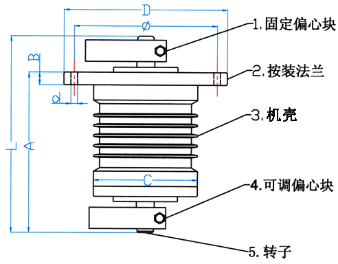

Á¢Ê½Õñ¶¯µç»ú |
4¼«¡¡1500r/min 3Ïà¡¡380V¡¡50HZ ¡¡¡¡ |
