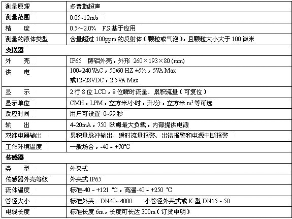

ÐÍ ºÅ£º DMS901
¶àÆÕÀչ̶¨°²×°Íâ¼Ðʽ³¬ÉùÁ÷Á¿¼Æ

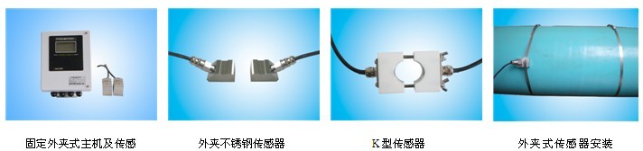

ÕæÕý·Ç½Ó´¥Ê½µÄ¹ÜÍâ²âÁ¿£¬ÒªÇó¹ÜµÀ²ÄÖʾùÔÈÖÂÃÜ£¬µ¼ÉùÁ¼ºÃ
±ê×¼Íâ¼Ðʽ´«¸ÐÆ÷ÊʺϲâÁ¿¿Ú¾¶DN40 ~ 4000£¬Ð¡¹Ü¾¶Íâ¼Ðʽ»òKÐÍ´«¸ÐÆ÷ÊʺϲâÁ¿¿Ú¾¶DN15 ~ 50¡£
±ê×¼ÐÍ´«¸ÐÆ÷ÊʺϲâÁ¿Á÷Ìåζȷ¶Î§Îª£º-40~120 ¡æ£¬¿ÉÒÔÌṩ´ÅÁ¦Îü³ÖÐͰ²×°¡£
¸ßÎÂÐÍ´«¸ÐÆ÷ÊʺϲâÁ¿Á÷Ìåζȷ¶Î§Îª£º-40~250 ¡æ
µäÐÍÓ¦Óúͽâ¾ö·½°¸
          ¸÷ÖÖº¬¹ÌÌå»òÆøÅݵÄÂú¹ÜÁ÷¶¯ÒºÌ壬ÈçÎÛË®¡¢·ÏË®¡¢Ö½½¬¡¢¿ó½¬¡¢ÓÍÌï×ê¾®¹à½¬Òº¡¢º¬ÓÍÎÛË®¡¢¸Û¿ÚÍÚÄà´¬ÍÚÎüµÄÁ÷ÌåµÈ¡£
          ÒªÇó¹ÜµÀ²ÄÖÊ£º¾ùÔÈÖÂÃÜ£¬µ¼ÉùÁ¼ºÃ¡£Í¬Ê±ÓÐ×ã¹»³¤µÄÖ±¹Ü¶Î£¬·ñÔò»á½µµÍ²âÁ¿¾«¶È¡£
¼¼ÊõÖ¸±ê
              ¶àÆÕÀչ̶¨°²×°Íâ¼Ðʽ³¬ÉùÁ÷Á¿¼Æ¼¼ÊõÖ¸±ê
