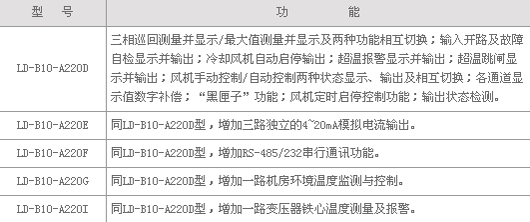

ÐÍ ºÅ£º LD-B10-A220D
  LD-B10-A220ϵÁиɱäÎÂ¿ØÆ÷£¨ÏâǶÐÍ£©

¶þ¡¢Ðͺż°¹¦ÄÜ
