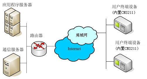

CNS211ǶÈëʽ´®¿Ú·þÎñÆ÷Êdzɶ¼ÖÚɽ¿Æ¼¼ÓÐÏÞ¹«Ë¾¿ª·¢µÄ¹¤Òµ¼¶´®¿ÚÁªÍøÄ£¿é¡£¼¯³ÉTCP/IP¡¢UDP¡¢ICMP¡¢IGMP¡¢DNS¡¢ARP¡¢DHCPµÈÖڶิÔÓÍøÂçЭÒéºÍSOCKET²å¿Ú±ê×¼£¬ÌṩTCP Server¡¢TCP Client¡¢TCP Auto¡¢Real COM¡¢UDP Master¡¢UDP Slave£¬UDP¹ã²¥¡¢UDP×é²¥¶àÖÖ¹¤×÷ģʽ£¬ÎªÓû§µÄ´®¿ÚÉ豸ÇáËÉʵÏÖÍøÂ繦ÄÜ¡£
CNS211¾ß±¸³¬¸ßÐԼ۱ȣ¬¿É¹ã·ºÓ¦ÓÃÓÚÃŽû¿¼ÇÚÉ豸ÁªÍø¹ÜÀí¡¢Éú²úÉ豸ÁªÍø¹ÜÀí¡¢µçÁ¦É豸ÁªÍø¼à¿Ø¡¢¹¤ÒµÁ÷³ÌÁªÍø¿ØÖÆ¡¢Ò½ÁÆÒÇÆ÷ÁªÍø×Ô¶¯»¯µÈÁìÓò¡£
ϵͳ¼Ü¹¹
»ù±¾¹¦ÄÜ ÔöÇ¿¹¦ÄÜ
¼¯³ÉTCP/IPЭÒéÕ»£¬È«Í¸Ã÷´«Êä
´®¿Úת10/100M ×ÔÊÊÓ¦ÒÔÌ«Íø½Ó¿Ú
ÌṩTTLµçƽ´®¿Ú
Ìṩ4λÊý×ÖI/O¿Ú
Ö§³ÖͼÐλ¯²ÎÊýÅäÖÃ
ÍêÉÆµÄ×Ô¶¯ÖØÁª»úÖÆ,Ç¿´óµÄÊý¾Ý
  ͨµÀ×Ô»Ö¸´ÄÜÁ¦
Ö§³ÖDNS½âÎö,·þÎñÆ÷¶Ë¿É²ÉÓù̶¨IP»ò¶¯Ì¬ÓòÃû
Ö§³ÖDHCP,Äܹ»ÔÚ¾ÖÓòÍøÄÚ×Ô¶¯·ÖÅäIPµØÖ·
Ö§³ÖÊý¾ÝÖÐÐÄÐéÄâ´®¿Ú£¬¼æÈÝ´óÁ¿ÒÑÓÐÓ¦ÓÃÈí¼þ
Ö§³Öµã¶Ôµã¡¢µã¶Ô¶àµã¡¢¶àµã¶Ô¶àµã¶ÔµÈ  Êý¾Ý´«Êä
Ö§³Ö±¾µØ´®¿ÚÉý¼¶
Ö§³Ö300-115200¿í·¶Î§²¨ÌØÂÊ,Ö§  ³ÖÊý¾Ýλ,ÆæÅ¼Ð£Ñéλ,ֹͣλÉèÖÃ,Ö§³ÖÓ²¼þÁ÷¿Ø
Ö§³Ö´®¿Ú͸Ã÷ͨÐÅ/Ö¡¸ñʽͨÐÅ
ʹÓÃUDP¹ã²¥»òGroup×鲥ģʽ¿ÉÇáËÉʵÏÖRS485É豸ͨ¹ýÒÔÌ«Íø»¥Áª
ÀûÓÃά»¤¶Ë¿Ú¿ÉÒÔʹÓÃTCP½øÐвÎÊýÅäÖÃ
Ö§³Ö4λI/O¿Ú£¬¿ÉÈÎÒâÅäÖóÉÊäÈëÊä³ö£¬ÀûÓÃά»¤¶Ë¿Ú½øÐÐIO²Ù×÷£¬ÊäÈëIO¿ÉÅäÖóÉÉÏÉýÑØ/ϽµÑØ/Ë«ÑØ´¥·¢Ö÷¶¯¸æ¾¯
²úÆ·ÓÅÊÆ
Ìå»ý¼«Ð¡,Ò×ÓÚǶÈ뼯³É
ÌṩTCP Server£¬TCP Client£¬TCP Auto£¬Real COM£¬UDP Master£¬UDP Slave£¬UDP¹ã²¥£¬UDP×é²¥¶àÖÖ¹¤×÷ģʽ
Ö§³Ö¾ÖÓòÍø/¹ãÓòÍøÊý¾Ý´«Êä
Ö§³Ö´®¿Ú¼°ÍøÂ緽ʽÅäÖÃ
²ÉÓÃTCPÁ¬½Óʵʱ¼ì²â¼¼Êõ,¼°Ê±»Ö¸´±»ÖжϵÄTCPÁ¬½Ó
Êý¾Ý°üȫ͸Ã÷1:1ÕæÊµ×ª»»
¸´ºÏʽ¿´ÃŹ·¼¼Êõ£¬ÓÀ²»ËÀ»ú
ÊÊÓ¦µÍκ͸ßι¤×÷»·¾³
