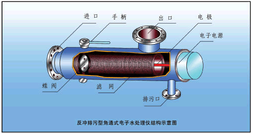

HSCD£¨P£©¶à¹¦Äܵç×ÓË®´¦ÀíÆ÷ÊÇÔÚÎÒ¹«Ë¾Éú²úµÄHSCDϵÁж๦Äܵç×Ó³ý¹¸Æ÷µÄ»ù´¡ÉÏÑÐÖÆ¿ª·¢³öÒ»ÖÖ¼ÈÄÜÏû³ýË®ÖнṸ£¬É±¾ú¡¢ÃðÔ壬ÓÖÄÜʵÏֶ༶¹ýÂ˲¢Í¨¹ý·´³åÏ´ÅųýË®ÖÐÔÓÖÊ΢Á£µÄ¶à¹¦ÄÜË®´¦ÀíÉ豸¡£
¶þ¡¢µç×Ó³ý¹¸¹ýÂËÆ÷Èý²¿·Ö×é³É£º
Ë®´¦ÀíÆ÷¿ÇÌ塪¡ª¸ÖÖÆÍ²Ì壬ͲÌåÄÚ×°ÓнðÊôÑô¼«Óë¹ýÂËÍø¡£
¹ýÂËÆ÷¡ª¡ªÓɲ»Ðâ¸Ö¹ýÂËÍøÍ²Óë·´³åÏ´µû·§×é³É¡£¹ýÂËÍøÍ²Ç°¶ËµÄ×Ô¶¯·´³åÏ´µû·§¸ºÔð¶ÔÍøÍ²½øÐÐ×Ô¶¯·´³åÏ´£¬Æä¹¤×÷Ô­ÀíÓë×Ô¶¯·´³åÏ´ÅÅÎÛ¹ýÂËÆ÷Ïàͬ¡£ÓÉÓÚ¿ÇÌåÄÚ×°ÓнðÊôÑô¼«£¬ÔÚ¸ßÆµ·¢ÉúÆ÷²úÉúµÄ¸ßƵ½»±äµç´Å³¡×÷ÓÃÏ£¬ÄܶԿÇÌåÄÚµÄË®ÖʽøÐгý¹¸¡¢É±¾ú¡¢ÃðÔåµÈ×÷Óã¬ÆäÔ­ÀíÓëµç×Ó³ý¹¸Æ÷Ïàͬ£¬´Ó¶ø´ïµ½¼ÈÏû³ýË®ÖнṸ¡¢É±¾ú¡¢ÃðÔåµÄ¹¦ÄÜ£¬ÓÖ¹ýÂ˲¢ÅųýÁËË®ÖеÄÔÓÖÊ΢Á££¬¹ÊÓÖÃûµç×Ó³ý¹¸¹ýÂËÆ÷¡£

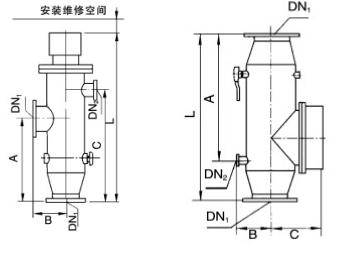

ËÄ¡¢ÍâÐγߴçͼ
  HSCD-LÐͳߴçͼ                 HSCD-IÐͳߴçͼ
