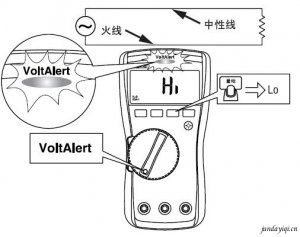

¾ßÓÐÓÃÓڷǽӴ¥µçѹ¼ì²âµÄ VoltAlert™ ¼¼Êõ

Fluke 117Cµçѹ²âÁ¿ÍòÓñíµÄ½á¹¹Í¼
