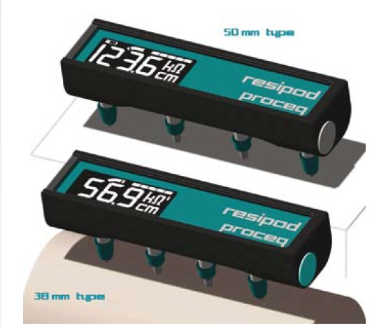

Respiod-5ÐͺźÍ̽ͷ¼ä¾à
µ±²âÁ¿ÖîÈç»ìÄýÍÁÖ®ÀàµÄ²»¾ùÔȲÄÁÏʱ£¬Ì½Í·¼ä¾àÔ½¿í£¬ÌṩµÄ¶ÁÊý¸üÒ»Ö¡£È»¶ø£¬Èç¹û¼ä¾à¹ý¿í£¬ÔòÊֽܸîÓ°Ï죬²âÁ¿Ô½Î£ÏÕ¡£ÐÐÒµ±ê×¼µÄ 50 mm ̽ͷ¼ä¾àÒ»Ö±±»ÊÓΪÊÇÒ»¸öºÃµÄÕÛÖа취¡£38mm (1.5¡±) ÐͺÅÊÇΪ×ñÑ­ AASHTO ±ê×¼¡°»ìÄýÍÁµÄ±íÃæµç×èÂʶÔ×迹ÂÈÀë×ÓÉøÍ¸µÄÐÔÄܵÄÓ°Ï족¶ø×¨ÃÅÉè¼ÆµÄ¡£±íÃæµç×èÂÊ (SR) ²âÊÔÊÇÒ»¸ö¸ü¼Ó¿ìËÙÇÒÇáËɵġ¢¿ÉÆÀ¹À»ìÄýÍÁÉøÍ¸ÐԵIJâÊÔ¡£ËüÊÇÒ»ÖÖ¾­¹ýʵ¼ù¾­ÑéÇÒ³ÉÊìµÄ²âÊÔ·½·¨£¬¿ÉÒÔÈ¡´ú¸ü¼Ó·Ñʱ·ÑÁ¦µÄ¿ìËÙÂÈÀë×ÓÉøÍ¸ÐÔ²âÊÔ¡£

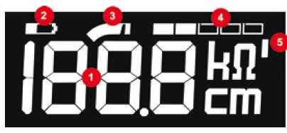

Respiod-5 ÏÔʾÆÁ
• Resipod-5 µÄÏÔʾÆÁÔÚÏÖ³¡²É¼¯Êý¾Ýʱ»áÏÔʾËùÓбØÒªÐÅÏ¢¡£
1. ÒѲâÁ¿µÄµç×èÂÊ
2. µç³Ø×´Ì¬
3. ·¶Î§Ö¸Ê¾
4. µçÁ÷ָʾ  ; 20%, 40%, 60%, 80%, 100%
5. °´¿Ì¶È¶ÁÊýָʾ£¬Á¬½Ó״̬½Ï²îָʾ
ÒÇÆ÷Óë»ìÄýÍÁ±íÃæÖ®¼äÁ¬½ÓÁ¼ºÃÊÇ»ñÈ¡¿É¿¿µÄ²âÁ¿×îÖØÒªµÄÒòËØ¡£Resipod ×Ô¶¯¼ì²â½Ï²îÁ¬½Ó²¢ÌáÐÑÓû§¡£
¡°¿ªÂ·¡±Ö¸Ê¾ÎÞ½Ó´¥ÄÚ²¿Ì½Í·ÒçÁ÷

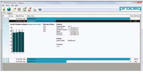

Respiod-5 Link Èí¼þ
