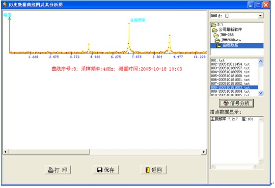

ÐźŷÖÎöͼ

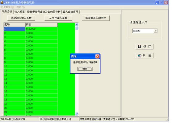

                              Êý¾Ý´«Êä·ÖÎöͼ
