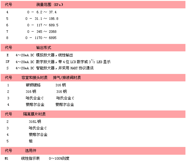

¡¡²âÁ¿¾«¶È£ºµ÷УÁ¿³ÌµÄ¡À0.2%£¬¡À0.25%£¬¡À0.5%
¡¡£¨±êÅ侫¶ÈΪ¡À0.5%£¬ÈôÑ¡ÔñÆäËû¾«¶ÈÇëÔÚ¶©»õÑ¡ÐÍʱעÃ÷¡££©

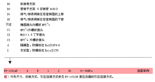

·À±¬ÀàÐÍ£º¸ô±¬ÐÍ Exd II BT4-6
·À±¬ÀàÐÍ£º±¾°²ÐÍ Exia II CT5
