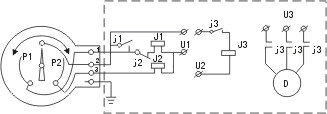

    ÒDZíÓɸô±¬Íâ¿Ç¡¢²âÁ¿ÏµÍ³¡¢µç½Óµã×é¡¢µ÷½Ú×°ÖúͳöÏߺеÈ×é³É¡£
    ÒDZíµÄ¸ô±¬Íâ¿Ç¾ßÓÐÁ¼ºÃµÄ¸ô±¬ÐÔÄÜ£¬Òò´Ë¶ÔÔÚÕý³£¹¤×÷¹ý³ÌÖÐÓÉÓڻ𻨻òµç»¡µÄÓ°Ï죬³ýÁËÄܳÐÊÜ¿ÇÌåÄÚ²¿µÄ±¬Õ¨ÐÔÆøÌå»ìºÏÎïÔÚÒ»µ©ÒýÆð±¬Õ¨Ê±²úÉúµÄ±¬Õ¨Ñ¹Á¦Í⣬²¢ÄÜÓÐЧµØ×èÖ¹Óɴ˲úÉúµÄÈÈÄÜÏòÍâ˳Àû´«²¥£¬¶øÖ»ÄÜÔÚ¿ÇÌåÄÚ²¿ÑØ×Ÿô±¬½ÓºÏÃæµÄ΢С·ì϶´¦»ºÂýµØÏòÍâÀ©É¢¡£Õâʱ£¬´«ÖÁ¿ÇÌåÍⲿµÄ˲¼äζÈÒѽµµÍµ½±¬Õ¨ÐÔÆøÌå»ìºÏÎïµÄȼµãζÈÒÔÏ£¬¹Ê²»»áµ¼Ö´«±¬¡£
    ÒDZíµÄ¹¤×÷Ô­ÀíÊÇ»ùÓÚ¼ì²âÔª¼þ£¨²âÁ¿ÏµÍ³Öеĵ¯»É¹Ü£©µÄµ¯ÐÔ±äÐΣ¬Í¨¹ý»úе´«¶¯Ê¹Ö®´ø¶¯µç½Óµã×éÖеĴ¥Í·²úÉúÏàÓ¦µÄ¶¯×÷£¨±ÕºÏ»ò¶Ï¿ª£©ÒÔʹ¿ØÑ¹ÏµÍ³Öеĵç·µÃÒÔ½Óͨ»ò¶Ï¿ª£¬´Ó¶øÊµÏÖ×Ô¶¯¿ØÖƱ¨¾¯ºÍÏÖ³¡Ö¸Ê¾µÄÄ¿µÄ¡£
µçÆøµç·Á¬½ÓʾÒâͼ
