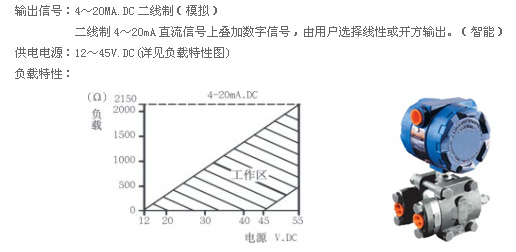

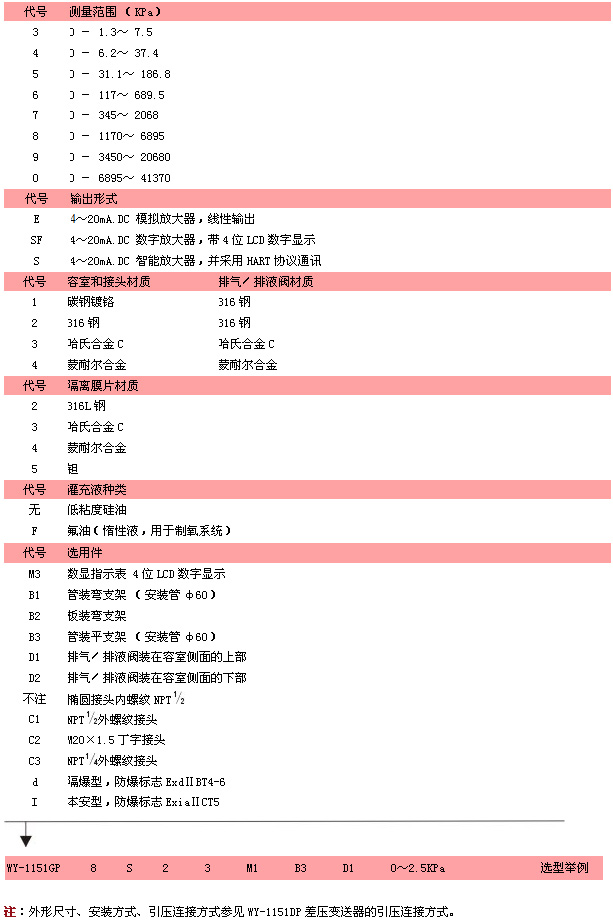

     WY-1151GPÐÍѹÁ¦±äËÍÆ÷Ö÷ÒªÓÃÓÚ²âÁ¿ÆøÌå¡¢ÒºÌåºÍÕôÆûµÄѹÁ¦¡¢¸ºÑ¹Á¦µÈ²ÎÊý£¬È»ºó½«Æäת»»³É4¡«20mA.DCÐźÅÊä³ö¡£GpÐÍѹÁ¦±äËÍÆ÷µÄ¦ÄÊÒ£¬Ò»²à½ÓÊܱ»²âѹÁ¦ÐźÅ,ÁíÒ»²àÔòÓë´óÆøÑ¹Á¦¹áͨ,Òò´Ë¿ÉÓÃÓÚ²âÁ¿±íѹÁ¦»ò¸ºÑ¹¡£
ͨÓü¼ÊõÐÔÄܺͲÎÊý
Á¿ ³Ì ±È£º10£º1»ò100±È1
µçÔ´Ó°Ï죺<0.005%Êä³öÁ¿³Ì/V
¸ºÔØÓ°Ï죺µçÔ´Îȶ¨Ê±£¬ÎÞ¸ºÔØÓ°Ïì¡£
²âÁ¿¾«¶È£ºµ÷УÁ¿³ÌµÄ¡À0.1%£¬¡À0.2%£¨±êÅ侫¶ÈΪ¡À0.2%£¬ÈôÑ¡ÔñÆäËû¾«¶ÈÇëÔÚ¶©»õÑ¡ÐÍʱעÃ÷¡££©
×è Ä᣺ͨ³£¿ÉÔÚ0.1ÖÁ16ÃëÖ®¼ä¿Éµ÷¡£
Æô¶¯Ê±¼ä£º<2Ã룬²»ÐèÔ¤ÈÈ
¹¤×÷»·¾³£º»·¾³ÎÂ¶È -29¡«93¡æ£¨Ä£Äâ·Å´óÆ÷£©
¹¤×÷»·¾³£º»·¾³ÎÂ¶È -29¡«75¡æ£¨Êý×Ö/ÖÇÄÜ·Å´óÆ÷£©
¹¤×÷»·¾³£º»·¾³ÎÂ¶È -29¡«65¡æ£¨´øÏÔʾ±íÍ·£©
¹¤×÷»·¾³£º»·¾³Êª¶È 0¡«95%
·À»¤ÌØÐÔ£º·À»¤ÄÜÁ¦ IP65
·À±¬ÀàÐÍ£º¸ô±¬ÐÍ Exd II BT4-6
¹¤×÷»·¾³£º±¾°²ÐÍ Exia II CT5
¾²Ñ¹Ó°Ï죺ÁãλÎó²î£º¡À0.5%×î´óÁ¿³ÌÏÞÖµ£¬¶ÔÓÚ32MPaÔڹܵÀѹÁ¦ÏÂͨ¹ýµ÷Áã¸øÓèУÕý¡£
µç´Å·øÉäÓ°Ï죺0.05%×î´óÁ¿³ÌÖµ£¬½ÓÊÜ·øÉ䯵ÂÊ27¡«500MHz£¬ÊÔÑ鳡ǿ3V/m¡£
ָʾ±í(%)£ºÒº¾§ÊýÏÔ ¾«¶È¡À0.2%
Õñ¶¯Ó°Ï죺Èκη½Ïò200HzÕñ¶¯Ê±£¬¡À0.05%/g¡£
°²×°Î»ÖãºÄ¤Æ¬Î´´¹Ö±°²×°£¬¿ÉÄܲúÉúСÓÚ0.24KPaµÄÁãµãÎó²î£¬µ«¿Éͨ¹ýµ÷ÁãÀ´ÐÞÕý¡£
