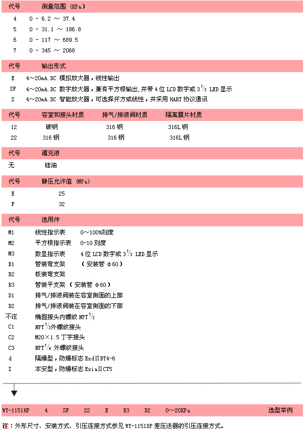

ÐÍ ºÅ£º WY-1151HP
Æ· ÅÆ£º 7280
ÓÃ;
    WY-1151HPÐ͸߾²Ñ¹²îѹ±äËÍÆ÷ÊÇÒ»ÖÖÊÊÓÃÓÚʯ»¯ºÍµçÕ¾¸ßѹװÖõIJîѹ±äËÍÆ÷£¬ÓÉÓÚÆäÄÍѹ¸ß´ï32MPa£¬²¢¿É³ÐÊܵ¥Ïò¹ýÔØÑ¹Á¦¶ø²»±»Ëð»µ,Òò´ËÄܿɿ¿µØÓÃÓÚ¸ßѹϵͳµÄ²îѹ²âÁ¿¡£
ͨÓü¼ÊõÐÔÄܺͲÎÊý
    Êä³öÐźţº4¡«20MA.DC¶þÏßÖÆ£¨Ä£Ä⣩
    ¶þÏßÖÆ4¡«20mAÖ±Á÷ÐźÅÉϵþ¼ÓÊý×ÖÐźţ¬ÓÉÓû§Ñ¡ÔñÏßÐÔ»ò¿ª·½Êä³ö¡££¨ÖÇÄÜ£©
    ¹©µçµçÔ´£º12¡«45V.DC(Ïê¼û¸ºÔØÌØÐÔͼ)
¸ºÔØÌØÐÔ£º
µçÔ´Ó°Ï죺<0.005%/V
¸ºÔØÓ°Ï죺µçÔ´Îȶ¨Ê±£¬ÎÞ¸ºÔØÓ°Ïì¡£
²âÁ¿¾«¶È£ºµ÷УÁ¿³ÌµÄ¡À0.2%£¬¡À0.25%£¬¡À0.5%
²âÁ¿¾«¶È£º£¨±êÅ侫¶ÈΪ¡À0.5%£¬ÈôÑ¡ÔñÆäËû¾«¶ÈÇëÔÚ¶©»õÑ¡ÐÍʱעÃ÷¡££©
Ç¨ÒÆÌØÐÔ£º×î´óÕýÇ¨ÒÆÁ¿500%
²âÁ¿¾«¶È£º×î´ó¸ºÇ¨ÒÆÁ¿600%
×¢£º¢Ù ¸ºÇ¨ÒÆÁ¿µÄ¾ø¶ÔÖµ£¬²»´óÓÚÒ»¸ö¹¤³Ì´óÆøÑ¹¡£
×¢£º¢Ú Ç¨ÒÆºóµÄÉÏÏÞ»òÏÂÏÞ¾ø¶ÔÖµ£¬¾ù²»Ó¦³¬¹ý×î´ó²âÁ¿·¶Î§µÄÉÏÏÞÖµ¡£
×¢£º¢Û ²îѹÁ÷Á¿±äËÍÆ÷Ç¨ÒÆ»áÆÆ»µ¿ª·½ÌØÐÔ£¬¹Ê²»ÄܽøÐÐÇ¨ÒÆ¡£
×¢£º¢Ü ¾ø¶ÔѹÁ¦±äËÍÆ÷²»ÄܽøÐиºÇ¨ÒÆ¡£
×è Ä᣺ͨ³£¿ÉÔÚ0.2¡«1.67ÃëÖ®¼ä¿Éµ÷£¬µ±¹à³ä¶èÐÔÒº»ò´øÔ¶´«×°ÖÃʱ£¬Ê±¼ä³£Êý»áÔö´ó¡£
Æô¶¯Ê±¼ä£º<2Ã룬²»ÐèÔ¤ÈÈ
¹¤×÷»·¾³£º»·¾³ÎÂ¶È -29¡«93¡æ£¨Ä£Äâ·Å´óÆ÷£©
¹¤×÷»·¾³£º»·¾³ÎÂ¶È -29¡«75¡æ£¨Êý×Ö/ÖÇÄÜ·Å´óÆ÷£©
¹¤×÷»·¾³£º»·¾³Î¶Ƞ -29¡«65¡æ£¨´øÏÔʾ±íÍ·£©
¹¤×÷»·¾³£º»·¾³Êª¶È 0¡«95%
·À»¤ÌØÐÔ£º·À»¤ÄÜÁ¦ IP65
·À±¬ÀàÐÍ£º¸ô±¬ÐÍ Exd II BT4-6
·À±¬ÀàÐÍ£º±¾°²ÐÍ Exia II CT5
¾²Ñ¹Ó°Ï죺ÁãλÎó²î£º¡À0.5%×î´óÁ¿³ÌÏÞÖµ£¬¶ÔÓÚ32MPaÔڹܵÀѹÁ¦ÏÂͨ¹ýµ÷Áã¸øÓèУÕý¡£
µç´Å·øÉäÓ°Ï죺0.05%×î´óÁ¿³ÌÖµ£¬½ÓÊÜ·øÉ䯵ÂÊ27¡«500MHz£¬ÊÔÑ鳡ǿ3V/m¡£
ָʾ±í(%)£ºµçÁ÷±í ±ê³ß³¤44.5mm ¾«¶È¡À2%
ָʾ±í(%)£ºÒº¾§ÊýÏÔ               ¾«¶È¡À0.2%
Õñ¶¯Ó°Ï죺Èκη½Ïò200HzÕñ¶¯Ê±£¬¡À0.05%/g¡£
°²×°Î»ÖãºÄ¤Æ¬Î´´¹Ö±°²×°£¬¿ÉÄܲúÉúСÓÚ0.24KPaµÄÁãµãÎó²î£¬µ«¿Éͨ¹ýµ÷ÁãÀ´Ïû³ý¡£
ÖØ Á¿£º5.4Kg£¨²»°üÀ¨¸½¼þ£©
