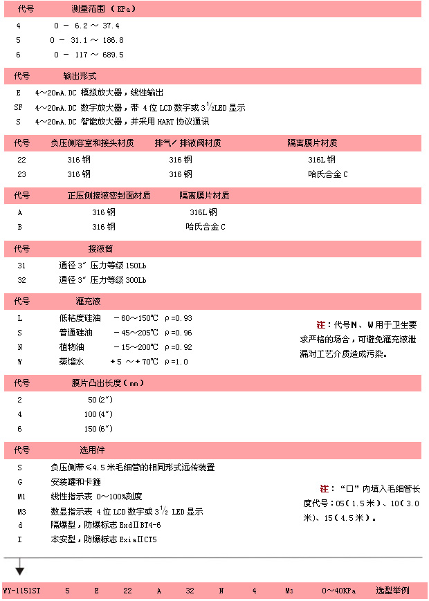

ÐÍ ºÅ£º WY-1151ST
Æ· ÅÆ£º 7280
ÓÃ;
    WY-1151STÐÍÎÀÉúÐÍҺλ±äËÍÆ÷ÊÇÒ»ÖÖÖ±½Ó°²×°ÔڹܵÀ»òÈÝÆ÷ÉϵÄÏÖ³¡±äËÍÆ÷¡£ÓÉÓÚ¸ôÀëĤƬֱ½ÓÓëÒºÌå½éÖÊÏà½Ó´¥£¬ÎÞÐ뽫Õýѹ²àÓõ¼Ñ¹¹ÜÒý³ö£¬Òò´Ë¿ÉÒÔ²âÁ¿¸ßΡ¢¸ßÕ³¶È¡¢Ò׽ᾧ¡¢Ò׳ÁµíºÍÇ¿¸¯Ê´µÈ½éÖʵÄҺλ¡¢Ñ¹Á¦ºÍÃܶȣ¬È»ºó½«Æäת»»³É4¡«20mA.DCÐźÅÊä³ö¡£STÐÍÎÀÉúʽҺλ±äËÍÆ÷²ÉÓÿ¨¹¿µÄÐÎʽ£¬½øÐпìËÙÁª½Ó£¬ËüÓë½éÖʽӴ¥µÄ±íÃæ£¬¾­¹ý¾«Ï¸¼Ó¹¤ºÍ´¦Àí£¬¹â½à¶ÈºÍÇå½à¶È½Ô·ûºÏÎÀÉú±ê×¼£¬ÄÚ²¿µÄ¹à³äÒºÊÇÒÔ²»ÎÛȾ½éÖÊΪ±ê×¼£¬Ñ¡È¡ºÍ×¢ÈëµÄ£¬Òò´Ë¿ÉÒԹ㷺µØÓ¦ÓÃÓÚʳƷ¡¢ÒûÁϺÍÒ½Ò©µÈ¹¤Òµ²¿ÃÅ¡£

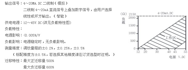

ͨÓü¼ÊõÐÔÄܺͲÎÊý
×¢£º¢Ù ¸ºÇ¨ÒÆÁ¿µÄ¾ø¶ÔÖµ£¬²»´óÓÚÒ»¸ö¹¤³Ì´óÆøÑ¹¡£
×¢£º¢Ú Ç¨ÒÆºóµÄÉÏÏÞ»òÏÂÏÞ¾ø¶ÔÖµ£¬¾ù²»Ó¦³¬¹ý×î´ó²âÁ¿·¶Î§µÄÉÏÏÞÖµ¡£
×¢£º¢Û ²îѹÁ÷Á¿±äËÍÆ÷Ç¨ÒÆ»áÆÆ»µ¿ª·½ÌØÐÔ£¬¹Ê²»ÄܽøÐÐÇ¨ÒÆ¡£
×¢£º¢Ü ¾ø¶ÔѹÁ¦±äËÍÆ÷²»ÄܽøÐиºÇ¨ÒÆ¡££¨±êÅ侫¶ÈΪ¡À0.2%£¬ÈôÑ¡ÔñÆäËû¾«¶ÈÇëÔÚ¶©»õÑ¡ÐÍʱעÃ÷¡££©
×è Ä᣺ͨ³£¿ÉÔÚ0.2¡«1.67ÃëÖ®¼ä¿Éµ÷£¬µ±¹à³ä¶èÐÔÒº»ò´øÔ¶´«×°ÖÃʱ£¬Ê±¼ä³£Êý»áÔö´ó¡£
Æô¶¯Ê±¼ä£º<2Ã룬²»ÐèÔ¤ÈÈ
¹¤×÷»·¾³£º»·¾³ÎÂ¶È -29¡«93¡æ£¨Ä£Äâ·Å´óÆ÷£©
¹¤×÷»·¾³£º»·¾³ÎÂ¶È -29¡«75¡æ£¨Êý×Ö/ÖÇÄÜ·Å´óÆ÷£©
¹¤×÷»·¾³£º»·¾³ÎÂ¶È -29¡«65¡æ£¨´øÏÔʾ±íÍ·£©
¹¤×÷»·¾³£º»·¾³Êª¶È 0¡«95%
·À»¤ÌØÐÔ£º·À»¤ÄÜÁ¦ IP65
·À±¬ÀàÐÍ£º¸ô±¬ÐÍ Exd II BT4-6
·À±¬ÀàÐÍ£º±¾°²ÐÍ Exia II CT5
¾²Ñ¹Ó°Ï죺DPÀàÁãλÎó²î£º¶ÔÓÚ14MPa£¬¡À0.1%×î´óÁ¿³ÌÏÞÖµ»ò¡À0.25%×î´óÁ¿³ÌÏÞÖµ£¨Á¿³Ì´úºÅΪ3£©£¬ÔڹܵÀ
·À±¬ÀàÐÍ£ºÑ¹Á¦ÏÂͨ¹ýµ÷Áã¸øÓèУÕý¡£
HPÀàÁãλÎó²î£º¡À0.5%×î´óÁ¿³ÌÏÞÖµ£¬¶ÔÓÚ32MPaÔڹܵÀѹÁ¦ÏÂͨ¹ýµ÷Áã¸øÓèУÕý¡£
µç´Å·øÉäÓ°Ï죺0.05%×î´óÁ¿³ÌÖµ£¬½ÓÊÜ·øÉ䯵ÂÊ27¡«500MHz£¬ÊÔÑ鳡ǿ3V/m¡£
ָʾ±í(%)£ºµçÁ÷±í ±ê³ß³¤44.5mm ¾«¶È¡À2%
ָʾ±í(%)£ºÒº¾§ÊýÏÔ                  ¾«¶È¡À0.2%
Õñ¶¯Ó°Ï죺Èκη½Ïò200HzÕñ¶¯Ê±£¬¡À0.05%/g¡£
°²×°Î»ÖãºÄ¤Æ¬Î´´¹Ö±°²×°£¬¿ÉÄܲúÉúСÓÚ0.24KPaµÄÁãµãÎó²î£¬µ«¿Éͨ¹ýµ÷ÁãÀ´Ïû³ý¡£

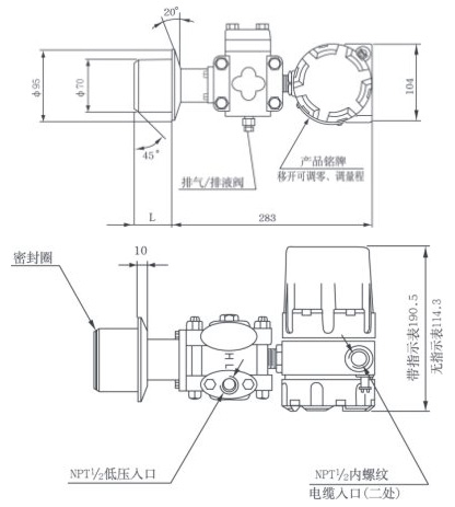

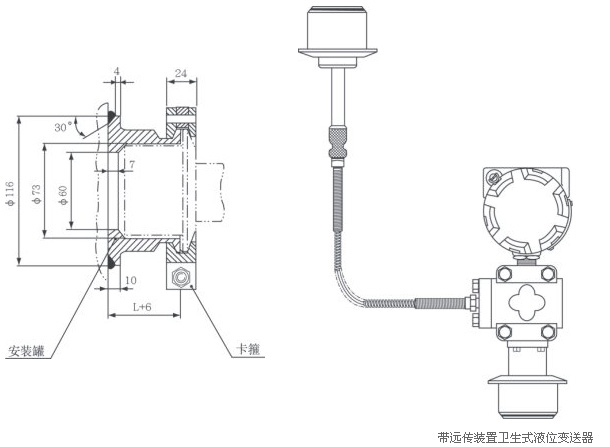

µäÐͲúÆ·ÍâÐγߴç
WY-1151STÐÍÎÀÉúʽҺλ±äËÍÆ÷
