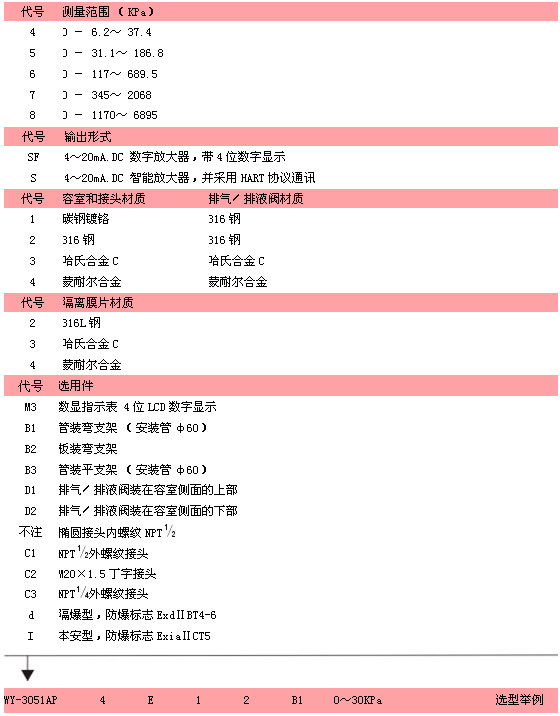

    WY-3051APÐ;ø¶ÔѹÁ¦±äËÍÆ÷µÄ¦ÄÊÒ£¨¼ûÏÂͼ£©Ò»²à½ÓÊܱ»²â¾ø¶ÔѹÁ¦Ðźţ¬ÁíÒ»²à±»·â±Õ³É¸ßÕæ¿Õ»ù×¼ÊÒ£¬È»ºó½«Æäת»»³É4¡«20mA.DCÐźÅÊä³ö¡£Ëü¿ÉÒÔ²âÁ¿³ýÆøÏµÍ³¡¢ÕôÁóËþ¡¢Õô·¢Æ÷ºÍ½á¾§Æ÷µÈµÄ¾ø¶ÔѹÁ¦¡£
    Í¨Óü¼ÊõÐÔÄܺͲÎÊý Êä³öÐźţº4¡«20MA.DC¶þÏßÖÆ£¨Ä£Ä⣩
    ¶þÏßÖÆ4¡«20mAÖ±Á÷ÐźÅÉϵþ¼ÓÊý×ÖÐźţ¬ÓÉÓû§Ñ¡ÔñÏßÐÔ»ò¿ª·½Êä³ö¡££¨ÖÇÄÜ£©
    ¹©µçµçÔ´£º12¡«45V.DC(Ïê¼û¸ºÔØÌØÐÔͼ)
¸ºÔØÌØÐÔ£º
    µçÔ´Ó°Ï죺<0.005%Êä³öÁ¿³Ì/V
    ¸ºÔØÓ°Ï죺µçÔ´Îȶ¨Ê±£¬ÎÞ¸ºÔØÓ°Ïì¡£
    ²âÁ¿¾«¶È£ºµ÷УÁ¿³ÌµÄ¡À0.1%£¬¡À0.2% £¨±êÅ侫¶ÈΪ¡À0.2%£¬ÈôÑ¡ÔñÆäËû¾«¶ÈÇëÔÚ¶©»õÑ¡ÐÍʱעÃ÷¡££©
    Á¿ ³Ì ±È£º1£º100»ò1£º10
    ×è Ä᣺ͨ³£¿ÉÔÚ0.1ÖÁ16ÃëÖ®¼äÈÎÒâ¿Éµ÷¡£
    Æô¶¯Ê±¼ä£º<2Ã룬²»ÐèÔ¤ÈÈ
    ¹¤×÷»·¾³£º»·¾³ÎÂ¶È -29¡«93¡æ£¨Ä£Äâ·Å´óÆ÷£©
    ¹¤×÷»·¾³£º»·¾³ÎÂ¶È -29¡«75¡æ£¨Êý×Ö/ÖÇÄÜ·Å´óÆ÷£©
    ¹¤×÷»·¾³£º»·¾³ÎÂ¶È -29¡«65¡æ£¨´øÏÔʾ±íÍ·£©
»·¾³Êª¶È 0¡«95%
    ·À»¤ÌØÐÔ£º·À»¤ÄÜÁ¦ IP65
    ·À±¬ÀàÐÍ£º¸ô±¬ÐÍ Exd II BT4-6
    ±¾°²ÐÍ Exia II CT5
    ¾²Ñ¹Ó°Ï죺ÁãλÎó²î£º¡À0.5%×î´óÁ¿³ÌÏÞÖµ£¬¶ÔÓÚ32MPaÔڹܵÀѹÁ¦ÏÂͨ¹ýµ÷Áã¸øÓèУÕý¡£
    µç´Å·øÉäÓ°Ï죺0.05%×î´óÁ¿³ÌÖµ£¬½ÓÊÜ·øÉ䯵ÂÊ27¡«500MHz£¬ÊÔÑ鳡ǿ3V/m¡£
    Ö¸Ê¾±í(%)£ºÒº¾§ÊýÏÔ ¾«¶È¡À0.2%
    Õñ¶¯Ó°Ï죺Èκη½Ïò200HzÕñ¶¯Ê±£¬¡À0.05%/g¡£
    °²×°Î»ÖãºÄ¤Æ¬Î´´¹Ö±°²×°£¬¿ÉÄܲúÉúСÓÚ0.24KPaµÄÁãµãÎó²î£¬µ«¿Éͨ¹ýµ÷ÁãÀ´ÐÞÕý¡£
    ÖØ Á¿£º3.9Kg£¨²»°üÀ¨¸½¼þ£©
×¢£ºÍâÐγߴ硢°²×°·½Ê½¡¢ÒýѹÁ¬½Ó·½Ê½²Î¼ûWY-3051DP²îѹ±äËÍÆ÷µÄÒýѹÁ¬½Ó·½Ê½¡£
