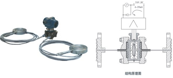

    WY-3051DPÔ¶´«²îѹ±äËÍÆ÷ÊÇÒ»ÖÖͨ¹ý°²×°ÔڹܵÀ»òÈÝÆ÷ÉϵÄÔ¶´«×°ÖÃÀ´¸ÐÊܱ»²âѹÁ¦£¬¸ÃѹÁ¦¾­Ã«Ï¸¹ÜÄڵĹà³ä¹èÓÍ£¨»òÆäËüµÄÒºÌ壩´«µÝÖÁ±äËÍÆ÷µÄÖ÷Ì壬ȻºóÓɱäËÍÆ÷Ö÷ÌåÄڵĦÄÊҺͷŴóÏß·°å£¬½«Ñ¹Á¦»ò²îѹת»»4¡«20mA.DCÐźÅÊä³ö£¨²Î¼û½á¹¹Ô­Àíͼ£©¡£
    WY-3051DP²îѹ±äËÍÆ÷ÓëÖÇÄÜ·Å´ó°å×éºÏ£¬¿É¹¹³ÉÖÇÄÜÔ¶´«Ñ¹Á¦¡¢²îѹ±äËÍÆ÷£¬Óë·ûºÏHARTЭÒéµÄÊÖ²ÙÆ÷ÅäºÏ,¿ÉÒÔÏ໥ͨѶ£¬½øÐÐÉ趨ºÍ¼à¿Ø¡£
    ÎªÁËÊÊÓ¦²»Í¬µÄ°²×°ÐèÇ󣬱¾ÏµÁбäËÍÆ÷¾ßÓжàÖÖÐÎʽµÄÔ¶´«×°Öù©Óû§Ñ¡Ôñ£¬±äËÍÆ÷µÄÖ÷Ìå½á¹¹Óë²îѹÏàͬ¡£

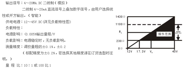

¼¼Êõ²ÎÊýºÍÐÔÄÜ
    ×è Ä᣺ͨ³£¿ÉÔÚ0.1¡«16ÃëÖ®¼ä¿Éµ÷£¬µ±¹à³ä¶èÐÔÒº»ò´øÔ¶´«×°ÖÃʱ£¬Ê±¼ä³£Êý»áÔö´ó¡£
    Æô¶¯Ê±¼ä£º<2Ã룬²»ÐèÔ¤ÈÈ
    ¹¤×÷»·¾³£º»·¾³ÎÂ¶È -29¡«93¡æ£¨Ä£Äâ·Å´óÆ÷£©
    ¹¤×÷»·¾³£º»·¾³ÎÂ¶È -29¡«75¡æ£¨Êý×Ö/ÖÇÄÜ·Å´óÆ÷£©
    ¹¤×÷»·¾³£º»·¾³ÎÂ¶È -29¡«65¡æ£¨´øÏÔʾ±íÍ·£©
    ¹¤×÷»·¾³£º»·¾³Êª¶È 0¡«95%
    ·À»¤ÌØÐÔ£º·À»¤ÄÜÁ¦ IP65
    ·À±¬ÀàÐÍ£º¸ô±¬ÐÍ Exd II BT4-6
    ·À±¬ÀàÐÍ£º±¾°²ÐÍ Exia II CT5
    ¾²Ñ¹Ó°Ï죺ÁãλÎó²î£º¡À0.5%×î´óÁ¿³ÌÏÞÖµ£¬¶ÔÓÚ32MPaÔڹܵÀѹÁ¦ÏÂͨ¹ýµ÷Áã¸øÓèУÕý¡£
    µç´Å·øÉäÓ°Ï죺0.05%×î´óÁ¿³ÌÖµ£¬½ÓÊÜ·øÉ䯵ÂÊ27¡«500MHz£¬ÊÔÑ鳡ǿ3V/m¡£
    Ö¸Ê¾±í(%)£ºÒº¾§ÊýÏÔ ¾«¶È¡À0.2%
    Õñ¶¯Ó°Ï죺Èκη½Ïò200HzÕñ¶¯Ê±£¬¡À0.05%/g¡£
    °²×°Î»ÖãºÄ¤Æ¬Î´´¹Ö±°²×°£¬¿ÉÄܲúÉúСÓÚ0.24KPaµÄÁãµãÎó²î£¬µ«¿Éͨ¹ýµ÷ÁãÀ´ÐÞÕý¡£
    ÖØ Á¿£º3.9Kg£¨²»°üÀ¨¸½¼þ£©

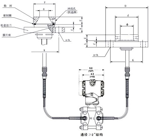

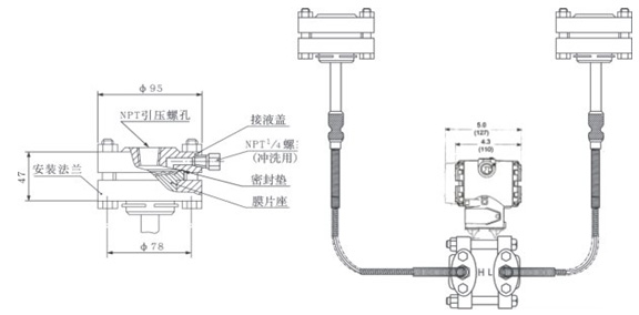

ƽ·¨À¼£¨RFW£©Ô¶´«²îѹ±äËÍÆ÷

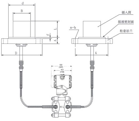

͹·¨À¼Ê½£¨EFW£©Ô¶´«²îѹ±äËÍÆ÷
±âƽʽ£¨PFW£©Ô¶´«²îѹ±äËÍÆ÷

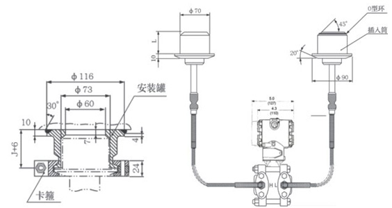

ÂÝÎÆ°²×°Ê½£¨RTW£©²îѹ±äËÍÆ÷
ÎÀÉúʽ£¨SSW£©Ô¶´«²îѹ±äËÍÆ÷

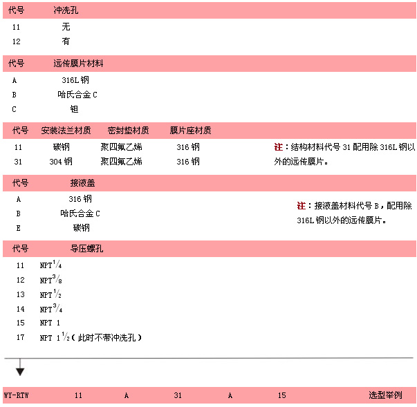

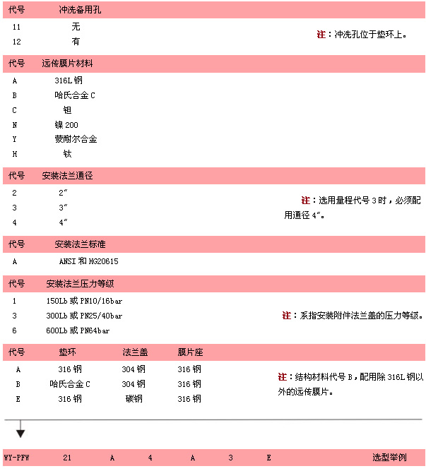

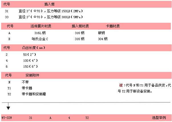

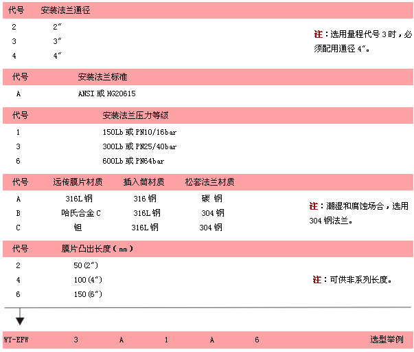

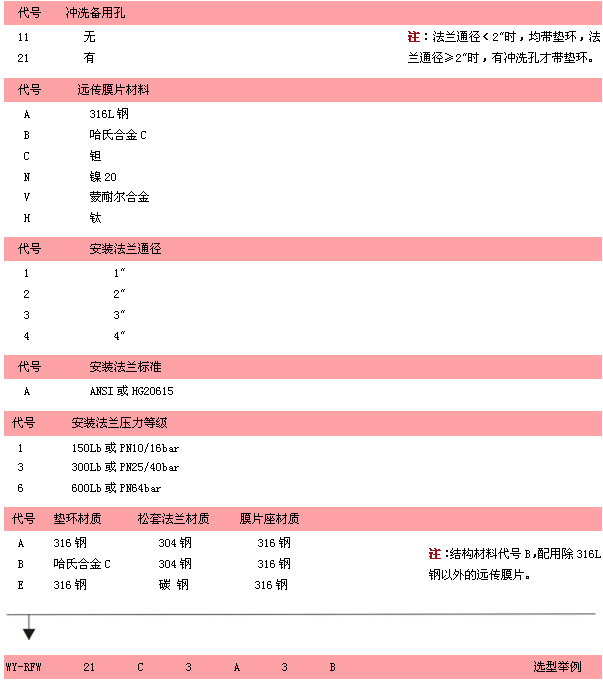

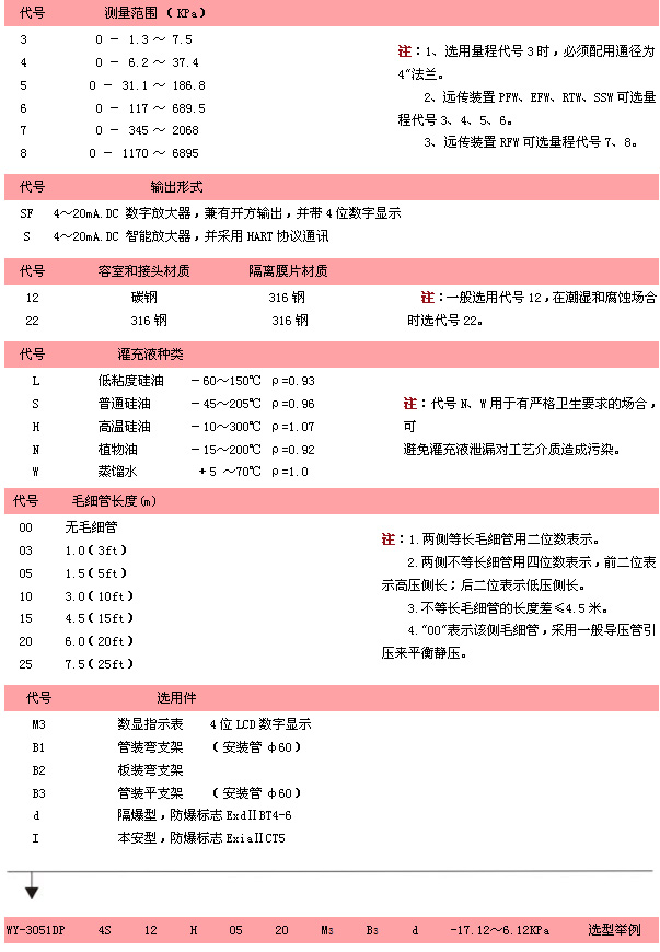

Ô¶´«²îѹ±äËÍÆ÷Ñ¡ÐÍ
¡¡Ô¶´«±äËÍÆ÷ÊÇÔÚ±äËÍÆ÷Ö÷Ìå»ù´¡Éϸ½¼ÓÔ¶´«×°ÖõıäÐͲúÆ·£¬ËùÒÔÆäÑ¡Ð͹¤×÷¿É·Ö¶þ²½½øÐУºÊ×ÏÈÈ·¶¨±äËÍÆ÷Ö÷ÌåµÄÀàÐÍ£¨DP£©¡¢²âÁ¿·¶Î§ºÍ½á¹¹²ÄÁÏ£¬È»ºó°´ÏÖ³¡µÄ°²×°ÒªÇóÈ·¶¨Ô¶´«×°ÖÃÀàÐͺͳߴ硣ÓÉÓÚ×é³É¹à³äϵͳµÄ¸÷²ÎÊý£¨Èç¹à³äÒºµÄ¹¤×÷ζȡ¢Õ³¶ÈºÍëϸ¹ÜµÄ³¤¶È£©Óë±äËÍÆ÷µÄÐÔÄÜÖ¸±êÃÜÇÐÏà¹Ø£¬Òò´Ë¹éÈë±äËÍÆ÷Ö÷ÌåÑ¡ÐÍ·¶³ë£¬²»µ¥¶ÀÁбíÑ¡Ôñ¡£
WY-3051DPÐÍÔ¶´«²îѹ±äËÍÆ÷
WY-RFWÐÍÆ½·¨À¼Ê½Ô¶´«×°ÖÃ
WY-EFWÐÍ͹·¨À¼Ê½Ô¶´«×°ÖÃ
WY-PFWÐÍ±âÆ½Ê½Ô¶´«×°ÖÃ
WY-RTWÐÍÂÝÎÆ°²×°Ê½Ô¶´«×°ÖÃ
WY-SSWÐÍÎÀÉúʽԶ´«×°ÖÃ
