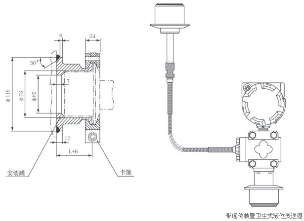

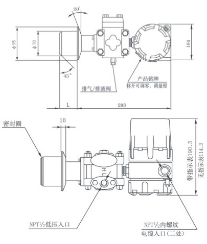

ÓÃ;
    WY-3051STÎÀÉúÐÍҺλ±äËÍÆ÷ÊÇÒ»ÖÖÖ±½Ó°²×°ÔڹܵÀ»òÈÝÆ÷ÉϵÄÏÖ³¡±äËÍÆ÷¡£ÓÉÓÚ¸ôÀëĤƬֱ½ÓÓëÒºÌå½éÖÊÏà½Ó´¥,ÎÞÐ뽫Õýѹ²àÓõ¼Ñ¹¹ÜÒý³ö£¬Òò´Ë¿ÉÒÔ²âÁ¿¸ßΡ¢¸ßÕ³¶È¡¢Ò׽ᾧ¡¢Ò׳ÁµíºÍÇ¿¸¯Ê´µÈ½éÖʵÄҺλ¡¢Ñ¹Á¦ºÍÃܶȣ¬È»ºó½«Æäת»»³É4¡«20mA.DCÐźÅÊä³ö¡£STÐÍÎÀÉúʽҺλ±äËÍÆ÷²ÉÓÿ¨¹¿µÄÐÎʽ£¬½øÐпìËÙÁª½Ó£¬ËüÓë½éÖʽӴ¥µÄ±íÃæ,¾­¹ý¾«Ï¸¼Ó¹¤ºÍ´¦Àí£¬¹â½à¶ÈºÍÇå½à¶È½Ô·ûºÏÎÀÉú±ê×¼£¬ÄÚ²¿µÄ¹à³äÒºÊÇÒÔ²»ÎÛȾ½éÖÊΪ±ê×¼£¬Ñ¡È¡ºÍ×¢ÈëµÄ£¬Òò´Ë¿ÉÒԹ㷺µØÓ¦ÓÃÓÚʳƷ¡¢ÒûÁϺÍÒ½Ò©µÈ¹¤Òµ²¿ÃÅ¡£

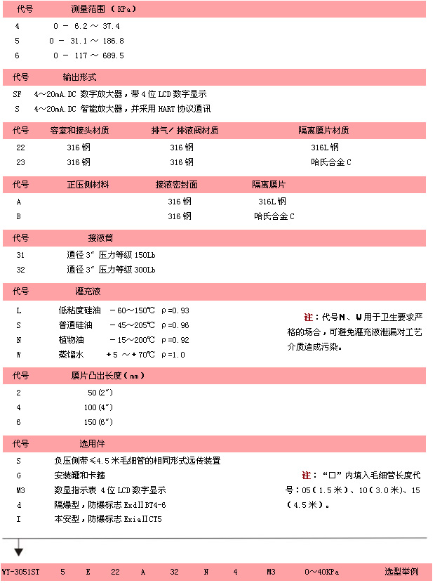

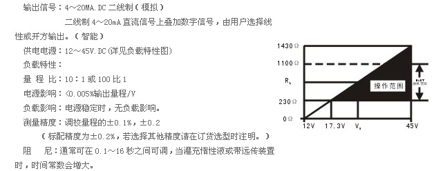

ͨÓü¼ÊõÐÔÄܺͲÎÊý
    Æô¶¯Ê±¼ä£º<2Ã룬²»ÐèÔ¤ÈÈ
    ¹¤×÷»·¾³£º»·¾³ÎÂ¶È -29¡«93¡æ£¨Ä£Äâ·Å´óÆ÷£©
    ¹¤×÷»·¾³£º»·¾³ÎÂ¶È -29¡«75¡æ£¨Êý×Ö/ÖÇÄÜ·Å´óÆ÷£©
    ¹¤×÷»·¾³£º»·¾³ÎÂ¶È -29¡«65¡æ£¨´øÏÔʾ±íÍ·£©
    ¹¤×÷»·¾³£º»·¾³Êª¶È 0¡«95%
    ·À»¤ÌØÐÔ£º·À»¤ÄÜÁ¦ IP65
    ·À±¬ÀàÐÍ£º¸ô±¬ÐÍ Exd II BT4-6
    ·À±¬ÀàÐÍ£º±¾°²ÐÍ Exia II CT5
    ¾²Ñ¹Ó°Ï죺DPÀàÁãλÎó²î£º¶ÔÓÚ14MPa£¬¡À0.1%×î´óÁ¿³ÌÏÞÖµ»ò¡À0.25%×î´óÁ¿³ÌÏÞÖµ£¨Á¿³Ì´úºÅΪ3£©£¬ÔڹܵÀѹÁ¦ÏÂͨ¹ýµ÷Áã¸øÓèУÕý¡£
    HPÀàÁãλÎó²î£º¡À0.5%×î´óÁ¿³ÌÏÞÖµ£¬¶ÔÓÚ32MPaÔڹܵÀѹÁ¦ÏÂͨ¹ýµ÷Áã¸øÓèУÕý¡£
    µç´Å·øÉäÓ°Ï죺0.05%×î´óÁ¿³ÌÖµ£¬½ÓÊÜ·øÉ䯵ÂÊ27¡«500MHz£¬ÊÔÑ鳡ǿ3V/m¡£
    Ö¸Ê¾±í(%)£ºÒº¾§ÊýÏÔ ¾«¶È¡À0.2%
    Õñ¶¯Ó°Ï죺Èκη½Ïò200HzÕñ¶¯Ê±£¬¡À0.05%/g¡£
    °²×°Î»ÖãºÄ¤Æ¬Î´´¹Ö±°²×°£¬¿ÉÄܲúÉúСÓÚ0.24KPaµÄÁãµãÎó²î£¬µ«¿Éͨ¹ýµ÷ÁãÀ´ÐÞÕý¡£
    ÖØ Á¿£º3.9Kg£¨²»°üÀ¨¸½¼þ£©
