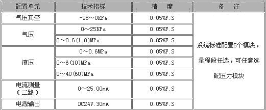

1¡¢×Ô¶¯Ôìѹϵͳ
    £ª×Ô¶¯Õæ¿ÕÔ´Ôìѹ·¶Î§£º0¡«-98KPa(±ê×¼´óÆøÑ¹Ìõ¼þÏ£©
    £ª×Ô¶¯ÆøÑ¹Ô´Ôìѹ·¶Î§£º0¡«1.0MPa
    £ª×Ô¶¯ÒºÑ¹Ô´Ôìѹ·¶Î§£º1.0¡«40¡«60MPa£¨½éÖÊΪ±äѹÆ÷ÓÍ£©
    £ªÔìѹ·½Ê½£º¹¤¿Ø¼ÆËã»ú¿ØÖÆ×Ô¶¯Ôìѹ
    £ªÎȶ¨ÐÔÖÊÖ¸±ê>0.05%F.S
    £ªÐ£ÑéÊä³ö¿Ú£ºÃ¿¸öÔìѹԴÓÐÁ½¸ö¼ì¶¨Êä³ö¿Ú£¬Á¬½Ó½Ó¿ÚΪM20×1.5±ê×¼ÂݽÊ
    £ª²Ù×÷̨ÍâÐγߴ磺1160×650×100mm£¨¹¤¿Ø»ú¡¢´òÓ¡»úµÈÁíÅä×À×Ó£©
    £ªµçÔ´ÒªÇó£ºAC220V±10% 50Hz/2.5KW¡£

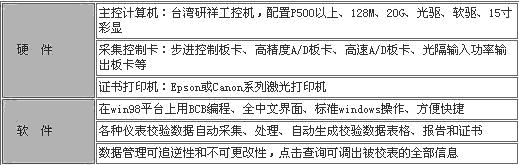

2¡¢¸ß¾«¶ÈѹÁ¦±ê׼ģ¿é¼°²âÁ¿µ¥Ôª
3¡¢¼ÆËã»úϵͳÅäÖÃ
