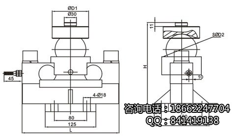

Features Ö÷ÒªÌØµã
ÇÅʽÍâÐÎ,ÓÃÓÚ´óÁ¿³ÌºÉÔØ³ÆÖØ,°²×°¸ß¶ÈµÍ,°²È«ÀιÌ.
Á¿³Ì  |  Capacities
1~100t
¼¼Êõ²ÎÊý  |  Specification
Rated Output ¶î¶¨Êä³ö 2.0mv/v¡À1%
Zero Balance Áãµãƽºâ ¡À1% of rated output
Creep After 30 Minutes Èä±ä ¡À0.03% of rated output
Nonlinearity ·ÇÏßÐÔ ¡À0.03% of rated output
Hysteresis Öͺó ¡À0.03% of rated output
Repeatability ÖØ¸´ÐÔ ¡À0.03% of rated output
Temp. effect on output ÁéÃô¶ÈÎÂÆ¯ ¡Ü0.002% of applied output/¡æ
Temp. Effect on zero ÁãµãÎÂÆ¯ ¡Ü0.002% of rated output/¡æ
Safe temp. Range ¿ÉÓÃζȷ¶Î§ -10¡æ to+70¡æ
Temp.Compensated ζȲ¹³¥·¶Î§ -10¡æ to+40¡æ
Safe Overload °²È«ÔØºÉ 150%
Input Impedance ÊäÈë×迹 387 ¦¸¡À20¦¸
Output Impedance Êä³ö×迹 350 ¦¸¡À5¦¸
Insulation Resistance ¾øÔµ×迹 ¡Ý5000M¦¸(50V DC)
Rated Excitation ÍÆ¼ö¼¤Àøµçѹ 10V DC/AC
Cable Color Code µ¼ÏßÑÕÉ« Red(+E)Black(-E)Green(+S)White(-S)
