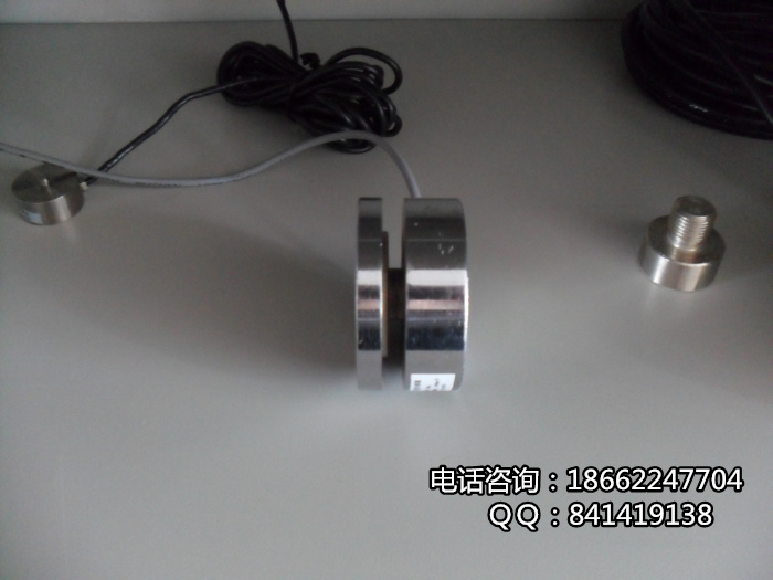

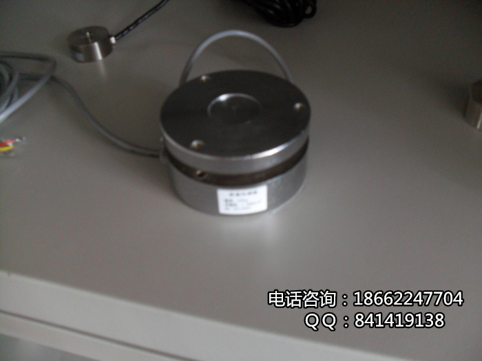

ÉÏÏÂÆ½Ãæ³ÆÖØ´«¸ÐÆ÷£¬ÂÖ·øÊ½³ÆÖØ´«¸ÐÆ÷
ÉÏ϶¼ÊÇÆ½ÃæµÄÂÖ·øÊ½³ÆÖØ´«¸ÐÆ÷¡ý
²ÉÓÃÂÖ·øÊ½½á¹¹£¬ÉÏϽÔÎªÆ½Ãæ£¬Îȶ¨ÐԸߣ¬¿¹Æ«ÔØÄÜÁ¦Ç¿¡ý

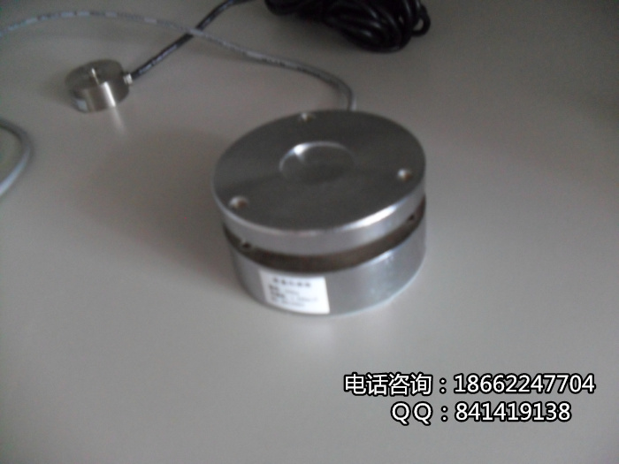

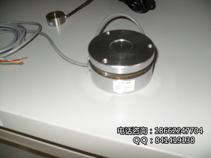

ÉÏÆ½ÃæºÍÏÂÆ½Ãæ¶¼ÓÐÈý¸ö¹Ì¶¨¿×£¬ÓÃÓڹ̶¨³ÆÖØ´«¸ÐÆ÷¡ý
½á¹¹Ð¡ÇÉ£¬°²×°·½±ã£¬³£ÓÃÔÚÖØÁ¿¼ì²â£¬Ñ¹Á¦ÊÔÑéµÈ¡ý

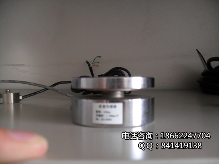

°²×°¸ß¶ÈµÍ£¬Ê¹Óüòµ¥¿ì½Ý¡ý
