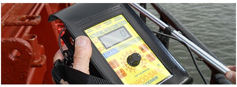

Ò». ¼ò½é
¿¨À­Ë¹¼ì²âÒÇÆ÷ÊÇÔÚÊÀ½ç¸÷µØµÄº£Ñ󴬲°²âÁ¿Ê¦µÄ×î¼ÑÑ¡Ôñ¡£Ð¹Â©µÄˮͨ¹ý²Õ¿Ú¸Ç½øÈë»õ²ÖÊÇ»õÎïË𻵵ÄÖ÷ÒªÔ­Òò¡£´¬²°ËùÓÐÕߣ¬  ¹ÜÀíÕߺͱ£ÏÕ¹«Ë¾×î¹Ø×¢µÄÊDzոǵÄË®ÃÜ£¨²»Â©Ë®£©£¬ÒòΪ²Õ¿Ú¸Ç©ˮºóË𻵻õÎÍùÍùÔì³É±£ÏÕ¹«Ë¾ºÍP£¦I¾ãÀÖ²¿±»»õÖ÷ÒªÇó´ó¶îµÄË÷Åâ¡£CARGO-SAFE´¬²°³¬Éù²¨Ð¹Â©¼ì²âÒÇÊÇABSÈϿɲտڸDzâÊÔÒÇ¡£ËüÌṩһÖÖ¿ìËÙ£¬¼ò±ãµÄ·½·¨¼ì²â²Õ¿Ú¸Ç ´¬Í·£¬´¬Î²ºÍ²àÃÅ£¬µ«²»Í¬ÓÚÈí¹Ü½½Ë®£¬²»»á¶Ô¸Û¿Ú»ò¸Û¿Ú»·¾³µÄ²úÉú¸ºÃ渱×÷Óã¬Í¬Ê±Ò²¿ÉÒÔÔÚÁã¶ÈÒÔϵÄζÈ×ÔÈçµÄ¼ì²â¡£
 ¶þ¡¢CARGO-SAFE´¬²°³¬Éù²¨Ð¹Â©¼ì²âÒÇÓ¦ÓÃ
• »õÎï²Õ¿Ú¸Ç
• ´¬Í·ºÍ´¬Î²ÃÅ
• ²ÕÃÅÃܷ⠵ȵÈ
Èý¡¢²úÆ··ûºÏÈÏÖ¤£º
  ©~º½ÔË £¨ABS£© ÀàÐ͵ÄÃÀ¹ú¾ÖÅú×¼Ö¤Êé±àºÅ LD750707
  ©~ABS ²úÆ·Éè¼ÆÆÀÉóÖ¤Êé±àºÅ 05-LD485608/1-PDA
  ©~ABS ÖÆÔìÆÀ¹ÀÖ¤ÊéºÅÂë 06-LD750707-X
  ©~ISO 9001: 2000 Ö¤Êé±àºÅ GB13487
  ©~NCAGE ºÅ U0B22
  ©~±±Ô¼ 6635-99-958-2311 4633
  ©~IIM ÆóÒµ»áÔ±±àºÅ C508
  ©~º½º£Ñ§»á»áÔ±±àºÅ CA00059
ËÄ¡¢CARGO-SAFE´¬²°³¬Éù²¨Ð¹Â©¼ì²âÒÇÌØÐÔ
ÓëÈí¹Ü½½Ë®²âÊÔ²»Í¬¡¢£¬´¬²°³¬Éù²¨Ð¹Â©¼ì²âÒÇÓŵ㣺
• ·ûºÏ»·¾³¹ÜÀí¼Æ»®µÄ¸Û¿ÚºÍ²»ÎÛȾº£Ñó»·¾³£¬
• ¿ÉÒÔÕÒµ½¿×ºÍÀáË®µÄ²ÕÃÅÃÜ·âÓ뾫¶È
• ¼ì²âʱ²»Ë𻵻õ²ÕµÄ»õÎï
• ¿ÉÒÔÔÚÁãÏÂζȽøÐмì²â
• ²»»á¸ÉÈÅÆäËû´¬Ô±µÄ»î¶¯•
Îå¡¢CARGO-SAFE´¬²°³¬Éù²¨Ð¹Â©¼ì²âÒÇÆäËûÌØÐÔ
1. Ã¿Ì×CARGO-SAFE´¬²°³¬Éù²¨Ð¹Â©¼ì²âÒÇ´øÓÐ×Ô¼ºµÄУ׼ÓëABSµÄÖ¤Êé¡£
2. ÅäÖÃÍêÕû˵Ã÷²Ù×÷Êֲᡣ
3. ¼òµ¥Ò×Ó㬿ìËÙ׼ȷ¼ì²â½á¹û¡£
4. DB £¨·Ö±´£© ÓëOHV £¨²Õ¿ÚÖµ£© µÄ°Ù·Ö±ÈÏ໥ÈÝÒ×ת»»¡£
5. ²»ÐèÒª¾­³£¶¨ÆÚÖØÐÂУ׼¡£
6. ÊÖÌáÐÐÀîÊʺÏÉÏ·É»ú¡£
7. ×îÇ¿´ó³¬Éù²¨157 dB µÄ·¢ÉäÆ÷£¬ÊÊÓÃÓÚÈκιæÄ£µÄ´¬ÉÏ¡£
8. 1 Äê±£ÐÞ½ÓÊÕÆ÷ºÍ·¢ÉäÆ÷¡£
9. IP66ÄÍÓúͷ籩µÈ¼¶
10. Ò¹¹âÏÔʾ±ãÓÚÔÚÃ÷ÁÁµÄÑô¹âÏ»òÔÚºÚ°µÖÐÔĶÁ¡£
 LED ºÍÉùÒôµÄ·¢ÉäÆ÷ÉÏµÄµç³ØµçÁ¿²»×ãʱ¾¯¸æ
CARGO-SAFE´¬²°³¬Éù²¨Ð¹Â©¼ì²âÒǼ¼Êõ²ÎÊý
CARGO-SAFE´¬²°³¬Éù²¨Ð¹Â©¼ì²âÒÇÊÇÒ»Ì×Çá±ãµÄ¼ì²âË®ÃÜÒÇÆ÷£¬±ãÓÚЯ´øºÍÔËÊ䣺
×°ÔËÖØÁ¿£º 4 ǧ¿Ë(8.8°õ)
²Ù×÷µÄÖØÁ¿£º 2.4 ǧ¿Ë(5.3°õ)
Áù¡¢·¢ÉäÆ÷
•*ÖØÁ¿:475G(1°õ)
•*³ß´ç:190x60x100mm(7.5"x3.9"2.4X")
•*Êä³öÄÜÁ¿:157DB@40KHz
•*²»Ê¹ÓÃʱ£¬Ò£¿Ø´ýÃü½ÚÊ¡µç³ØÊÙÃü
•*µçÔ´:6X AA³äµç»ò¼îÐÔµç³Ø
•*µç³ØÊÙÃü:4.5СʱÁ¬Ðø¹¤×÷
•*µÈ¼¶£ºÅ䯤Ì×ip66£¬Ã»ÓÐÆ¤Ì׵ȼ¶Ï½µ¡£
•*±³´ø
Æß¡¢½ÓÊÕÆ÷
*ÖØÁ¿:350g(12°»Ë¾)
•*³ß´ç:160x100x30mm(6.3"x3.9"x1.2")
•*µçÔ´:1x9V·üµç³Ø³äµç
•*µç³ØÊÙÃü:40СʱÁ¬Ðø¹¤×÷µÄ¼îÐÔµç³Ø
•* DBºÍOHVµÄÏ໥ת»¯
•*'ÄÚ²¿ÑïÉùÆ÷¿ÉÒÔʹÓöú»ú
•*ʹÓÃÂó¿Ë¿ÉÒÔ¼õÉÙÄÜÁ¿Ëðʧ
•*µÈ¼¶-Å䯤Ì×ip66£¬Ã»ÓÐÆ¤Ì׵ȼ¶Ï½µ¡£
•*×î´óÖµ¼Ç¼£º±£³Ö×î´ó¶ÁÊý
•*±³¹â°´Å¥¿ªÓë/¹Ø±Õ
*¾±²¿ºÍÑü±³´ø
•*Ò£¿Ø°´Å¥¿ÉÒÔ¿ØÖÆ·¢ÉäÆ÷
°Ë¡¢Ì½¸Ë
• ÖØÁ¿£º 150 g (5.3 °»Ë¾)
• ³ß´ç£º 390 ¡Á 40 ¡Á 30 ºÁÃ× £¨15.4"x 1.8"x 12")
• À©Õ¹£º 1150 ¡Á 40 ¡Á 30 ºÁÃ× (45.3"x 1.8"x 12")
• Íó´ø
¶ú»ú
• ÖØÁ¿£º 50 g £¨1.7 °»Ë¾)
• 3.5mm Á¢ÌåÉù²å¿×
• °²È«Ã±
¾Å¡¢·¢ÉäÆ÷ ̽ͷ ̽¸Ë¼ì²â
•ÖØÁ¿£º17g£¨0.6°»Ë¾£©
•³ß´ç£º46 ¡Á 31 ¡Á 20ºÁÃ×£¨1.8¡°¡Á 1.2¡±¡Á 0.8¡°£©
•ÓÃÓÚ¼ì²é·¢ÉäÆ÷£¬Ì½Í·ºÍ̽¸ËµÄÐÔÄÜ
Ê®¡¢Ì½Í·
• ÖØÁ¿£º 110 g (3.9 °»Ë¾)
• ³ß´ç£º 330 x 10 mm Ö±¾¶ (13 Ó¢´ç x 0.4 Ó¢´ç)
¡¤ Ã÷ÁÁµÄ»ÆÉ«£¬ÈÝÒ×ʶ±ð
ʮһ¡¢³äµçµç³ØºÍ³äµçÆ÷
• 12 ½Ú¿É³äµçµÄ AA µç³Ø
• 2 ½ÚPP3 9v µç³Ø
• ³äµçÆ÷Óë³µÔØÊÊÅäÆ÷
