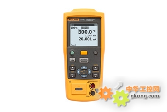

²úÆ·Ãû³Æ£º Fluke 714C ÈȵçżУ׼Æ÷
ÐÍ ºÅ£º Fluke 714C
ͨÓü¼ÊõÖ¸±ê
ÈκζË×ӺͽӵØÖ®¼ä»òÈκÎÁ½¶Ë×ÓÖ®¼äËùÊ©¼ÓµÄ×î¸ß ѹ 30 V
¹¤×÷ÎÂ¶È -10 °C ÖÁ 50 °C
´æ·ÅÎÂ¶È -30 °C ÖÁ 60 °C
¹¤×÷º£°Î 2000 Ã×
´¢´æº£°Î 12000 Ã×
Ïà¶Ôʪ¶È£¨ÎÞÀäÄýʱµÄÏà¶Ô¹¤×÷ʪ¶È£© ÎÞÀäÄý
90%£¨10 °C ÖÁ 30 °C£©
75%£¨30 °C ÖÁ 40 °C£©
45%£¨40 °C ÖÁ 50 °C£©
£¨ÎÞÀäÄý£©
Õñ¶¯ÒªÇó MIL-T-28800E£¬2 Àà
µøÂäÊÔÑéÒªÇó 1 Ã×
·À»¤µÈ¼¶ IEC 60529: IP52
µç´Å»·¾³ IEC 61326-1£º±ãЯʽ
°²È«ÐÔ IEC 61010-1£¬×î´ó 30 V ½ÓµØ£¬ÎÛȾ³Ì¶È 2
µçÔ´ 4 ½Ú 5 ºÅ NEDA 15A IEC LR6 µç³Ø
³ß´ç£¨¸ß x ¿í x ³¤£© 52.5 mm x 84 mm x 188.5 mm
ÖØÁ¿ 515 g
Ö±Á÷ mA ²âÁ¿
·Ö±æÂÊ 0 ÖÁ 24 mA
Á¿³Ì 0.001 mA
׼ȷÐÔ£¨¶ÁÊý°Ù·Ö±È + ¼ÆÊý£© 0.010% + 2 μA
ζÈϵÊý ±£¨¶ÁÊýµÄ 0.002 % + Á¿³ÌµÄ 0.002 %£©/°C£¨<18 °C »ò >28 °C£©
²âÁ¿ºÍÊä³ö£¨ºÁ·ü£©
·Ö±æÂÊ -10 mV ÖÁ 75 mV
Á¿³Ì 0.01 mV
׼ȷÐÔ£¨¶ÁÊý°Ù·Ö±È + ¼ÆÊý£© 0.015% + 10 μA
»ØÂ·µçÔ´
¿ªÂ·µçѹ 24 V ±10%
¸ºÔصç·µçѹ ×îС 18 V£¨µçÁ÷Ϊ 20 mA ʱ£©
