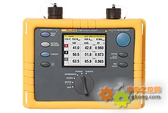

²úÆ·Ãû³Æ£º Fluke 1735 ÈýÏàµçÄܼǼÒÇ
ÐÍ ºÅ£º Fluke 1735
Æ· ÅÆ£º 80
¼¼ÊõÖ¸±ê
Ò»°ã
ÏÔʾ  ¼ VGA ͼÐΣ¬²ÊÉ«ÏÔʾÆÁ£¨ 320 x 240 ÏñËØ£©£¬Îı¾¡¢Í¼ÐζԱȶȿɵ÷
ÖÊÁ¿  ÒÀ¾ÝDIN ISO 9002¿ª·¢¡¢Éè¼Æ¡¢ÖÆÔì
´æ´¢  4 MB Flash ´æ´¢Æ÷, 3.5 MB¿ÉÓÃÓÚ²âÁ¿Êý¾ÝµÄ´æ´¢
½Ó¿Ú  RS-232 SUB-D ²å×ù; 115.2 k ²¨ÌØÂÊ, 8 ֹͣλ,ûÓÐÆæÅ¼Ð£Ñé, 1¸öֹͣλ, ͨ¹ýRS- 232½Ó¿Ú¿ÉÒÔ½øÐÐÓ²¼þÉý¼¶(10-ÕëÏßÀÂ)
²ÉÑùÂÊ  10.25 kHz
ƵÂÊ  50 Hz»ò60 Hz, Óû§¿ÉÑ¡,×Ô¶¯Í¬²½
¹©µçµçÔ´  NiMHµç³Ø°ü,ÓÐACÊÊÅäÆ÷(15 V ~20 V/0.9 A)
µç³ØÊ¹ÓÃʱ¼ä  µäÐÍ> 12 h£¬²»´ø±³¹â£¬> 7 h´ø±³¹â
³ß´ç  240 mm x 180 mm x 110 mm
ÖØÁ¿  1.7 kg, °üÀ¨µç³Ø
»·¾³
¹¤×÷ζȷ¶Î§  -10 °C to +51 °C
´¢´æÎ¶ȷ¶Î§  -20 °C to +60 °C
²Ù×÷ζȷ¶Î§  0 °C to +40 °C
²Î¿¼Î¶ȷ¶Î§  23 °C ± 2 °C
×¢Òâ  ÉÏÊöÌõ¼þ»ùÓÚÅ·±ê.ÔÚ¹¤×÷ζȵÄÈκεãÓÃζÈϵÊý¼ÆËã¹æ¸ñ
ζÈϵÊý  ± 0.1 % ²âÁ¿Öµ £¬Ã¿°C²Î¿¼Öµ
¹ÌÓÐÎó²î  ²Î¿¼Ìõ¼þÏÂ, ×î´óÎó²î£¬±£Ö¤ÆÚ2Äê
²Ù×÷Îó²î  ²Î¿¼²Ù×÷ζȷ¶Î§,×î´óÎó²î£¬±£ÖÊÆÚ2Äê
ÆøºòµÈ¼¶  C1 (IEC 654-1) -5 °C ~ +45 °C, 5% ~ 96% RH, ÎÞÄý¶
»ú¼Ü  ¾­¿¹Õð¡¢»®²ÁÈÈËÜÊÔÑ飬V1-type (²»Ò×ȼ)£¬´øÏ𽺱£»¤Íâ¿Ç
EMC
·øÉä
¸ÉÈÅ
°²È«
°²È«  IEC 61010-1 600 V CAT III,Ôöǿ˫²ã¾øÔµ£¬±£»¤µÈ¼¶3
±£»¤  IP65; EN60529 (½öÖ¸²»´øµç³ØµÄµçÔ´»ú¼Ü)
   RMS values are measured with a ÒÔ20 ms µÄ·Ö±æÂʽøÐÐÓÐЧֵµÄ²âÁ¿
V-rms wye ²âÁ¿
²âÁ¿·¶Î§
¹ÌÓÐÎó²î  ± (0.2% ²âÁ¿Öµ+ 5 ¸ö×Ö)
²Ù×÷Îó²î  ± (0.5% of m. v. + 10 ×Ö)
·Ö±æÂÊ
V-rms delta ²âÁ¿
²âÁ¿·¶Î§
¹ÌÓÐÎó²î
²Ù×÷Îó²î
·Ö±æÂÊ
A-rms ²âÁ¿
ÈáÐÔµçÁ÷̽ͷÁ¿³Ì:
µçÁ÷ǯÁ¿³Ì:
·Ö±æÂÊ
¹ÌÓÐÎó²î
²Ù×÷Îó²î
¹ÌÓÐÎó²î
²Ù×÷Îó²î
   µçÁ÷̽ͷµÄÎó²î²»°üÀ¨ÔÚÄÚ
ʹÓÃÈáÐÔ̽ͷÌ××°
ÈáÐÔ̽ͷ²âÁ¿Îó²î
λÖÃÓ°Ïì
CF (µäÐÍ):
×¢Òâ  µ±Ê¹ÓÃÈáÐÔ̽ͷÇëÈ·Èϵ¼ÏßλÖõ½ÈáÐÔÌ½Í·ËøµÄÓ°Ïì
¹¦ÂʲâÁ¿ (P - Óй¦, S - ÊÓÔÚ, Q- ÎÞ¹¦, D - »û±ä£©
²âÁ¿·¶Î§  ¼ûV rms and A rms ²âÁ¿
   »ùÓÚµçѹµçÁ÷Îó²î½øÐмÆËã
   ÓÉÓÚ¹¦ÂÊÒòÊýPFÒýÆðµÄ¸½¼ÓÎó²î
   Îó²îx (1-[PF])
   µ±×î´óµçѹÁ¿³ÌÊÇ830 V£¨delta-Á¬½Ó£©£¬µçÁ÷Á¿³ÌÊÇ3000 AÊÇ2.491 MW, ʹÓôø±ä±ÈµÄPTsºÍCTs ʱ¿ÉÄÜ»áÒÔ×î´óÏÔʾֵÏÔʾ
¹ÌÓÐÎó²î
·Ö±æÂÊ
²Ù×÷Îó²î
   µäÐ͵çѹÁ¬½Ó£¨230 V wye£©£¬µçÁ÷150 A ÊÇ34.51 KW.
¹ÌÓÐÎó²î
·Ö±æÂÊ
²Ù×÷Îó²î
   µçÁ÷´«¸ÐÆ÷µÄÎó²îδ¿¼ÂÇ
ÄÜÁ¿²âÁ¿(kWh, KVAh, kVARh)
¹ÌÓÐÎó²î
·Ö±æÂÊ
²Ù×÷Îó²î
   ÆµÂʱ仯Îó²î
PF¹¦ÂÊÒòÊý
Á¿³Ì
·Ö±æÂÊ
¾«¶È  ±1 % ÂúÁ¿³Ì
ƵÂʲâÁ¿
²âÁ¿·¶Î§
¹ÌÓÐÎó²î
²Ù×÷Îó²î
·Ö±æÂÊ
г²¨
²âÁ¿·¶Î§  µ½50th г²¨ (< 51 % ±ê³ÆÖµ)
¾«¶È
Vm ≥ 3% Vn:  ± 5% Vm
Vm < 3 % Vnom:  ±0.15% Vnom
Im ≥ 10 % Inom:  ± 5% Im
Im < 10 % Inom:  ± 0 5% Inom
THDV:  ¶ÔÓÚ THD < 3% ± 0.15%£¬Vnom
¶ÔÓÚ THD ≥ 3% ± 5%£¬Vnom
THDI:  ¶ÔÓÚ THD < 10% ± 0.5%£¬Inom
¶ÔÓÚ THD ≥ 10% ± 5%£¬Inom
   ±ê³Æµçѹ·¶Î§
   ±ê³ÆµçÁ÷·¶Î§
   Ð³²¨ m´ÎµÄVmºÍIm²âÁ¿Öµ
ʼþ
¹ÌÓÐÎó²î
²Ù×÷Îó²î
·Ö±æÂÊ  0.1 V
