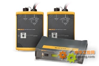

²úÆ·Ãû³Æ£º Fluke 1740 ϵÁÐÈýÏàµçÄÜÖÊÁ¿¼Ç¼ÒÇ
ÐÍ ºÅ£º Fluke 1740
Æ· ÅÆ£º 80
Ò»°ãÊý¾Ý
»ù±¾Îó²î
   Çë²éÔIJο¼Ìõ¼þ£¬ÊµÊ©Á½Äêµ£±£
±£ÐÞÆÚ
   2 Äê
У׼¼ä¸ô
   ÍƼö 2 Äê
ÖÊÁ¿Ìåϵ
   ²úÆ·µÄÑз¢¡¢Éè¼ÆºÍÖÆÔì¾ù·ûºÏ DIN ISO 9001 ±ê×¼
²Î¿¼Ìõ¼þ
   23°C ± 2K£»74°F ± 2K£¬Vm=230 V ± 10%£¬50 Hz ± 0.1 Hz »ò 60 Hz ± 0.1 Hz
Ïàλ˳Ðò:  L1£¬L2£¬L3
¼ä¸ô³¤¶È:  10 ·ÖÖÓ
Wye Á¬½Ó:  £¨L1¡¢L2¡¢L3 ÖÁ N£©
µçÔ´:  88 V ... 265 VAC
»·¾³Ìõ¼þ
¹¤×÷ζȷ¶Î§:   -10°C ÖÁ 55°C£»14°F ÖÁ 131°F
²Ù×÷ζȷ¶Î§:  -0°C ÖÁ 35°C£»32°F ÖÁ 95°F
´æ·Åζȷ¶Î§:  -20°C ÖÁ 60°C£»-4°F ÖÁ 140°F
²Î¿¼Î¶ȷ¶Î§:  23°C ± 2K£»74°F ± 2K
Ïà¶Ôʪ¶È:  Fluke 1745:B2 À࣬·ûºÏ IEC 60654-1 ±ê×¼
Fluke 1744/43:C2 À࣬·ûºÏ IEC 60654-1 ±ê×¼
¿ÇÌå
   ¼á¹ÌµÄÈ«¾øÔµ¿ÇÌåºÍ¸½¼þ
·À»¤¼¶±ð
Fluke 1745:  IP50£¬·ûºÏ EN 60529 ±ê×¼
Fluke 1744/1743:  IP65£¬·ûºÏ EN 60529 ±ê×¼
°²È«
   IEC/EN 61010-1 600 V CAT III£¬300 V CAT IV£¬2 ¼¶ÎÛȾ£¬Ë«ÖؾøÔµ
²âÊÔµçѹÀàÐÍ
   5.2 kV rms£¬50 Hz/60 Hz£¬5s
EMC
·ùÉä±ê×¼:  IEC/EN 61326-1£¬EN55022
µç´Å·À¸ÉÈÅ:  IEC/EN 61326-1
µçѹºÍµçÁ÷²âÁ¿
ÊäÈëµçѹ
ÊäÈ뷶Χ VIP-N:  ×î´ó 480 VAC
ÊäÈ뷶Χ VIP-P:  ×î´ó 830 VAC
×î´ó¹ýÔØµçѹ:  1.2 VI
ÊäÈ뷶ΧѡÔñ:  °´¹¤×÷ÖÖÀà±à³Ì
Á¬½Ó:  P-P »ò P-N£¬µ¥Ïà»òÈýÏà
¶î¶¨µçѹ VN:  <= 999 kV£¬Í¨¹ý PT ºÍ±ÈÂÊ
ÊäÈëµç×è:  Ô¼ 820 kΩ/ͨµÀ Lx-N µ¥ÏࣨL1 »ò A£¬L2 »ò B£¬L3 »ò C£¬ÒÑÁ¬½Ó£©£ºÔ¼ 300 kΩ
»ù±¾Îó²î:  VI µÄ 0.1 %
±äѹÆ÷:  ±ÈÂÊ£º<999 kV/VI
±ÈÂÊÑ¡Ôñ:  °´¹¤×÷ÖÖÀà±à³Ì
ʹÓà Flexi Set ʱµÄµçÁ÷ÊäÈë
ÊäÈ뷶Χ II L1 »ò A¡¢L2 »ò B¡¢L3 »ò C¡¢N:  15 A/150 A/1500 A/3000 A ac
Á¿³Ì:  0.75 A … 3000 A ac
»ù±¾Îó²î:  Ð¡ÓÚ II µÄ 2 %
λÖÃÓ°Ïì:  ×î´óÖµ ± ²âÁ¿ÖµµÄ 2 % £­ µ¼Ïßµ½²âÁ¿Í·µÄ¾àÀë > 30 mm
ÔÓÉ¢´Å³¡Ó°Ïì:  < ± 2 A ac (Iext=500 A ac)£¬ÇÒµ½²âÁ¿Í·µÄ¾àÀë > 200 mm
ζÈϵÊý:  < 0.05 %/K
µçÁ÷»¥¸ÐÆ÷:  ±ÈÂÊ <= 999 kA/II
Á¬½Ó:  3 Ï࣬3 Ïà +N£¬2 Ïà L1 »ò A ºÍ L3 »ò C£¨Ë«ÍßÌØ±í·¨£©7 ¼«Á¬½ÓÆ÷
ǯ±íµÄµçÁ÷ÊäÈë
ÊäÈ뷶Χ II L1 »ò A¡¢L2 »ò B¡¢L3 »ò C¡¢N:  0.5 V ¶î¶¨ (II) 1.4 Vpeak
»ù±¾Îó²î:  Ð¡ÓÚ II µÄ 0.3 %
×î´ó¹ýÔØ:  10 V ac
ÊäÈëµç×è:  Ô¼ 8.2 kΩ
µçÁ÷»¥¸ÐÆ÷:  ±ÈÂÊ Ω 999 kA/II
µçÄÜϵͳ
   Èý½ÇÐÍ£¬¶þÔªÈý½ÇÐÍ£¬Y ÐÍ£¬µ¥Ï࣬·ÖÏà
¼Ç¼ÒÇ
µçÔ´
¹¤×÷·¶Î§:  88 V ÖÁ 660 V£¨¾ø¶ÔÖµ£©£¬50 Hz/60 Hz
100 V ÖÁ 350 V dc£¬ÄÚ²¿±£ÏÕË¿: 630 mA T
¹¦ºÄ:  5 ÍßÌØ
²»¼ä¶ÏµçÔ´:  Fluke 1745:½èÖúÖÇÄܵçÔ´¹ÜÀí£¬ÄÚÖÃµç³ØÍ¨³£¿É¹©µç 5 СʱÒÔÉÏ
Fluke 1743/44:3 ÃëµçÈÝ
±£ÏÕË¿:  µçÔ´±£ÏÕ˿ֻÄÜÔÚάÐ޵صã¸ü»»¡£ µçÔ´¿ÉÒÔ²¢Áªµ½²âÁ¿ÊäÈ루×î¸ß 660 V£©
ÏÔʾÆÁ¡¢Ö¸Ê¾Æ÷
   ×´Ì¬ºÍµçѹµçƽ LED ָʾµÆ
Fluke 1745:LC ±³¹âÏÔʾÆÁ£¬ÓÃÓÚÏÔʾµçѹ¡¢µçÁ÷¡¢ÓÐЧµçÄܺÍÏàλ˳Ðò¡£
´æ´¢
   8 MB ÉÁ´æ (Flash-EPROM)
¼ä¸ô:  A º¯Êý > 12000 ¼ä¸ô£¬´æ´¢Ê±¼ä 85 ÌìÒÔÉÏ£¨10 ·ÖÖÓ¼ä¸ô£©
P º¯Êý > 30000 ¼ä¸ô£¬´æ´¢Ê±¼ä³¬¹ý 212 Ì죨10 ·ÖÖÓ¼ä¸ô£©
ʼþ:  > 13000
´æ´¢Æ÷ÀàÐÍ:  ÏßÐÔ£¬Ñ­»·
½Ó¿Ú
   RS 232¡¢9600...115 000 ²¨ÌØ£¬×Ô¶¯²¨ÌØÂÊÑ¡Ôñ£¬3 ÏßͨÐÅ
³ß´ç
Fluke 1745:  282 x 216 x 74 ºÁÃ×£¨115 x 88 x 33 Ó¢´ç£©
Fluke 1743/1744:  170 x 125 x 55 ºÁÃ×£¨69 x 51 x 22 Ó¢´ç£©
ÖØÁ¿
Fluke 1745:  Ô¼ 3 ǧ¿Ë
Fluke 1744/1743:  Ô¼ 2 ǧ¿Ë
²âÁ¿
A/D ת»»Æ÷:  16 룬²ÉÑùÂÊ: 10.24 kHz
¿¹¾â³ÝÂ˲¨Æ÷:  FIR Â˲¨Æ÷£¬fc =4.9 kHz
ƵÏì:  Îó²î < Vm µÄ 1 %£¬40 Hz ÖÁ 2500 Hz
¼ä¸ô³¤¶È:  1¡¢3¡¢5¡¢10¡¢30s£»1¡¢5¡¢10¡¢15¡¢60 ·ÖÖÓ
×îС/×î´óÖµµÄƽ¾ùʱ¼ä:  ½£¬1 ¸öµçÔ´ÖÜÆÚ£¬200ms£¬1£¬3£¬5s
ʱ»ù:  ·Ö±æÂÊ: 10 ms (50 Hz)£¬Îó²î: 2s/Ìì (23°C)£»74°F ± 2K
