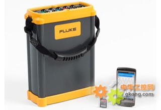

²úÆ·Ãû³Æ£º Fluke 1750 ÈýÏàµçÄܼǼÒÇ
ÐÍ ºÅ£º Fluke 1750
Æ· ÅÆ£º 80
¼¼ÊõÖ¸±ê
µçÄÜÖÊÁ¿²âÁ¿±ê×¼
·ûºÏ  IEC 61999-1-4 Class 1£¬IEC 61000-4-30 A »ò B Àࣨȡ¾öÓÚ²âÁ¿¹¦ÄÜ£©£¬IEEE519£¬IEEE1159£¬IEEE1459 ºÍ EN50160
ʱÖÓ/ÈÕÀú  ÈòÄ꣬¶þÊ®ËÄÐ¡Ê±ÖÆ
ʵʱʱÖÓ׼ȷ¶È  Ã¿ÌìÎó²î²»³¬¹ý ± 1 Ãë
ÄÚ´æÊý¾ÝÈÝÁ¿  ÖÁÉÙ 2 GB
×¼Ç¼ÖÜÆÚ  ÖÁÉÙ 31 Ìì
²âÁ¿Ê±¼ä¿ØÖÆ  ×Ô¶¯
×î´óʼþÊýÁ¿  ½öÊÜÄÚ´æ´óСµÄÏÞÖÆ
µçÔ´ÒªÇó  100 ÖÁ 240 V rms ± 10 %£¬47-63 Hz£¬40 W
¶Ïµçʱ¹¤×÷ʱ¼ä£¨ÄÚ²¿ UPS ²Ù×÷£©  5 ·ÖÖÓ/¶Ïµç£¬Ôٴγäµç¿É¹¤×÷ʱ¼ä×ܳ¤ 60 ·ÖÖÓ
³ß´ç  215 ºÁÃ× x 310 ºÁÃ× x 35 ºÁÃ×£¨8.5 Ó¢´ç x 12.2 Ó¢´ç x 3.5 Ó¢´ç£©
ÖØÁ¿  6.3 ǧ¿Ë£¨14 °õ£©
ÊäÈë
²âÁ¿ÀàÐÍ  µ¥Ïà+ÁãÏߣ¬µ¥Ïà ITÎÞÁãÏߣ¬µ¥Ïà·ÖÏ࣬ÈýÏàYÐÍ£¬ÈýÏàÈý½ÇÐÍ£¬ÈýÏà IT£¬ÈýÏà High Leg£¬ÈýÏà Open Leg£¬2 ÔªÈý½ÇÐÍ¡¢£¬21/2 ÔªYÐÍ
ÊäÈëͨµÀ  µçѹ: 4 ͨµÀ£¬½»Á÷/Ö±Á÷
   µçÁ÷: 5 ͨµÀ
µçѹͨµÀ  ÊäÈë×迹: 2 MΩ
   ÊäÈëµçÈÝ: < 2 0 pF
µçÁ÷ÊäÈëÌØÕ÷  2 V rms = Âú¶È£¬Ìú´Å CT µÄÊäÈë×迹Ϊ 1 MΩ£¬¶ÔÓÚÈáÐÔ CT ³ÊÏÖµÍ×è
²âÁ¿·½·¨  Í¬²½¶ÔµçѹºÍµçÁ÷½øÐÐÊý×Ö²ÉÑù¡£ Êý×ÖPLLÓë²ÉÑùͬ²½£¬ÔÚµçѹϵøÆÚ¼äʹÓÃÄÚ²¿ÆµÂʲο¼
ͬ²½ºÍ²ÉÑù
PLL ͬ²½Ô´  ¶ÔÓÚYÐ͵çÔ´£¬PLLͬ²½ÖÁA-Nµçѹ£»¶ÔÓÚÈý½ÇÐ͵çÔ´£¬Í¬²½ÖÁA-B¡£ ËùÓеĵçÔ´ÀàÐ;ù¿É·ÖÀàΪYÐÍ»òÈý½ÇÐÍ¡£
PLL ËøÏ෶Χ  42.5 ÖÁ 69 Hz
²ÉÑùƵÂÊ  µçѹºÍµçÁ÷: 256 ´Î²ÉÑù/ÖÜÆÚ£»·ûºÏ IEC 61000-4-7 ±ê×¼µÄ¼äг²¨: 2560µã/10ÖÜÆÚ£¨50 Hz£©£»3072µã/12ÖÜÆÚ£¨60 Hz£©£»Ë²±äµçѹ: 5 MHz
A/D ·Ö±æÂÊ  µçѹºÍµçÁ÷: 24 λ
   Ë²Ê±µçѹ: 14 λ
µçѹºÍµçÁ÷²âÁ¿
µçѹ²âÁ¿·¶Î§  ½»Á÷µçѹ: 1000 V rms ± 10 % ³¬Á¿³Ì
   Ö±Á÷µçѹ: ± 1000 V + 10 % ³¬Á¿³Ì
µçѹ·åÖµÒò×Ó  3 »ò¸üС
µçÁ÷²âÁ¿·¶Î§  ÊÓËùÓõĵçÁ÷̽ͷ¶ø¶¨
µçÁ÷·åÖµÒò×Ó  4 »ò¸üС
RMS µçѹ
²âÁ¿ÀàÐÍ  ÕæÓÐЧֵÁ¬Ðø¼ÆËã: ÿ¸öÖÜÆÚ¡¢Ã¿ 1/2 ÖÜÆÚÒÔ¼°Ã¿ 10 »ò 12 ¸öÖÜÆÚ£¬ÆµÂÊ·Ö±ðΪ 50 »ò 60 Hz£¬·ûºÏ IEC 61000-4-30 ±ê×¼µÄÒªÇó¡£
²âÁ¿Îó²î  ½»Á÷: ± 0.2 % ¶ÁÊý ± 0.1 % Âú¶È£¬´óÓÚ 50 V rms
   Ö±Á÷: ± 0.5 % ¶ÁÊý ± 0.2 % Âú¶È£¬´óÓÚ 50 V dc
RMS µçÁ÷
²âÁ¿ÀàÐÍ  ÕæÓÐЧֵÁ¬Ðø¼ÆËã: ÿ¸öÖÜÆÚ¡¢Ã¿ 1/2 ÖÜÆÚÒÔ¼°Ã¿ 10 »ò 12 ¸öÖÜÆÚ£¬ÆµÂÊ·Ö±ðΪ 50 »ò 60 Hz£¬·ûºÏ±ê×¼ÒªÇó¡£
˲±äµçѹ£¨Âö³å£©
²âÁ¿ÀàÐÍ  ²¨ÐβÉÑù
Âú¶È  8000 V pk
²ÉÑù·Ö±æÂÊ  200 nS
²âÁ¿Îó²î  ± 5 % ¶ÁÊý ± 2 0 V£¨²âÊÔ²ÎÊý: 1000 V dc£¬1000 V rms£¬100 kHz£©
µçѹÖèÉý£¨rms ÖèÉý£©
²âÁ¿ÀàÐÍ  ÕæÓÐЧֵ£¨ÒÔÒ»¸öÖÜÆÚ½øÐмÆË㣬½»µü°ë¸öÖÜÆÚ —— Ïß¼äµçѹΪ 3 Ïà 3 ÏßÖÆµÄÏßµçѹ£¬ÏàµçѹÊÇ 3 Ïà 4 ÏßÖÆµÄµçѹ£©
ÏÔʾÊý¾Ý  ÖèÉý·ù¶ÈºÍ³ÖÐøÊ±¼ä
²âÁ¿  Óë RMS µçѹÏàͬ
µçѹÖè½µ£¨RMS µøÂ䣩
ÏÔʾÊý¾Ý  Öè½µºÍ¶ÏµçµÄ·ù¶ÈºÍ³ÖÐøÊ±¼ä
²âÁ¿  Óë RMS µçѹÏàͬ
µçѹÖжÏ
²âÁ¿ÀàÐÍ  ÓëµçѹÖè½µÏàͬ
LAN ½Ó¿Ú
½ÓÍ·  RJ-45
ËٶȺÍÀàÐÍ  10/100 Base-T£¬×Ô¶¯ MDIX
ͨÐÅЭÒé  Í¨¹ýÒÔÌ«ÍøµÄ TCP/IP
ÎÞÏß¿ØÖÆÆ÷½Ó¿Ú
Á¬½Ó  ÎÞÏߣ¨2.4 GHz ÎÞÏߵ磩
ËÙ¶È  ¸ß´ï 700 Kb/Ãë
ͨÐÅЭÒé  À¶ÑÀ SPP
µçÄܲâÁ¿
µçÄÜ£¬µç³ØÊÙÃü
²âÁ¿ÀàÐÍ  ÕæÓÐЧֵÁ¬Ðø¼ÆËã: ÿ¸öÖÜÆÚÒÔ¼°Ã¿ 10 »ò 12 ¸öÖÜÆÚ£¬ÆµÂÊ·Ö±ðΪ 50 »ò 60 Hz£¬·ûºÏ±ê×¼ÒªÇó¡£
ƵÂÊ
²âÁ¿·¶Î§  42.5 ÖÁ 69 Hz
²âÁ¿Ô´  Óë PLL ͬ²½Ô´Ïàͬ
²âÁ¿×¼È·¶È  ± 10 mHz£¨10 ÖÁ 110 % Á¿³Ì£¬ÕýÏÒ²¨£©
µçÄÜÒò×Ó
²âÁ¿·¶Î§  0.000 ÖÁ 1.000
²âÁ¿×¼È·¶È  Ã¿¸ö²âÁ¿ÖµµÄ¼ÆËãÖµ ± 1 루×ÜÖµµÄ ±3 룩
Æ«ÒÆµçÄÜÒò×Ó
²âÁ¿·½·¨  Í¨¹ýµçѹ»ù²¨ºÍµçÁ÷»ù²¨Ö®¼äµÄÏàλ²î¼ÆËã»ñµÃ
²âÁ¿·¶Î§  - 1.000£¨³¬Ç°£©ÖÁ + 1.000£¨Öͺó£©
²âÁ¿×¼È·¶È  ± 0.5 % ¶ÁÊý ± 2 % Âú¶È ± 1 λ
µçѹ²»Æ½ºâºÍÏàÐò
²âÁ¿·½·¨  ÕýÐòµçѹ³ýÒÔ¸ºÐòµçѹ£¬·ûºÏ IEC 61000-4-30 ±ê×¼
г²¨µçѹºÍµçÁ÷
·ÖÎö´°¿Ú  ¾ØÐÎ
·ÖÎö˳Ðò  µÚ 1 ÖÁµÚ 50 ´Î
²âÁ¿×¼È·¶È  µçѹ/µçÁ÷: µÚ 1 ÖÁµÚ 20 ´Î: ± 0.5 % ¶ÁÊý ± 0.2 % Âú¶È£»µÚ 21 ÖÁµÚ 50 ´Î:± 1 % ¶ÁÊý ± 0.3 % Âú¶È£¨¶ÔÓÚµçÁ÷ºÍ¹¦ÂÊ£¬±ØÐ뿼ÂǵçÁ÷´«¸ÐÆ÷׼ȷ¶È)
²âÁ¿·½·¨  IEC 61000-4-7
¼äг²¨µçѹºÍµçÁ÷£¨¼äг²¨£©
·ÖÎö´°¿Ú  ¾ØÐÎ
·ÖÎö˳Ðò  µÚ 1.5 ÖÁµÚ 49.5 ´Î
ÉÁ±ä
²âÁ¿·½·¨  IEC 61000-4-15
   ¶ÔÓÚ Plt£¬2 Сʱ£»¶ÔÓÚ PSt£¬10 ·ÖÖÓ
²âÁ¿·¶Î§:  0¡¢1 ÖÁ 5 (25)£¬¾ßÌåÈ¡¾öÓÚµçѹˮƽ¡¢µ÷ÖÆºÍƵÂÊ
»·¾³Ö¸±ê
»·¾³
¹¤×÷»·¾³  ÊÒÄÚ»òÊÒÍâÕÚ¸ÇÇøÓò£¬×î´óº£°Î¸ß¶È 2000 Ã×
´æ·ÅζȺÍʪ¶È  -20 °C ÖÁ 50 °C£¬×î´ó 80 % Ïà¶Ôʪ¶È£¬ÎÞÀäÄý
¹¤×÷ζȺÍʪ¶È  0 °C ÖÁ 40 °C£¬×î´ó 80 % Ïà¶Ôʪ¶È£¬ÎÞÀäÄý
×î¸ß¶î¶¨¹¤×÷µçѹ
µçѹ¶Ë×Ó  1100 V rms
Ä͵çѹÐÔ  5550 V rms ac ³ÖÐø 1 ·ÖÖÓ£¬µçѹÊäÈë¶Ë×ÓÖ®¼ä¡¢µçѹÊäÈë¶Ë×Ӻ͵çÁ÷̽ͷ֮¼ä¡¢µçѹÊäÈë¶Ë×Ӻͻú¿ÇÖ®¼ä£¨50/60 Hz£¬1 mA ¸Ð²âµçÁ÷£©
»úÏä±£»¤  IP30£¨·ûºÏ EN 60529 ±ê×¼£©
±ê×¼£º
EMC  EN 61326-1:1997+A1:1998 Class A
   EN 61000-3-2:1995+A1:1998+A2:1998
   EN 61000-3-3:1995
°²È«  EN 61010-1 2 nd Edition; 2 000
   µçѹÊäÈëÉ豸:ÎÛȾµÈ¼¶ 2¡¢¹ýѹÀà±ð 1000 V CAT III¡¢600 V CAT IV£¨Ô¤ÆÚ¹ýѹ: 8000 V£©
