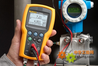

²úÆ·Ãû³Æ£º Fluke 721 ¾«ÃÜѹÁ¦Ð£×¼Æ÷
ÐÍ ºÅ£º Fluke 721
¼¼ÊõÖ¸±ê£¨1 Ä꣩
µÍѹ´«¸ÐÆ÷ Á¿³Ì ·Ö±æÂÊ ¾«¶È
-14 psi ÖÁ+16 psi£¬
-0.97 bar ÖÁ 1.1 bar
0.001 psi£¬
0.0001 bar
ÂúÁ¿³ÌµÄ 0.025 %
¸ßѹ´«¸ÐÆ÷ -12 psi ÖÁ+100 psi£¬
-0.83 bar ÖÁ 6.9 bar
0.01 psi£¬
0.0001 bar
ÂúÁ¿³ÌµÄ 0.025 %
ͨÓü¼ÊõÖ¸±ê
ÒÇÆ÷ÉèÖõ÷Óà ÉÏ´ÎͨµçʱµÄʹÓÃÉèÖÃ
ʹÓû·¾³ ²Ù×÷ÎÂ¶È -10 °C ÖÁ +50 °C
´æ·Åζȣ¨²»´øµç³Ø£© -20 °C ÖÁ +60 °C
º£°Î 2000 m
·À»¤µÈ¼¶ IP-40
µçÔ´ÒªÇó Ö±Á÷ 6.0 v
µç³ØÊ¹ÓÃʱ¼ä >35 Сʱ£¨ÓÃÓÚÖ÷ÒªÓÃ;ʱ£©
µç³ØÊý (4) ½Ú±ê×¼ 5 ºÅµç³Ø
³ß´ç£¨¸ß x ¿í x É 7.9" X 4.3" X 2.3" (20 cm X 11 cm X 5.8 cm)
ÖØÁ¿ 03539 kg (1 lb 3 oz)
Á¬½ÓÆ÷/¶Ë¿ÚѹÁ¦ Á½¸ö£¬1/8 in NPT£¬700P ϵÁÐѹÁ¦Ä£¿é£ºRTD ̽ͷ
µçÆøºÍζȲâÁ¿£¨1 Ä꣩
¹¦ÄÜ Á¿³Ì ·Ö±æÂÊ ¾«¶È
µçÁ÷²âÁ¿£¨ºÁ°²£© 0 ÖÁ 24 mA 0.001 mA ¶ÁÊý ±0.015%
±0.002mA
Ö±Á÷µçѹ²âÁ¿ 0 ÖÁ 30 V Ö±Á÷µçѹ 0.001V ¶ÁÊý ±0.015%
±0.002V
*ζȲâÁ¿ (RTD/Ohms) -40 °C ÖÁ 150 °C
£¨-40 °F ÖÁ 302 °F£©
0.01 °C, 0.01 °F ¶ÁÊý ±0.015%
±0.02 ohms
±0.1°C (±0.2°F)
±0.25 degC (±0.45
degF) ×ۺϲ»È·¶¨¶È£¨Ê¹Óà 720 RTD ̽ͷ¸½¼þʱ£©
»ØÂ·µçÔ´ 24V N/A 24 mA @ 24V
*ζȲâÁ¿ÐèҪʹÓà Fluke-720RTD Pt-100 RTD ̽ͷѡ¼þ×÷Ϊ¸½¼þ
ζÈÓ°Ïì
15 °C - 35 °C ·¶Î§ÄÚ¶ÔËùÓй¦Äܵľ«¶ÈÎÞÓ°Ïì
ζȳ¬³ö 15 °C - 35 °C ·¶Î§Ê±£¬Ìí¼Ó ± 0.002% F.S./°C
ѹÁ¦µ¥Î»
psi, bar, mbar, kPa, kgcm2, cmH 2O@4°C, cmH 2O@20°C, mH 2O@4°C, mH 2O@20°C, inH 2O@4°C, inH2O@20°C, inH 2O@60°F, mmHg@0°C, inHg@0°C, ftH 2O@4°C, ftH 2O@20°C, ftH 2O@60°F
